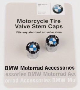

Thanks for the "Heads-Up", have just switched a steel valve stem cap complete with seal from my XJ650 to the rear wheel of the RT.
(I'm not likely to get up to 3 figures on the XJ650.)
The front wheel on the RT should be OK as the valve is on the side of a spoke & not exposed to the same centrifugal forces as the rear.
