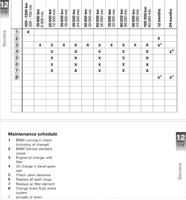

David. wrote: Tue Jul 09, 2024 10:29 am R1250GS Service.PNG
The R1250GS Service info for the air filter is not the same as the R1250RT.
It says replace the air filter every 12,000 miles.
Item number 7....
R1250RT Service info.png (128.75 KiB) Viewed 1966 times

Going to pop down the garage now and have a look. Back in 36 hours :lol: :lol: :lol: :lol:
Edit...
So i got as far as looking at the bike. Then i thought F-it that to much work just to check the air filter.

The air filter service intervals may well be every 12K miles. Two Hiflo filters can be had for less than one BMW filter.
After 6K miles, the air filter is usually fairly grubby, mine gets changed every 6K miles.
