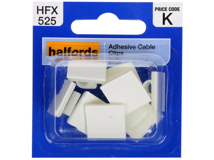

beemerboy9 wrote:You might be able to find something similar but less bulky to suit your needs.
I used some of these Halfords adhesive cable clips to secure the two core heated kit wire and controller to the tank rail.
