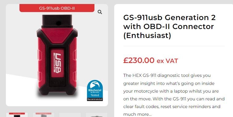

Been searching about and found this
gs 911.JPG (55.29 KiB) Viewed 1787 times
Im assuming the 1250 is OBD and not the 10 pin.....

Yes the 1250 is the obd, it’s a useful bit of kit.

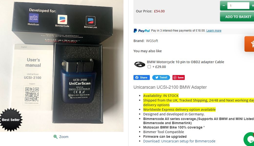

Still weighing up options, erring towards doing the service myself.. seen this scan tool, anyone used it?
