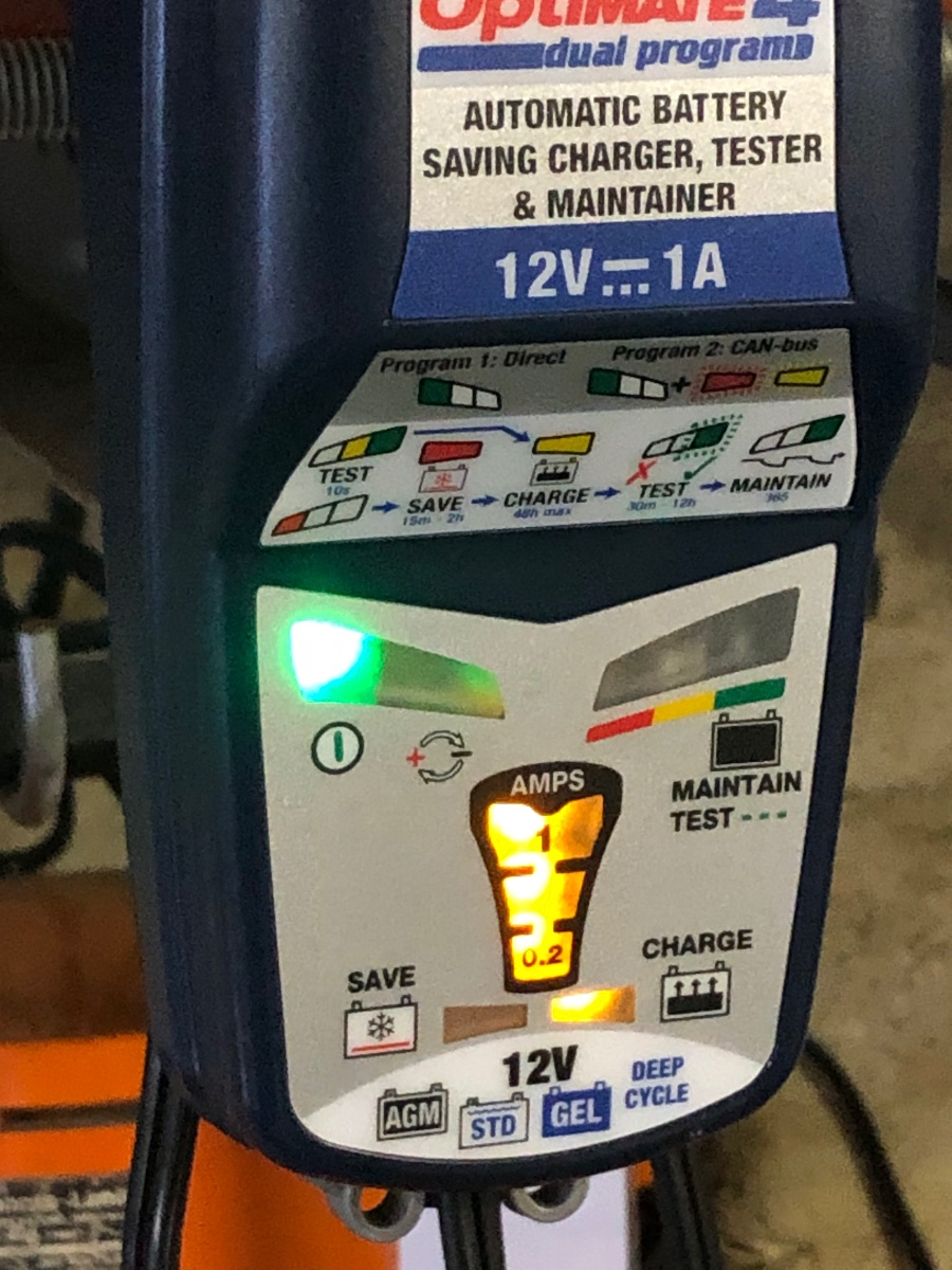

Looking like mines on the way out too, half an hour after a run, checked voltage on dash… 12.1v still starts ok etc but when I put the Optimate on it’s taking full charge for a while… think I’ll change it now rather than getting weird errors etc with low voltage

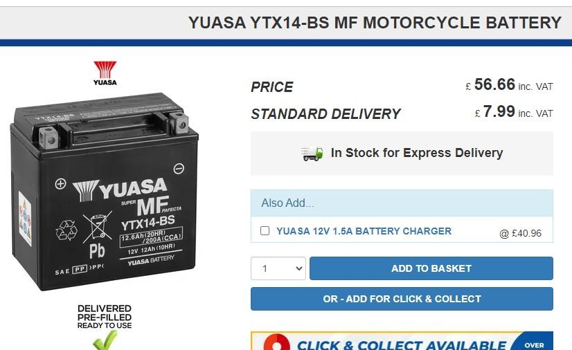

The Yuasa battery is available from other suppliers, "Google" Yuasa YTX16-BS.
e.g, Halfords, https://www.halfords.com/motoring/motor ... 40330.html

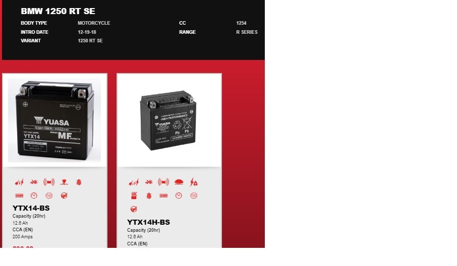

Thanks, just had a look on Yuasa's site, they say it should be a 14? Think I will pull mine out to see whats fitted...David. wrote: ↑Sun Jun 23, 2024 9:03 pm The Yuasa battery is available from other suppliers, "Google" Yuasa YTX16-BS.

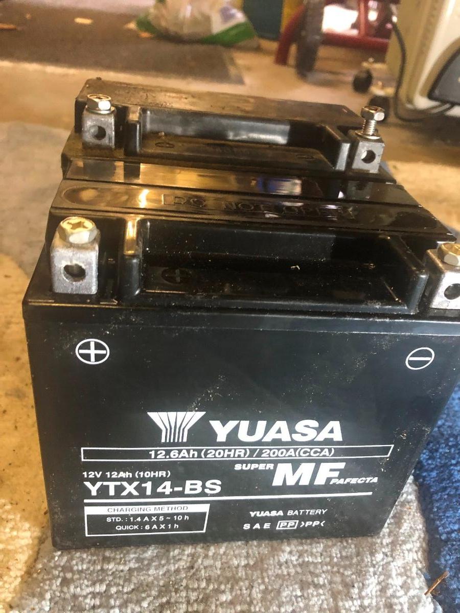

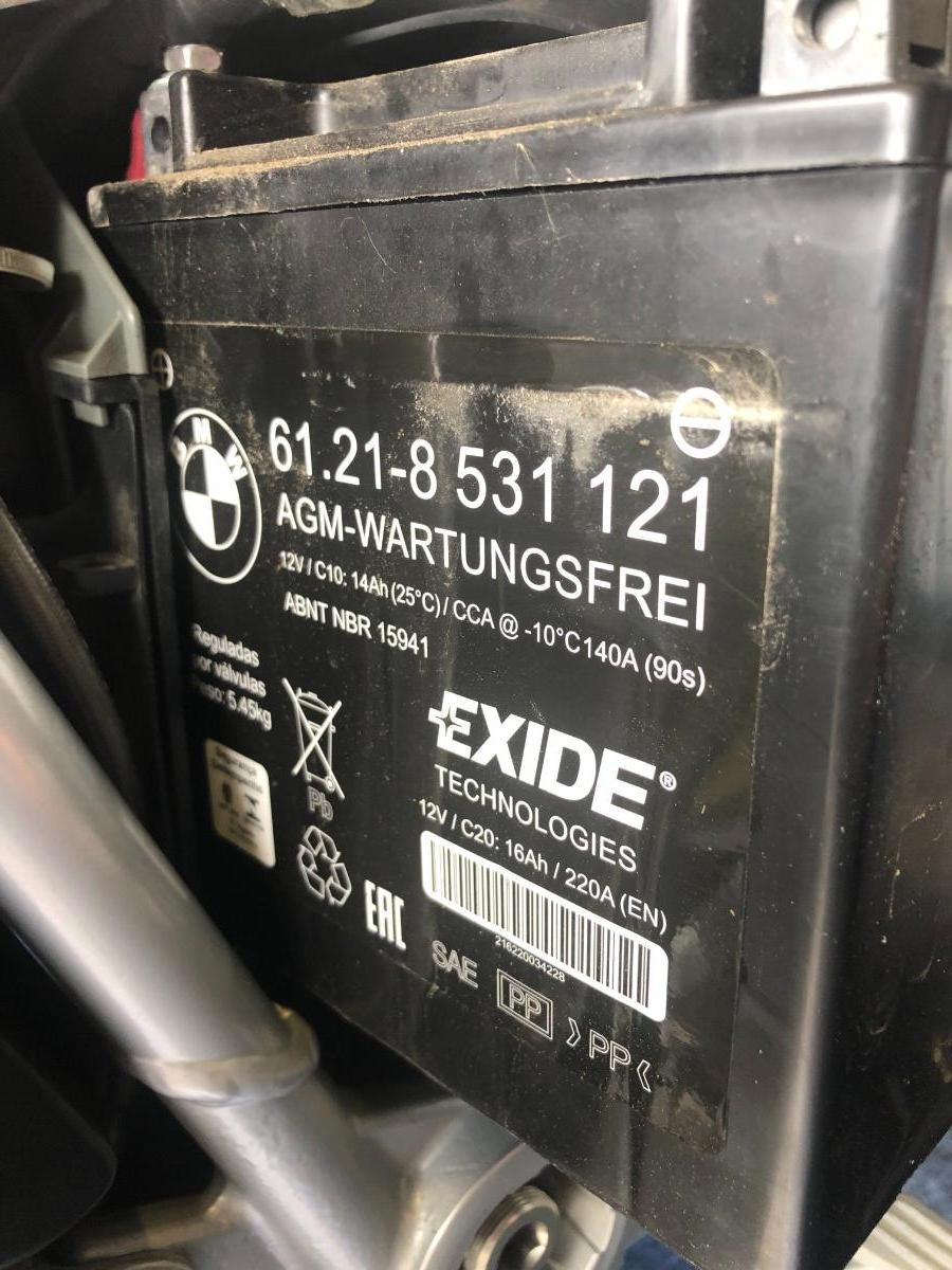

14Ah fitted as standard, just going with that. Disconnected the old one to see the label, service light came on then went off? Read somewhere its something to do with the date making the bike think its due a service?? Wouldnt be supprised I have to take it to BMW to get them to plug their computer in
sorry pic is upside down....

Pic fixed for you
I had the same battery and got a YTX16-BS from halfords at a good price
Having looked on motorworks mine is the same battery as yours
Here is the fitment chart for that part number
K series K1600 K1600 Bagger (09/2016 - 07/2021)
K series K1600 K1600 Bagger (10/2021 -)
K series K1600 K1600GT (09/2016 - 07/2021)
K series K1600 K1600GT (10/2021 -)
K series K1600 K1600GTL (09/2016 - 07/2021)
K series K1600 K1600GTL (10/2021 -)
R series R1200 liquid cooled R1200RT LC (09/2013 - 08/2018)
R series R1250 R1250RT (09/2018 - 09/2020)
R series R1250 R1250RT (11/2020 -)
https://www.motorworks.co.uk/battery-ela31123-1.html
This is the dimensions of the YTX16-BS if they match yours then get that one
Length (mm) 150
Width (mm) 87
Height (mm) 161
The YTX14 dimensions are
Length (mm) 150
Width (mm) 87
Height (mm) 145
As for the service reminder its just related to the date once you set the date it will go off again

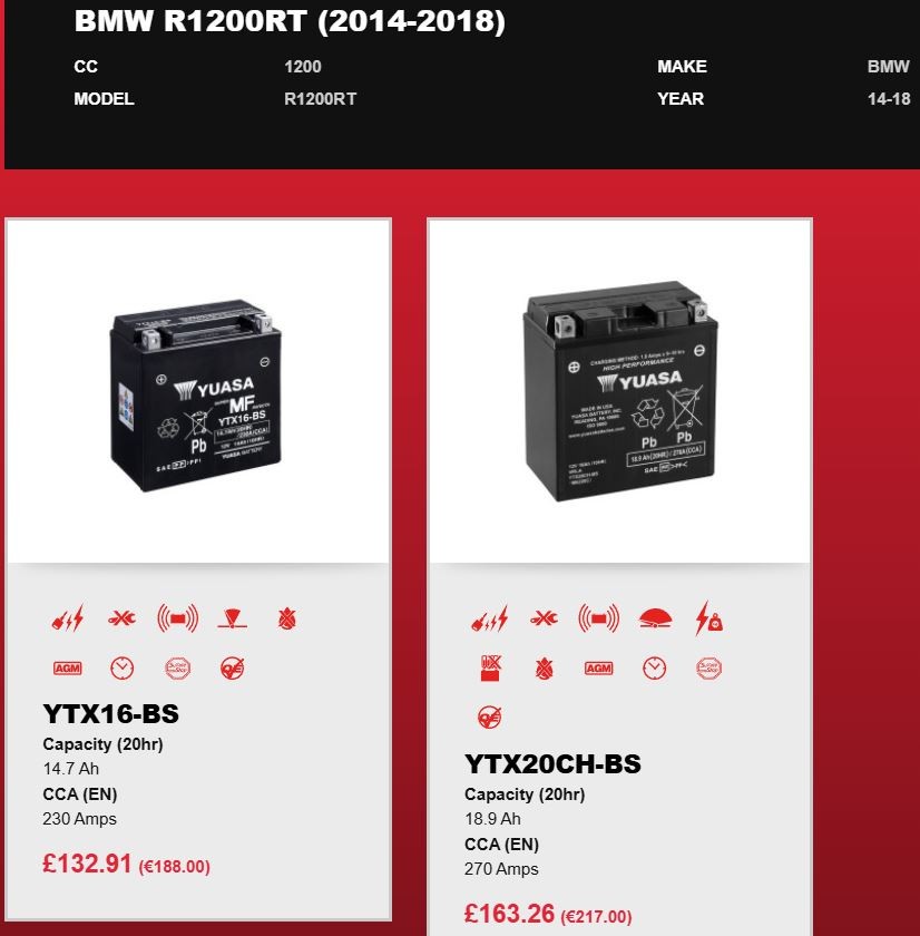

The Yuasa YTX20CH-BS is the high performance one listed against the YTX16-BS for an R1200RT (Wethead) same as that for the R1250RT (Shifthead).

New battery arrived today so im now thinking 2 + 2 = 5
So the Yuasa site says fit the 14, the original battery is a 14 Ah so obviously.. not.... the 14 is half an inch lower and is 12.6 Ah
So 14 is 12.6Ah / 16 is 14.7Ah / 20 is 18.9Ah..... so the prize goes to Sakm who suggested the 16 was the best replacement

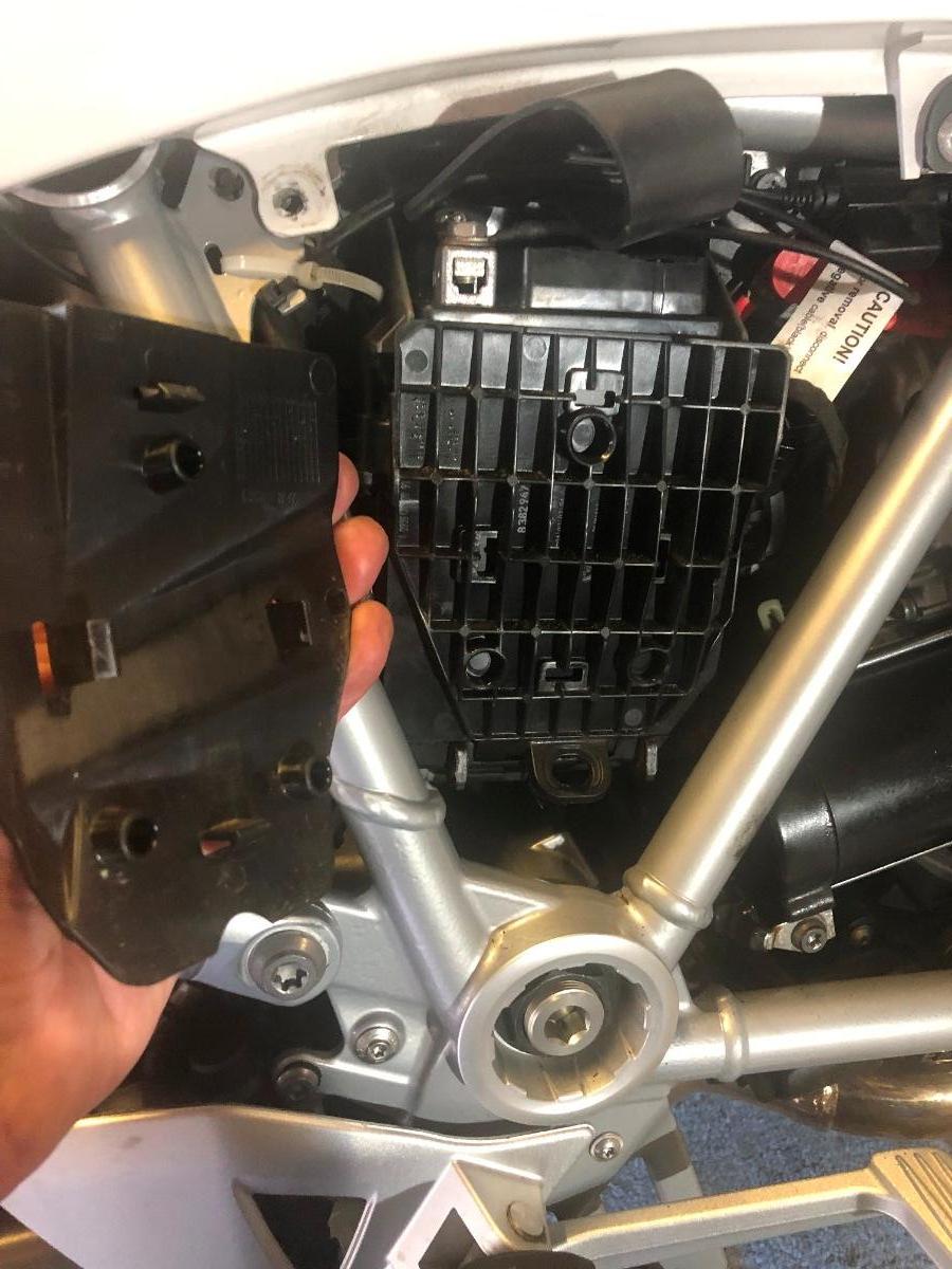

There seems to be a spring plate at the roof of the battery compartment so the shorter battery fits snugly and the rubber strap is tight on it.... so its in
And the prize for worst designer goes to the guy (or girl) who designed the batery box cover.. what a piece of cr&p..... after several attempts I ended up forcing the lower clip in below the battery, while doing this the plastic cover fouls the frame rails... then you have to lever it up with a screwdriver along with the battery to get two pins to fall into their slots?? Probably an easier way to do this but I couldnt find it. The cover is also two piece, so I removed the front thinking it might make it more flexible... not sure if that helped..
Then, grey service warning came up at first start, didnt on second or subsequent starts... not sure if it just shows once a day at this stage? Checked the date as was suggested but its correct, and my next service isnt due till the end of september..
Showing my age here but anyone else remember when you just opened your saddle ( on its hinges with a key lock) and lifted the battery out
ps: apologies again, my pics always go in upside down for some reason. edit, just worked out how to rotate the images
