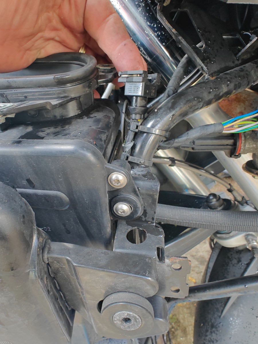

Bought a 2014 RT1200 a few months back.just getting in to service it. Taken right panels off to change air filter and at the front I have a connector, tied into the wire loom above air temperature probe.
It's open and carries a blue / yellow and green/brown.
I have no idea what would have been connected there? Any help

It looks like the second connector identified within this thread, viewtopic.php?p=65254&hilit=front+end#p65254

Thanks David. It is exactly that. And as many others are showing it not connected I am guessing the US market fuel vapour valve is favourite. Plan is to seal that with silicone. Right now it's collecting water!
