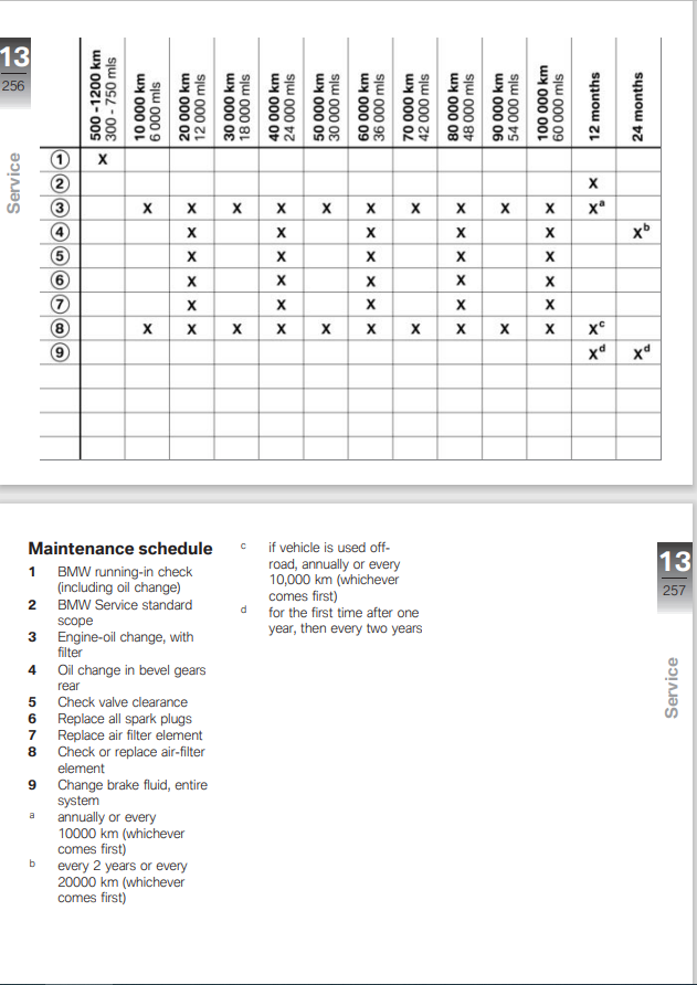

Posts: 8342
Re: Service Time
EasyRider wrote: Mon Jul 08, 2024 9:35 amHe just said that is what's needed at this service.
R1250GS Service.PNG (178.31 KiB) Viewed 1291 times
