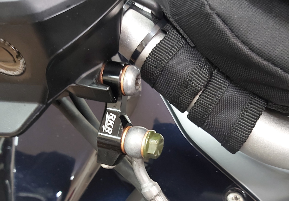

When i fitted the GS bars to my RT with bar risers, i found that the brakeline was at its max on full left lock.
I found this little extender that works very well, and its cheap to.
https://www.aliexpress.com/item/1005004 ... ry_from%3A

Thanks for the info. Is this fitted to your LC bike? Not sure it would work on my TC as there doesn't appear to be the space for it. I'm no bike mechanic so happy to be corrected.EasyRider wrote: ↑Tue Aug 27, 2024 7:41 am When i fitted the GS bars to my RT with bar risers, i found that the brakeline was at its max on full left lock.

This is it fitted to my 2019 RT with GS handlebars.
Its not that big, but it gives enough slack in the brakeline on full left lock.

The line on my bike is mounted horizontally, but could still work. Will depend if the neck bit on the extender will fit in the notch in the housing. Worth a punt anyroadup @ £7 delivered. Thanks for the heads up.

one thing i did do was put a little bit of lock tight on the allen bolt at the end. better safe than sorry.
