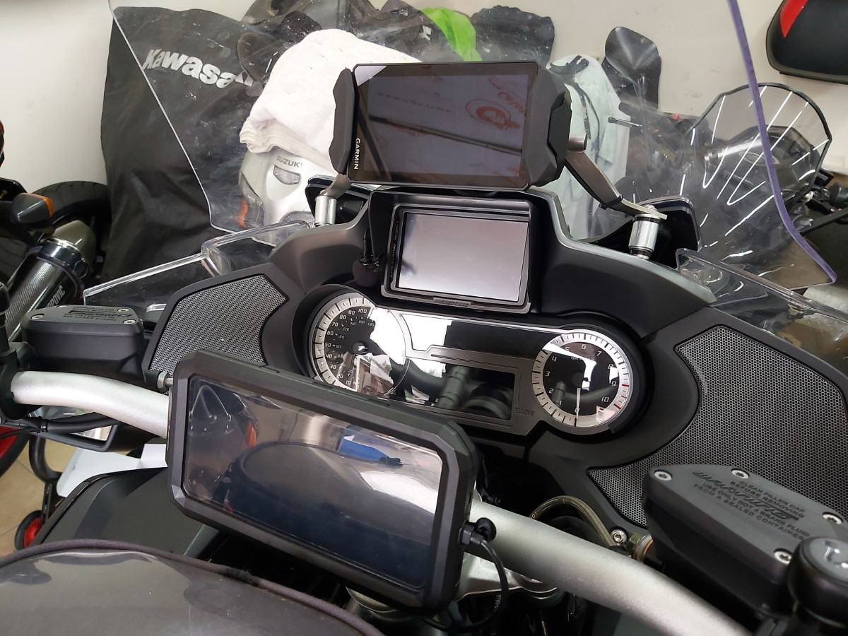

Another little project now done and finished.
I have the Navigator 5 fitted on my RT. I like having it so I can see the Bike info when i'm riding.
So i wanted to somehow fit another sat-nav for routes (Zumo XT & locking mount) on the bike.
I took a punt and bought the sat nav mount that "burridge01" was selling.

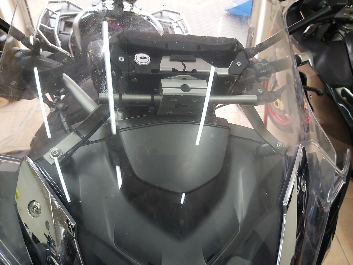

I had to use spacers and turn the mount around to lift it higher so it was not covering the Nav 5.
I had to bend and twist the arms on the mount using heat and grips and my rawhide hammer.
The power cable runs down thought the screen mount hole to the fuse box behind the right side speaker cover.
The sat nav does not touch the screen when it is down. I have a sun shade on order for the zumo XT as well.
Again i am very happy with how it has turned out and the sat nav is just in the right place for me.
I just have the LED lights to fitted now that i bought from NippyNormans.
I don't think i have any room left to fit anything else on the bike now
Extra Sat-Nav

Well its each to there own really. Its nice having a bike that i am able to do what i've done to it.
For me bikes are a hobby and i enjoy working on them aswell as riding them all year round.
And if adding extras like i have to my bikes means i enjoy them more then thats all that matters to me.
I post on here what i have done so anyone else who wants to do something like that knows its possible.
Not everything i do to my bikes is just bolt on, some thinking and adjustment is needed to make it work.
I've tried to add info to this forum to help others in little ways from repairing panniers to adding accessories.
The RT is still new to me and i'm still learning about it, so i use forums for info to help me.
Without members who add info on what they have done, how else will forums help you to learn.
I don't just post "I have a problem please help me" or sit on the side lines ready to pounce.
