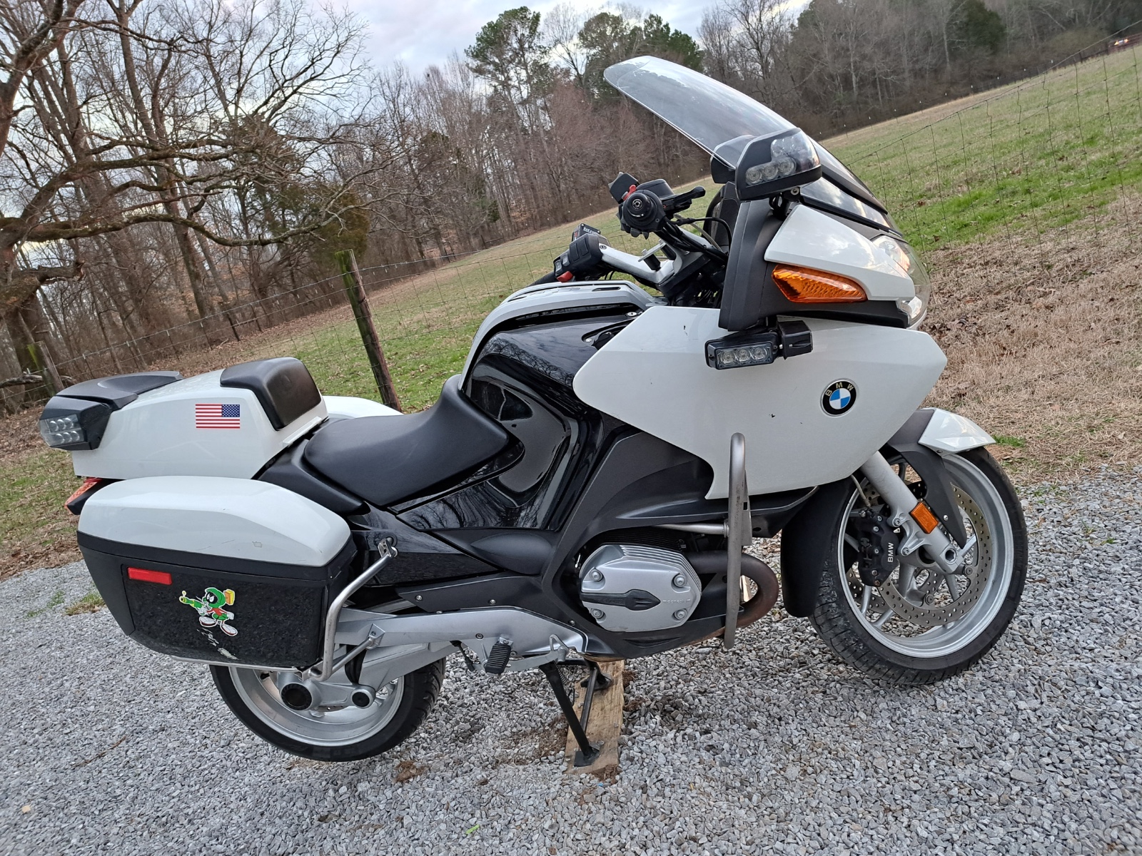

I found some Bel-Ray synthetic that did not have the limited slip friction modifiers and used that in both holes. I will say the first ride I took on the bike yesterday was about 40 miles and about 3/4 of the way through it, the gearbox decided that Neutral was an optional selection. I was a bit concerned as it was my first outing on the bike, but it was intermittent and when I got back home I could not replicate it.
Today when I swapped out the fluids, the gearbox fluid was IMO significantly polluted and as soon as I saw it thought my no Neutral was going to be a short lived problem and sure enough, the bike is MUCH happier with the fresh gear and final drive juices.
I was also tempted to do the service with the tire on but I did not have a T25 that I could squeeze in to remove the sensor/fill hole. I used 180ml of fluid in the final drive.
Due to the condition of the fluids, I am going to do a second swap at a fairly short interval, maybe in 1k miles +/-
