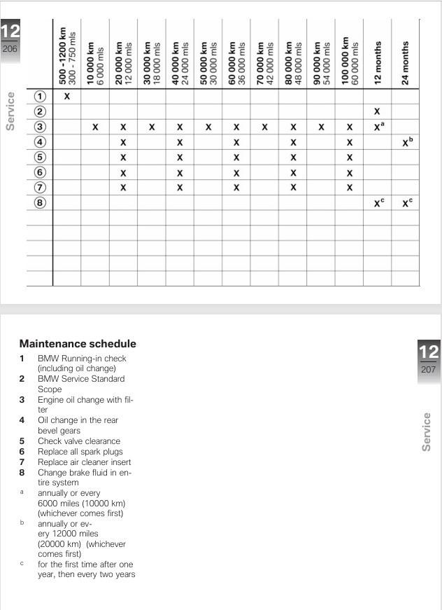

At 6,000 miles, only an oil & filter change is required.
R1250RT Service Schedule.jpg (80.45 KiB) Viewed 1093 times
