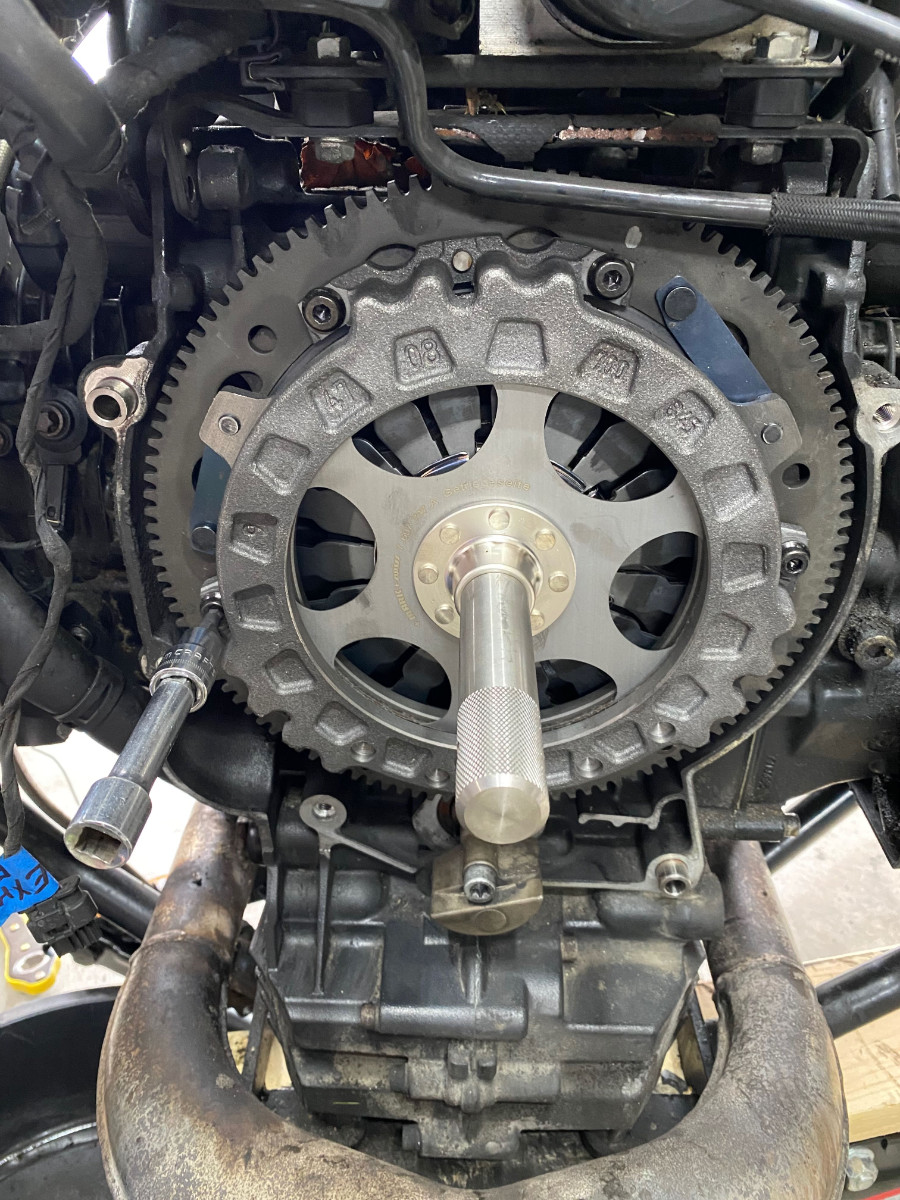

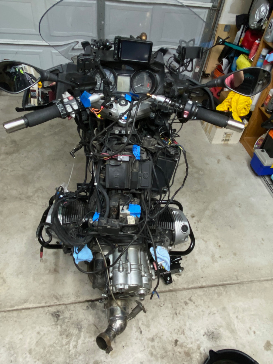

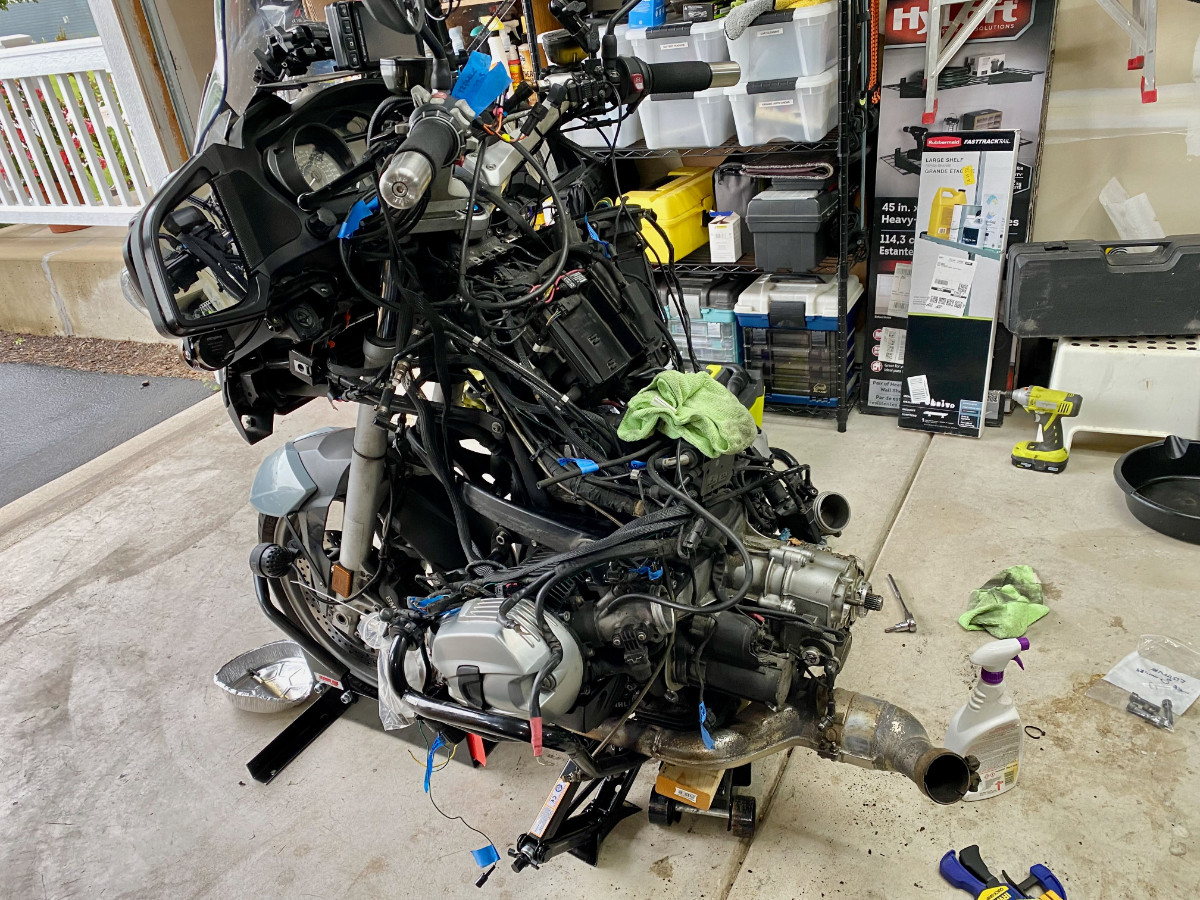

Replaced clutch on my 2010 RT with 95,000 miles on it about 2 years ago. Sourced clutch kit from Euro Motoelectrics our of Denver. Was not an extremely technical job, just time consuming with a lot of disassembly required. It would have taken me a weekend, 2-3 days to do, but was a bot longer as I had a repair made to rear frame that required an extra week. Label parts, label connectors, take lots of photos and even videos as you disassemble so yu can get it all back together. I used ziplock bags to put fasteners and parts in with labels and used painters masking tape to label connectors and wires. I had a Haynes manual with some instructions and torque specs. A second or third person can help, especially with removal of rear subframe. I've seen some leave wheel and swingarm in place on frame but I removed when separating from front. There are some videos out there that give some instruction and maybe not all he steps but an overview of what needs to be done. The only special tool I needed that I didn't have was a clutch disc centering tool, but I think Haynes give you an alternative homemade tool you can use as I recall.
