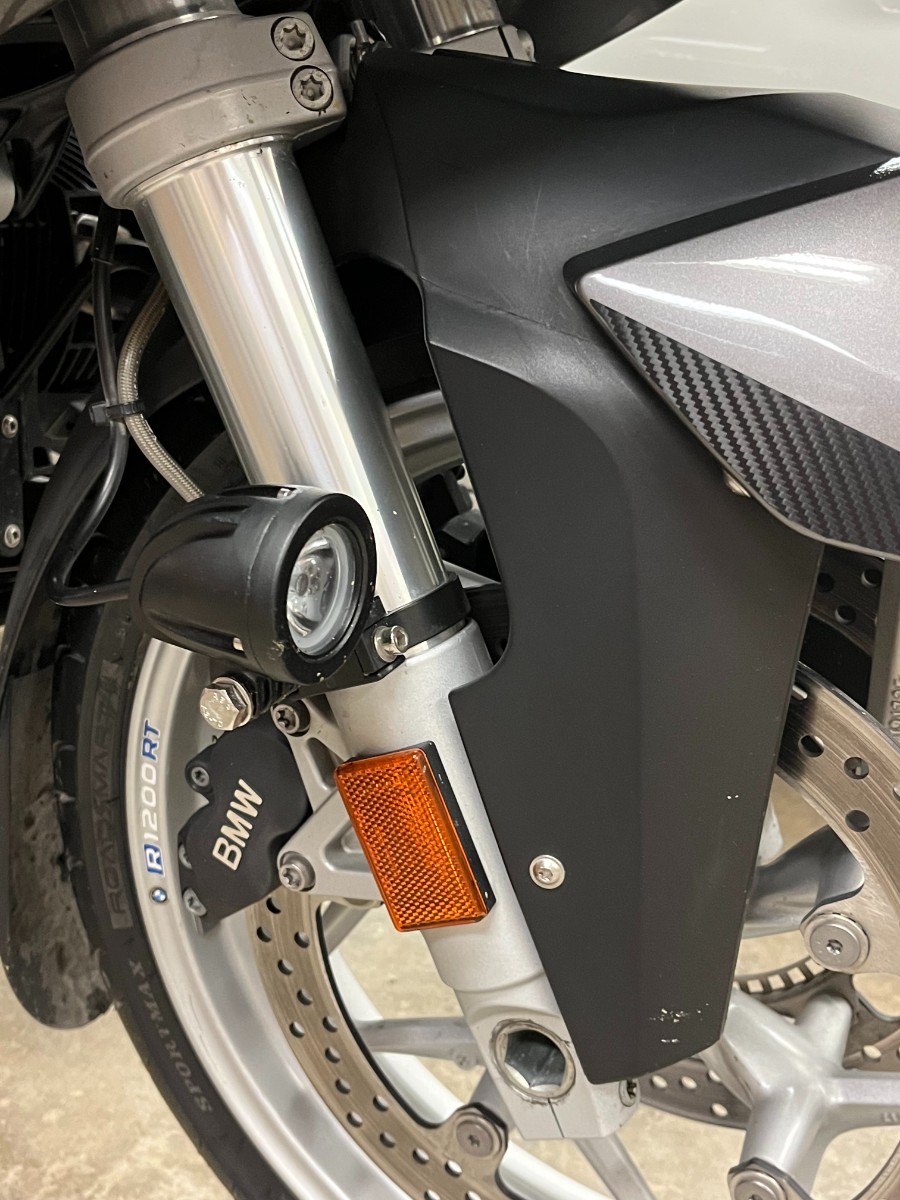

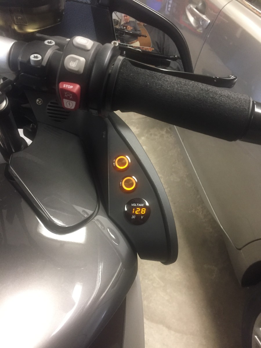

The easiest and cheapest way to go is a with a relay. Control the relay with an on/off switch or by tapping into the low beam's 12V power. Feed the aux lights directly from the battery via the relay. The canbus does not even notice the very small mA draw of the relays coil. Just so you know, if you go the on/off switch route and power it from the bikes switched power the aux lights will stay on for about 30 seconds after you turn off the bike.
Here's what I did on my '13RT:
Greefy67
Posts: 27
Joined: Tue Oct 01, 2024 9:59 pm
Bike Model and Year: R1200RT 2006
Has liked: 4 times
Been liked: 4 times
Re: Auxillary Lights
Post by Greefy67 »
Where did you get the brackets?
