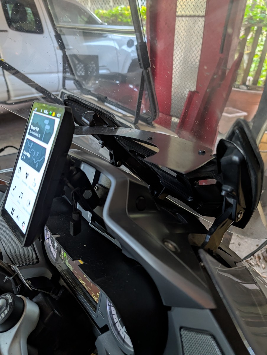

I'm looking for ideas to increase the airflow while riding my 2018 RT with the stock windshield in the lowest position. The K1600GT has nifty wind deflectors that when opened direct airflow into the cockpit for just such cooling. Has anyone experimented with trying to mount those on an RT? I have found aftermarket adjustable wind deflectors for Honda Goldwing, but nothing that would fit an RT. I have Wunderlich Fairing Protection Bars installed which would make a convenient mounting point. See image and red oval for a possible mounting point. Any ideas are welcomed!

Wow that's a big phone??? :lol:
Re: Need more airflow for warm weather riding
scunny12 wrote: Mon Oct 31, 2022 8:20 pm Wow that's a big phone??? :lol:
It's not the screen or fairing causing the lack of cooling air, it's the 50" wide screen tv! :lol:

Yeah, I considered that but I rode without the tablet attached and it didn't help. Plus I'm addicted to YouTube...

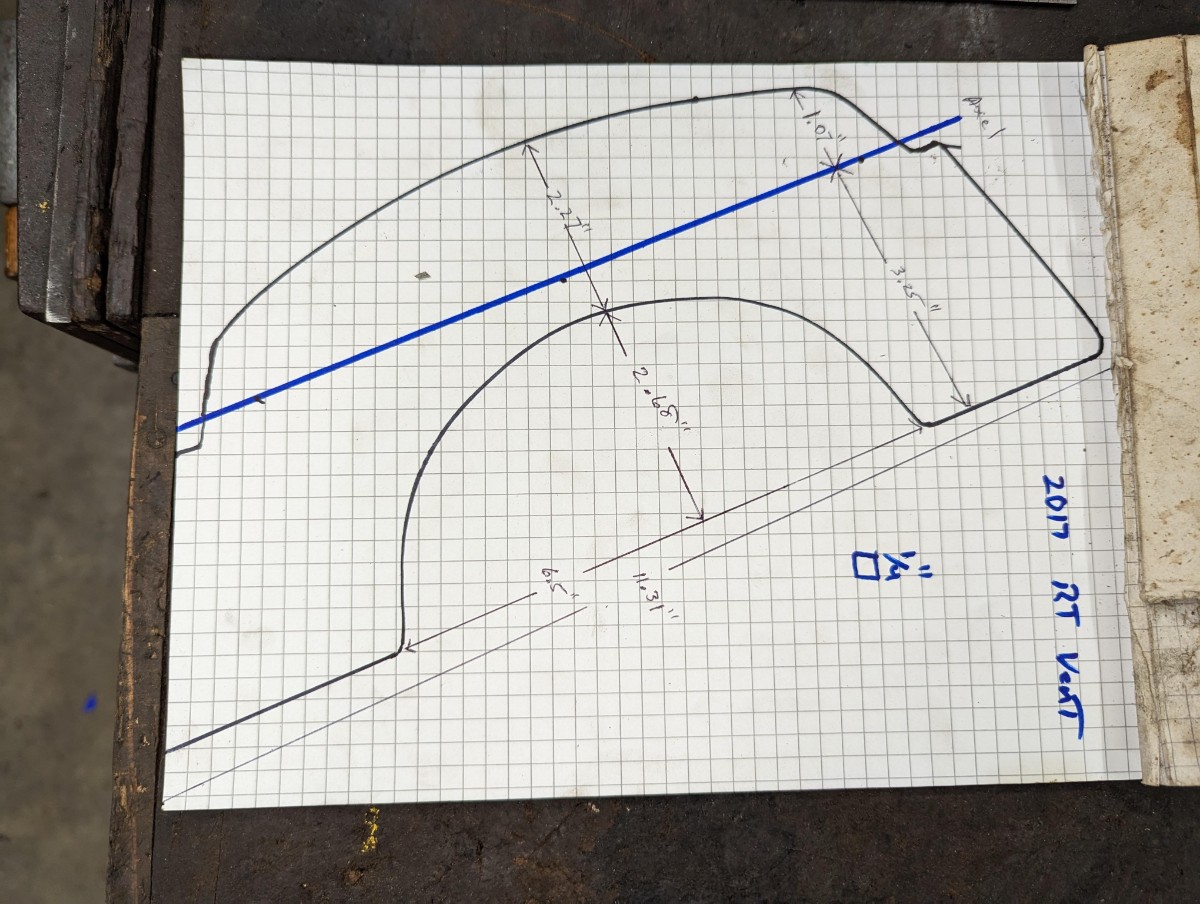

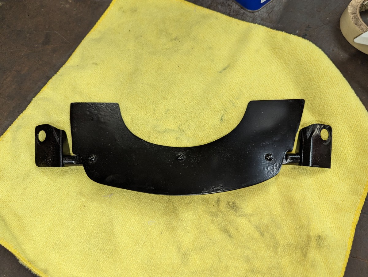

I don't know how handy you are, but I made this about 2 years ago out of aluminum sheet. It mounts to the windshield supports and supplies a good bit of ventilation by diverting the air coming up through the back of the windshield.

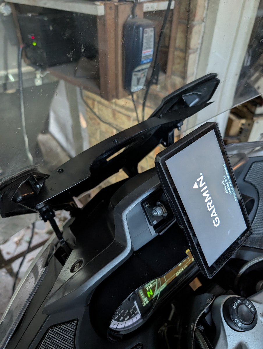

Can you send a photo of it installed on your bike?

It is hard to get a good angle for a picture, and the vent is pretty much invisible from the exterior. But here you go,
When the windshield is lowered, it lies flat on that deck area under the windshield. When the windshield is raised, the vent is adjustable.
The vent is screwed to a quarter inch aluminum rod. The mounts on the end are aluminum sheet bent to resemble angle iron with appropriate holes punched/drilled in it.

Very clever! I will try to duplicate. Thanks!
