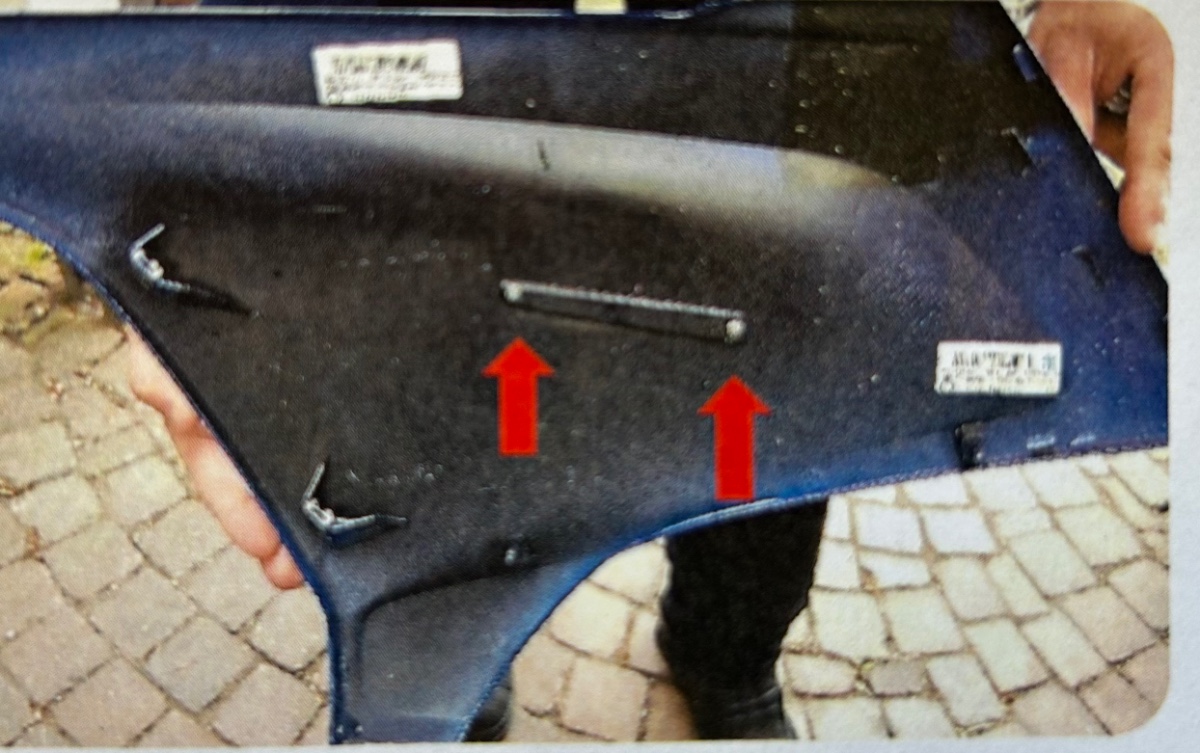

The side badges are held on with two self tapping screws through from the rear of the fairing panel.

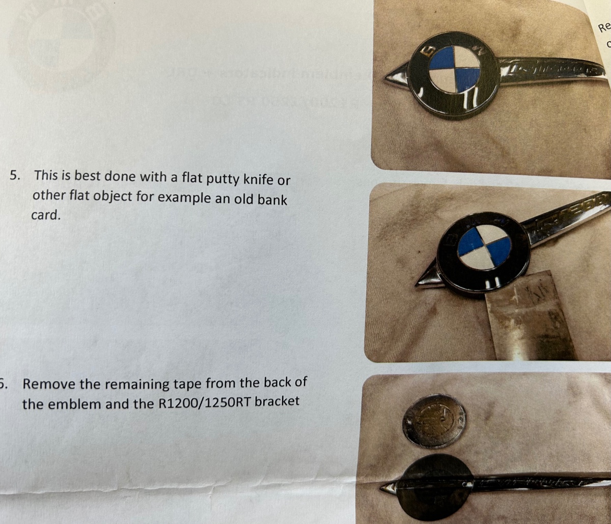

On an R1200RT LC (2014) the badge assembly is held onto the fairing panel by two screws. The rounded badges themselves are held in place by double sided tape.
