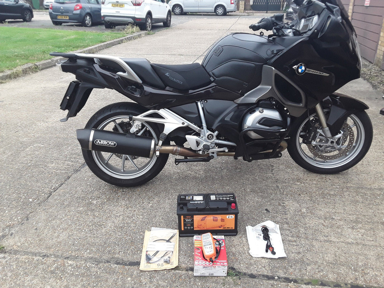

Plus with that set up(I did it on mine)you can run higher load out of the pigtail :thumb:

Connect straight to battery as I did on my 16.I ran DC to DC as I had no power in my garage(ran it off a leisure battery) worked a treat.
