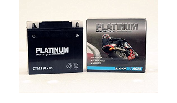

I ordered a battery a couple of weeks back from Tayna Batteries when my RT was struggling turning over at 3 Degrees (when will I see you again) C. I typed in 'CTM 19L-BS' which was on the side/front of my existing battery and bought an Exide replacement, It came next day and cost about £70 ish, it fitted perfectly and turns over much better than the old one. Jobs a good un.
Re: Changing battery.
CTM19L-BS, that's a new one on me, looks like the brand is Platinum.
This battery isn't currently within the Platinum range, they have reverted back to a wet flooded version rather than AGM, this is a CB12C-16A-3.
Not a lot of use on an RT where the electrolyte level won't be easily visible.

David. wrote: CTM19L-BS, that's a new one on me, looks like the brand is Platinum.
Yeah that's the one, replaced it with a GEL 12-19 Exide BMW Motorcycle Battery -51913 @ a cost of £67.96.
