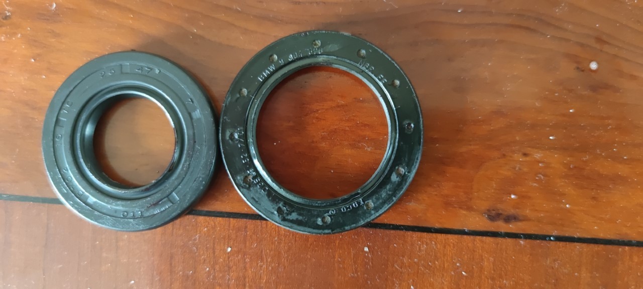

Fitted the bearings today. Used the Rawplug and heat gun method. A 10 minute job but and there is always a but. The seals they sent are the wrong ones. Typical Saturday nowhere open to get the correct one. Have to wait till they send the correct seals.

Received the correct seal today. Fitted and wheel back on. After i finished i thought i would take the covers off the old bearing. One looked rusty with only a tiny amount of grease and you feel notchy. The other was clean and ran smoothly. This one had plenty of white grease in it. Overall this looked like a newer bearing. In the service history, there is no mention of a new one being fitted.
