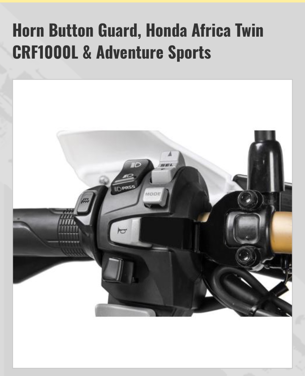

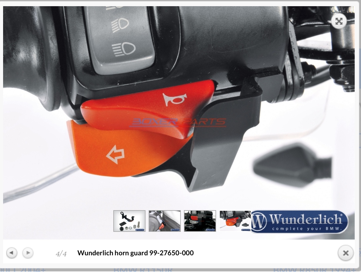

I know this is an old post but it’s still relevant thanks to the combination of the Baglux tankbag and Denali’s finest when I alerted all my neighbours of our departure at 04.50… too damn early for me, and certainly them.
Touatech do one for the Africa Twin, and Wunderlich/BMW for the early 1150/1200’s but nothing since. Anyone know different?
