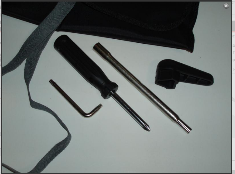

3) I think I'm the 5th owner and, obviously, stuff has been lost or modified. Here's what I got in the remnants of the toolkit. Clearly, I will assemble something better before I go anywhere (Mexico!), but I'm wondering if there is some critical BMW tool that would have been included and is vital?

3. There is a file by a fellow known as Boxflyer that lists all the tools needed for an RT. I had it, but the link is no longer valid. Hopefully someone has the new link.

That looks pretty similar to the tools I got with my ‘05 when I picked it up a couple of months ago. Judging by the second wrench from the right, you probably have an optional/aftermarket oil filler cap, a five point security torx (the plastic wrench at the far right is for the OE filler cap). Beyond that and some torx bits, I can’t think of anything special.
Here’s a breakdown of the supplemental kit from https://shop.maxbmw.com/fiche/DiagramsM ... d=09082020

if you look closely, it looks like I have the complete mini tool kit #01 71 11 7 699 568.
Here's the image of that "part"
...so I guess I'm fine for my upcoming Mexico trip!

andydavis wrote: Tue Nov 21, 2023 5:57 am if you look closely, it looks like I have the complete mini tool kit #01 71 11 7 699 568.
Yep thats all of supplied and more. only tool missing is CC.
