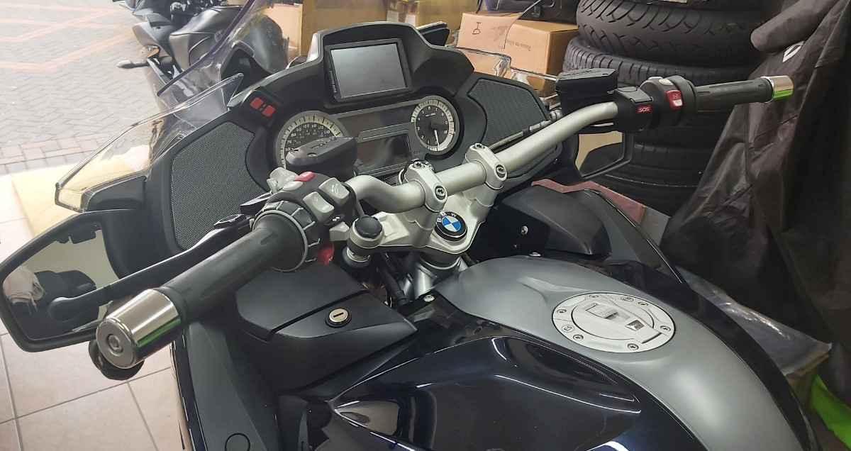

This is what is should look like once all fitted.

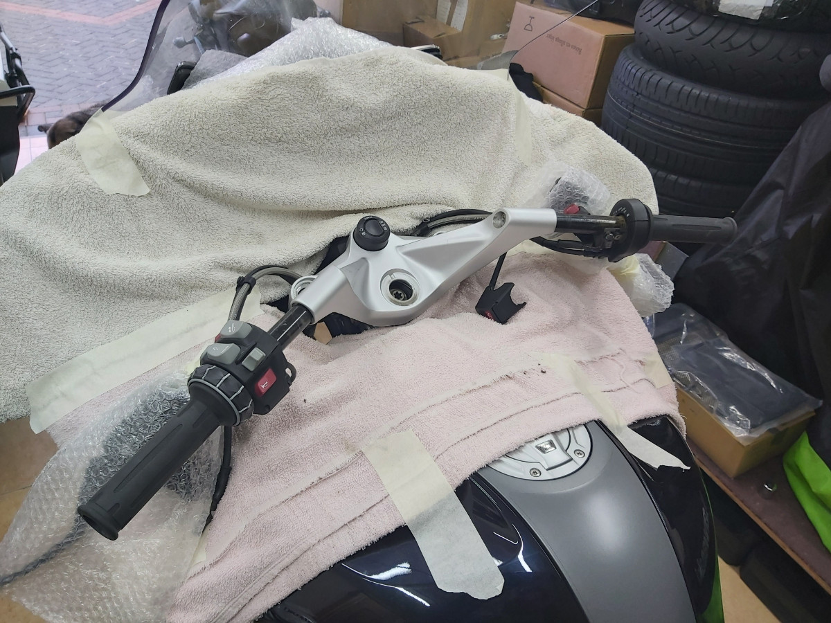

So this morning i had time to work on Artie.
I thought that it was going to be a hard-ish job to remove and swap over the top yoke.
It was very easy to do, and took me 2 hours including drilling out the ignition switch and swapping it over.
So i am now already for the handlebars and bar risers to come.
Just for info, you need to place a jack under the front of the engine.
This is not to lift the wheel off the ground, its just to take the weight off the forks, or the tops move backwards.
I found this out when i removed the top yoke.
Also you can never have enough towels or bubble wrap on the bike when working on it like this.
This is costing me just over £200 to do. Which is cheaper than Helibars and the other type of risers you can buy, apart from the cheap ones from China.
And as it is an opition to have from BMW, it will look stock as all the parts are BMW OEM parts.
Here are some photos of what i've done so far.

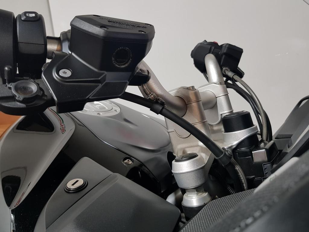

Re: GS Top Yoke Conversion Kit
Posted: Sun Feb 04, 2024 1:35 pm
by Doctor T
My brake line is at the max with a lower riser but the clutch line is fine. Just make sure but testing them on lock to lock

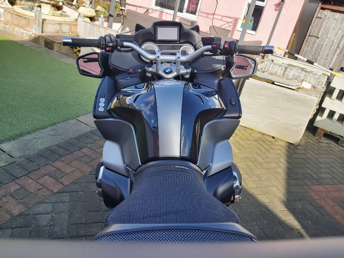

So i have now fitted the GS handlebars. They are about 3" wider than the RT cast bars.
I have read that you can cut upto 30mm off each end to make them narrower.
Will wait and see after riding it for a month or two.
From just sitting on the bike on the main stand, it feels a lot more relaxed.
It is very close to my Varadero which was my goal.
The only problem is the mirrors. The view from them now is not that good.
So I have bought a pair of round bmw mirrors to go on to the handlebars.
Here is a photo of the bars fitted without the mirrors.
GS handlebars fitted on a RT.jpg (214.14 KiB) Viewed 9579 times

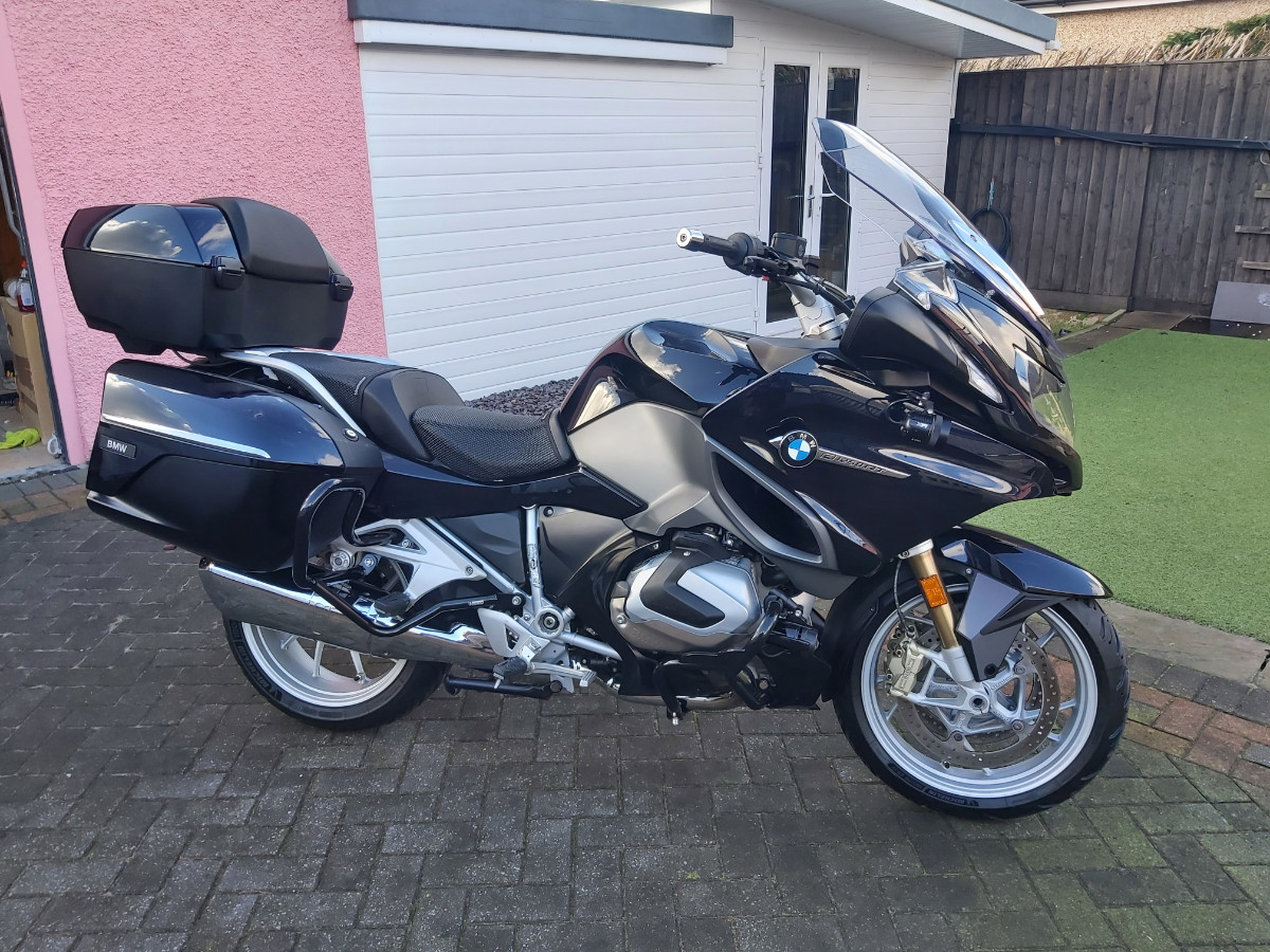

The sun came out so i managed to get the bike out for a couple more photos.
I rode it at walking pace up the drive, and the slow speed stability was very good.
