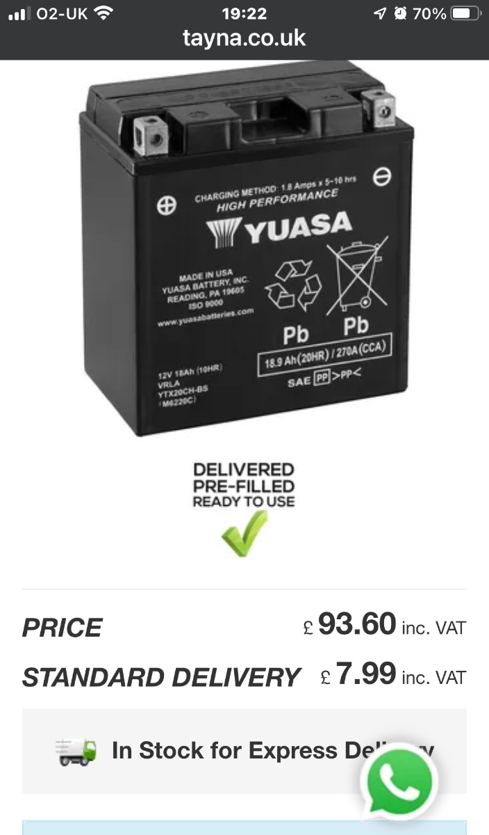

I bought the Yuasa YTX20CH-BS from Tanya, same size as standard but higher rate, and recommended by Yuasa for the RTLC.

Steve398 wrote: Thu Mar 14, 2024 7:22 pm I bought the Yuasa YTX20CH-BS from Tanya, same size as standard but higher rate, and recommended by Yuasa for the RTLC.
Thanks for that, interesting thing is when I looked at Tayna for this battery to order it, it came up with the EXIDE ETX20CH-BS as a star buy in this size with 230CCA's....at £ 55.57 the same CCA's as the more expensive Yuasa I was going to buy originally... :| :|
