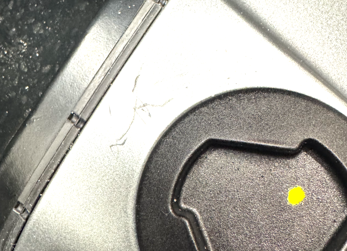

This is how they sent the bike back, all are fingernail deep:
Screenshot 2024-12-04 at 10.44.27.png (1.79 MiB) Viewed 2542 times
