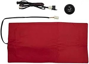

Here's one I've used and like. At least it should be, it's been two years, but this is the one, I believe.
It runs off the battery, and it's best paired with a relay switch that will turn it off when the key goes off.
Search for: "Saddle Tramp Universal Seat Heater Brand: Metra" on Amazon.
You have to remove the staples that hold the seat cover on AND drill a hole in the left side of the seat to hold the switch. I made a flat piece of plastic (cut to shape from Rubbermaid waist basket) with a hole just big enough to hold the switch but not push through. Without that, the switch wants to push through the hole when you handle it. The "collar" on the round toggle helps with that. A staple gun is a must for this project.
