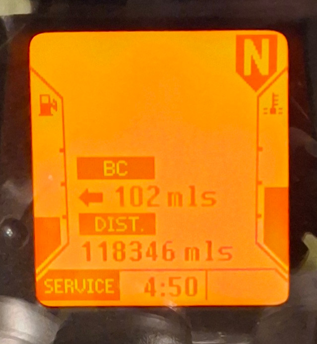

My BMW is trying to sendme a message!
Lower left corner, it says "SERVICE'...
I'm guessing this means something needs service. I've changed the oil, oil filter, final drive oil, this month.
What needs service?
How does one turn the message off? ... (legitimately)
This is all new to me!

OK, I think I get it. The Service message is a reminder that I may need service.... but it doesn't tell me what needs doing..., and there's no way for an owner to reset the warning to make it go away?
Do I really need to take this in to a BMW dealer?
What do you do when this message appears?
