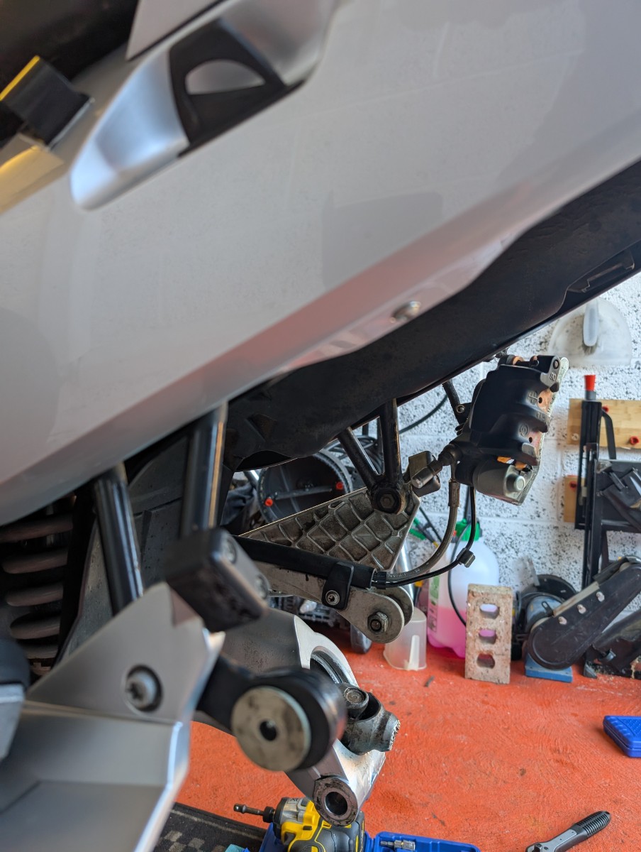

Do you have a photo of your bike without the panniers fitted.
There might be a plastic part missing for where the pannier fits onto the rear peg hanger.

Like this?
The footpeg block is in place. All looks ok. But they do dance around a little bit.

ok there in place. You could try wrapping some fabric tape (like they use on wiring looms) around the plastic blocks to see if it helps.
