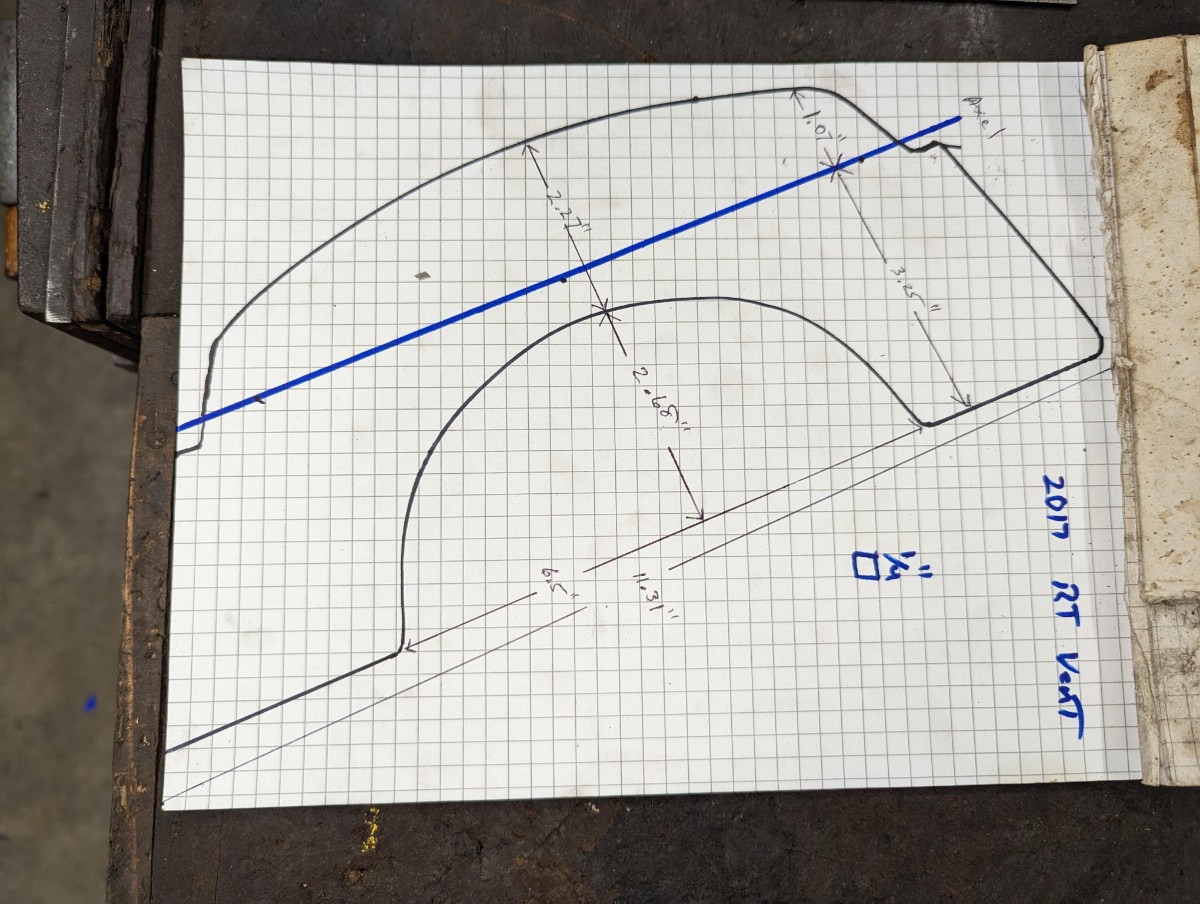

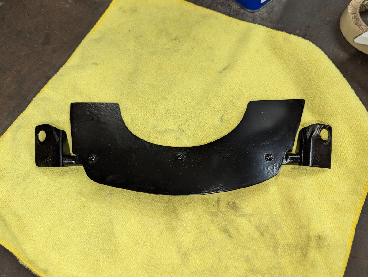

I made this up several years ago from some scrap aluminum in my shop. It works up to about 95 degrees. It fits between the windshield and its bracket using the existing holes. It directs the air coming from under the windshield to my body. It provides sufficient air to make my mesh gear work.
