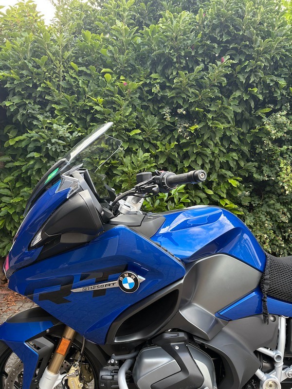

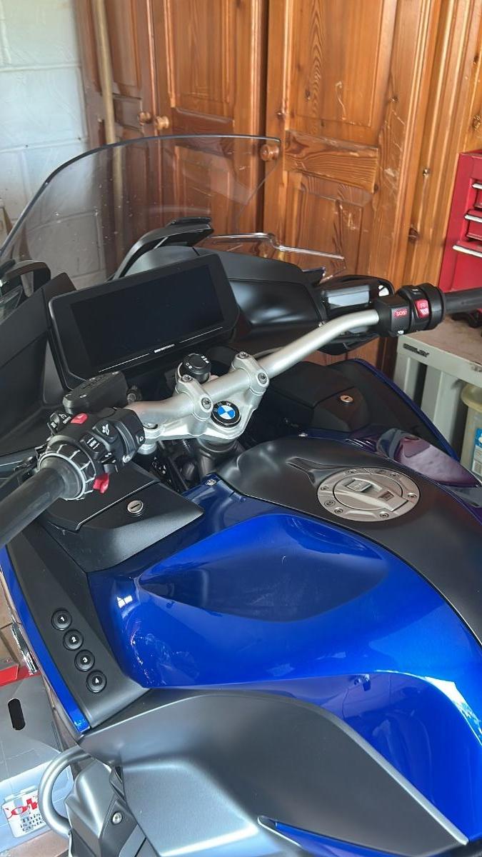

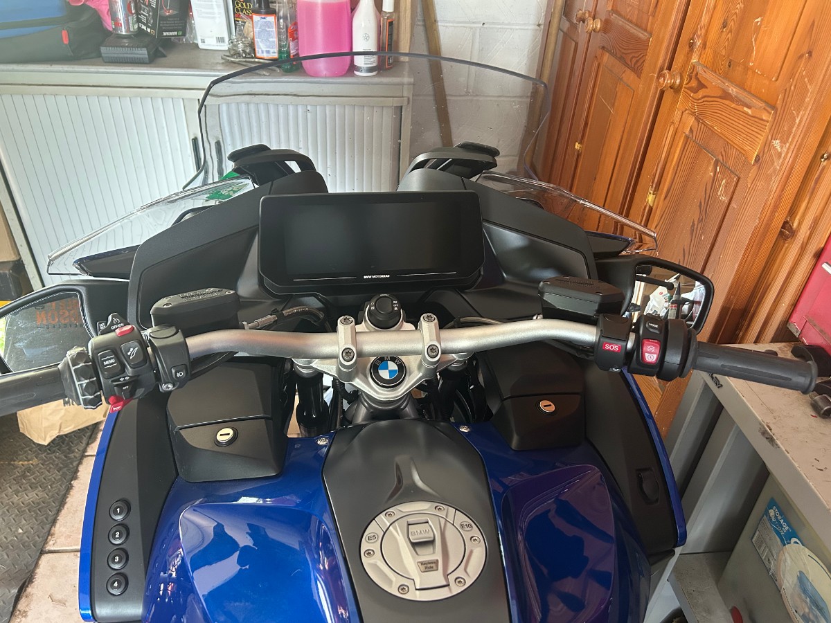

I did mine last week with a yoke I bought on here - bars are a few inches wider as has been said in the other thread. I do not have the risers fitted and the standard mirrors are still fine for me.
Took it for spin on Friday, two up to the coast, and the extra leverage is like having power steering! I've just had a brand new set of Road 6 GTs fitted as well after some well worn 5 GTs which is probably contributing to the feeling of lightness.
The RT bar end weights do not fit GS bars so I got some Evotec Bar End Weights and these are beautifully made:
https://evotech-performance.com/collect ... 13-to-2018

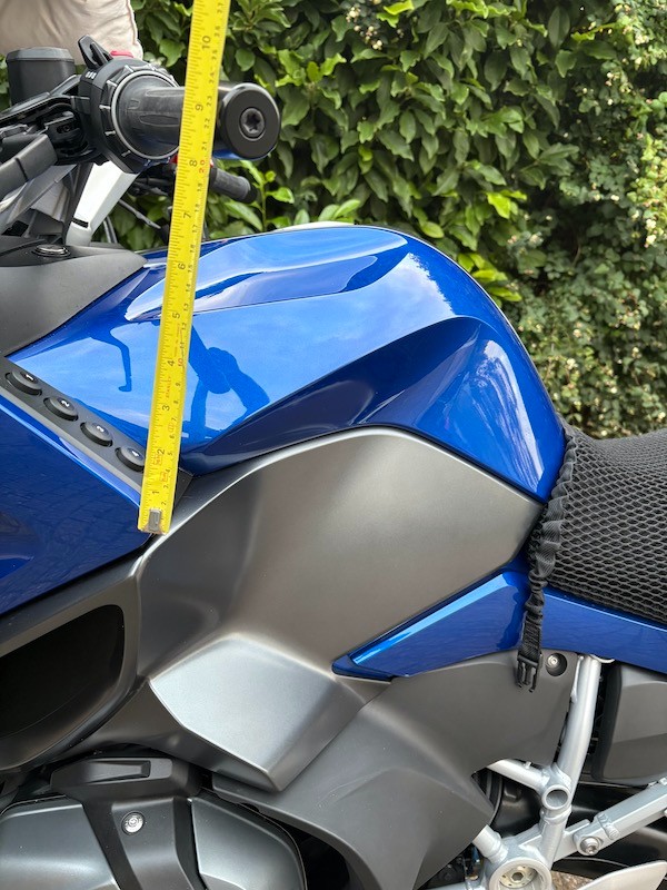

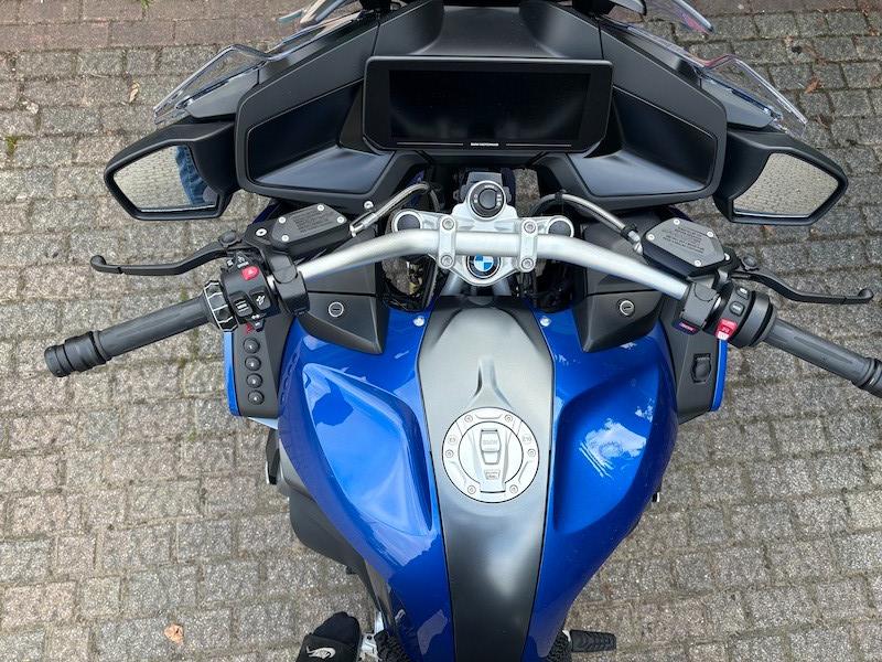

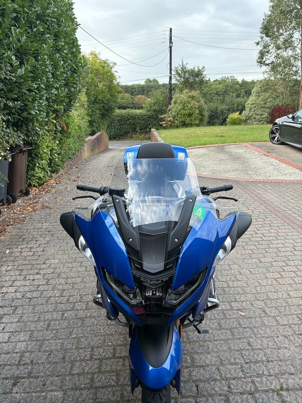

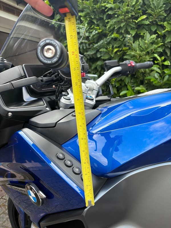

Re: Handlebar Conversion

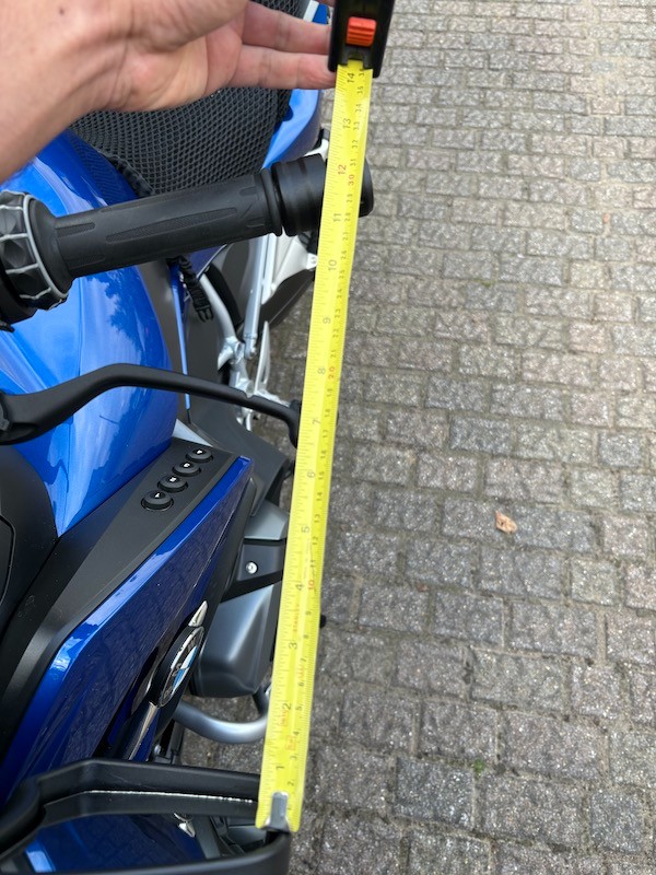

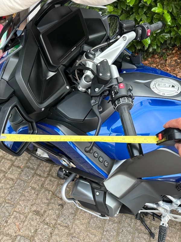

For anyone who is interested, the standard bars sit slightly closer to the rider but I could have rolled the GS bars back to compensate for this. They do sit about 75mm higher and of course they are 100mm wider.
They do sit inside the width of the bike, the perspective on the top photo does make them look wider.

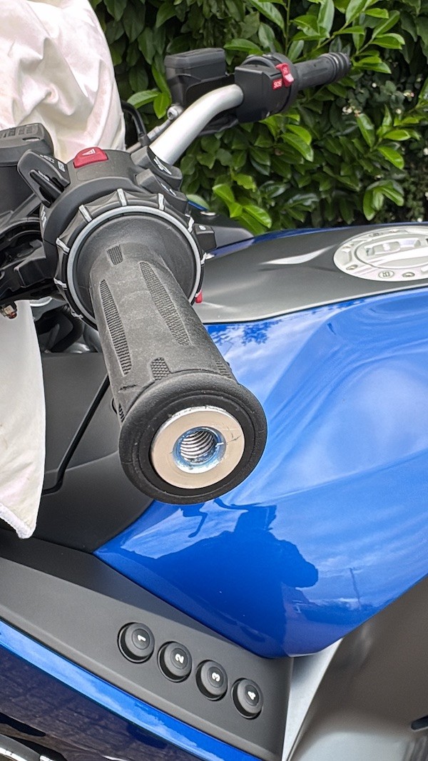

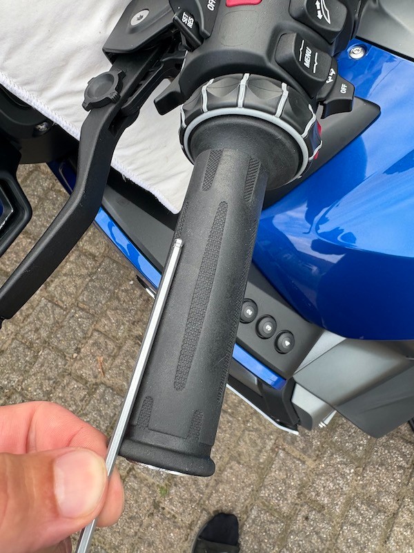

If you did want to cut them down you can remove around 30mm from each end and the threading goes a long way in, see the photo with the allen key to show the depth, so you can keep the bar end weights.
I've added a lot of photos for those that are interested in the difference.
I'll probably sell the kit now as I'm happy with the standard bars for my needs.
