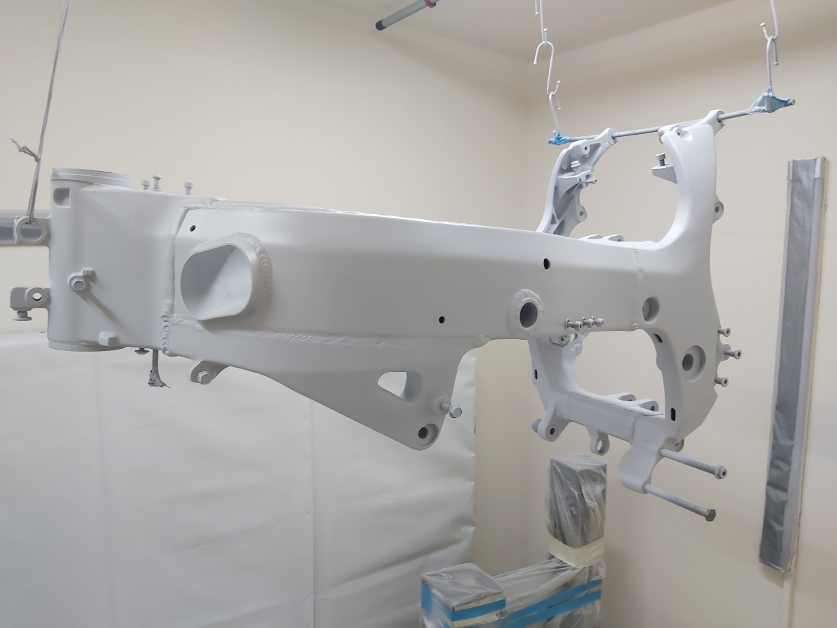

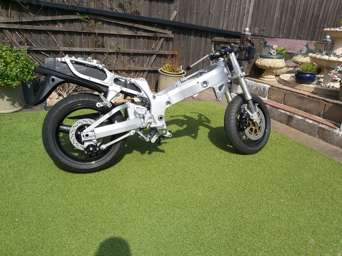

So i've now got the frame and swingarm, sandblasted, etch primed and 2k primed.
I've also got the sub-frame ready to 2k prime and some other small parts.

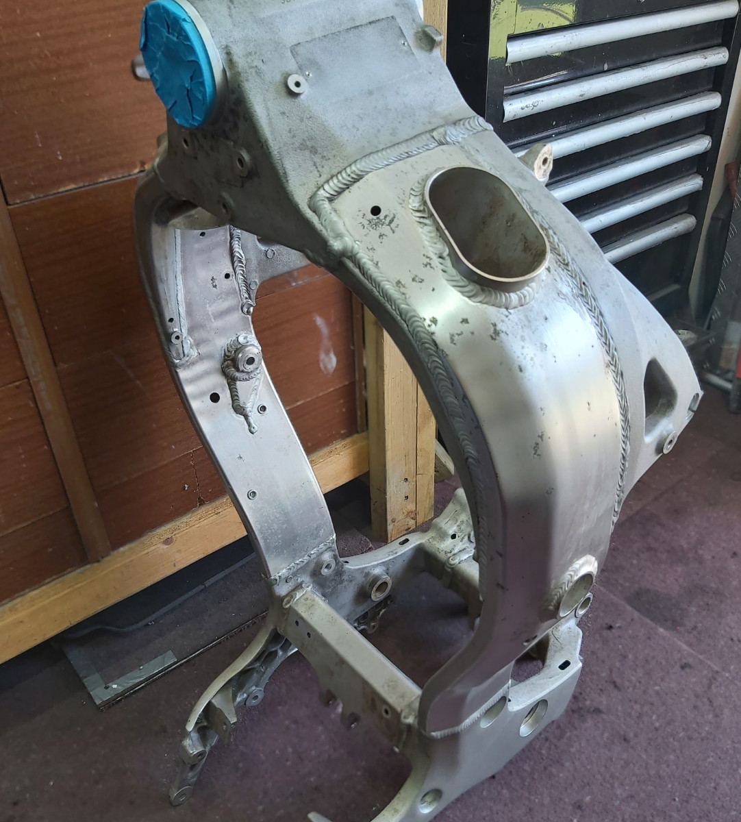

Here is what i had to start with with the frame. It was not in the best condition, but because of what colour bike is, it was worth saving. There are not many Copper/Silver Hayabusa's left out there and they cost more than the other colours to buy now. I wanted a genuine one and not a V5 colour change one.
I have everything here apart from a left side fork to build a rolling chassis. I will then over the winter buy a 1999 or 2000 year black or red hayabusa to use as a parts bike to build my Copper one.
I have been wanting to build this project bike for many years, and it nice now starting on it.
Once the rolling chassis is done i will finish painting the panels and fit them to the chassis.
Its the best place to keep them from getting damaged once painted.

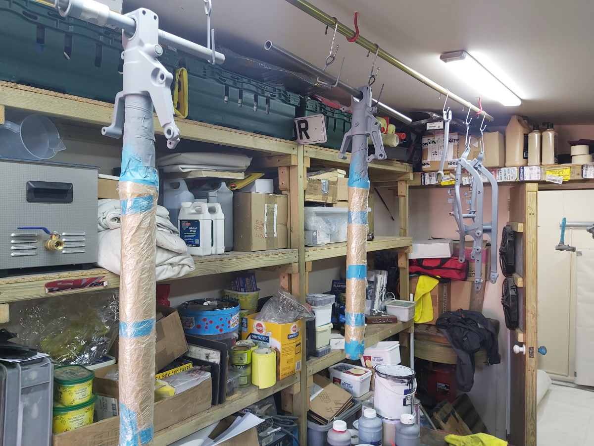

Re: New Project Time

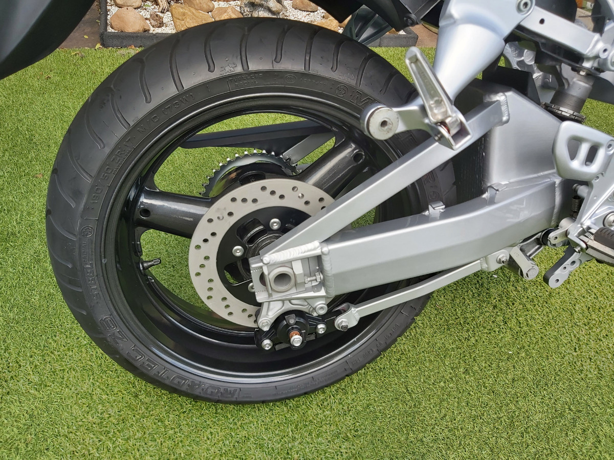

getting a bit more done. This is going to be a slow build project.
Before 1.jpg (378.27 KiB) Viewed 4274 times
After 1.jpg (357.36 KiB) Viewed 4274 times

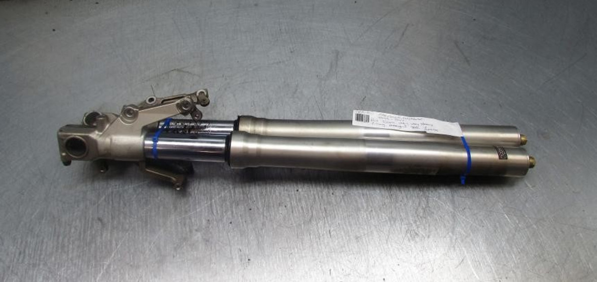

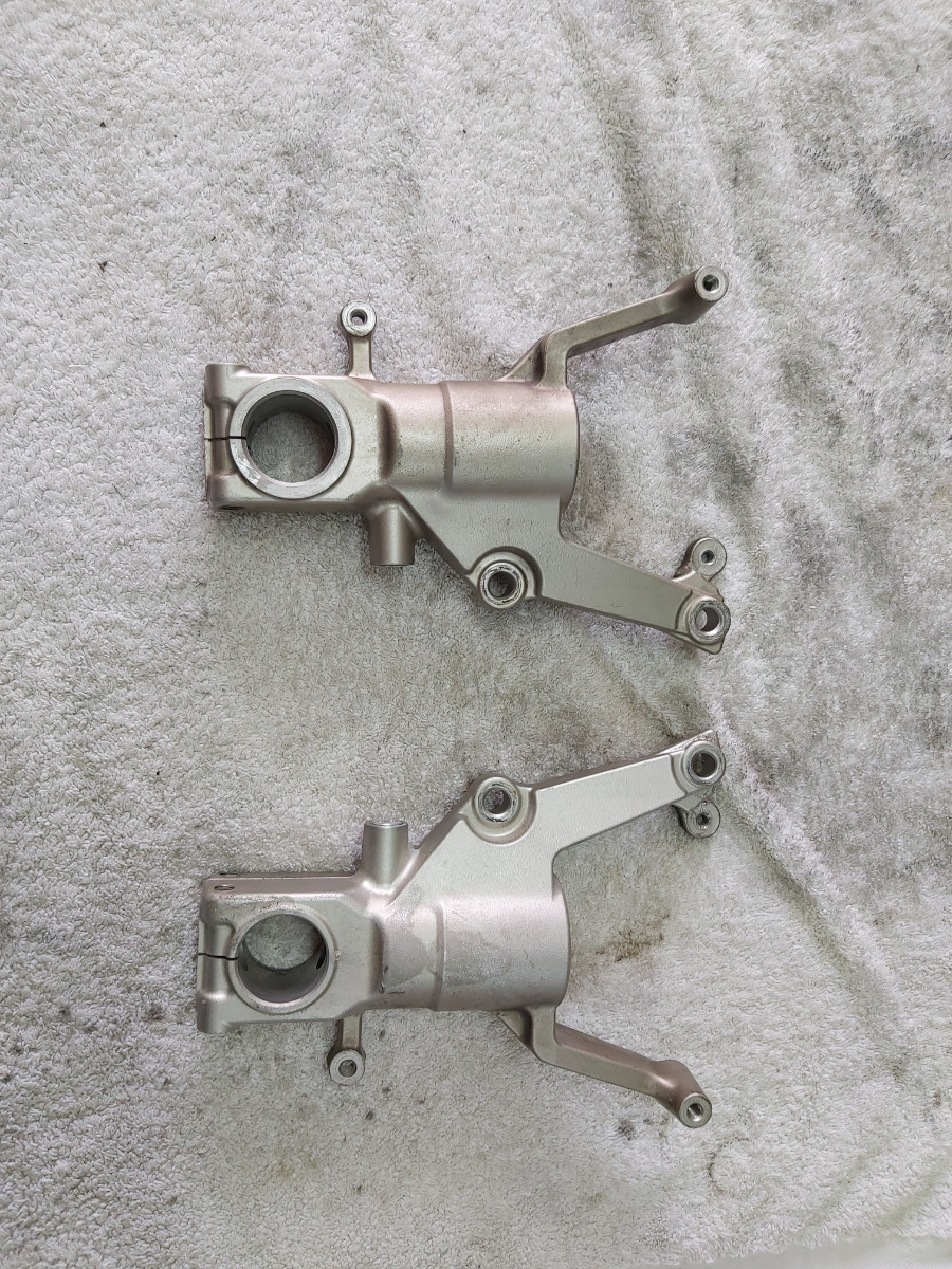

I brought a pair of used fork for £70 knowing they needed new tubes.
They came today and the tubes are now removed from the lugs.
All the parts orderd and its costing £292 in parts to make them like new.
So a total of £362 for a pair of 20+ year old forks :o

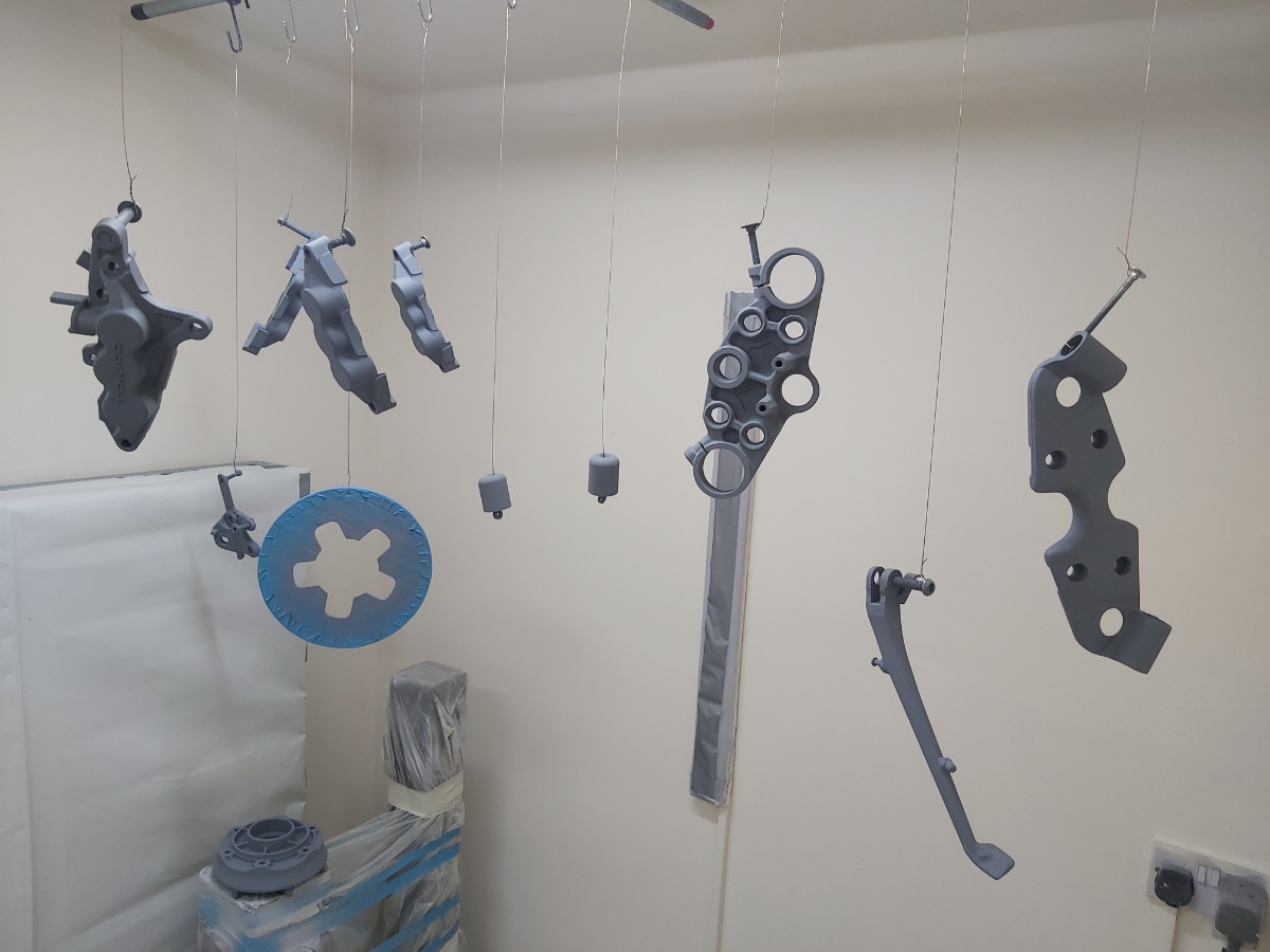

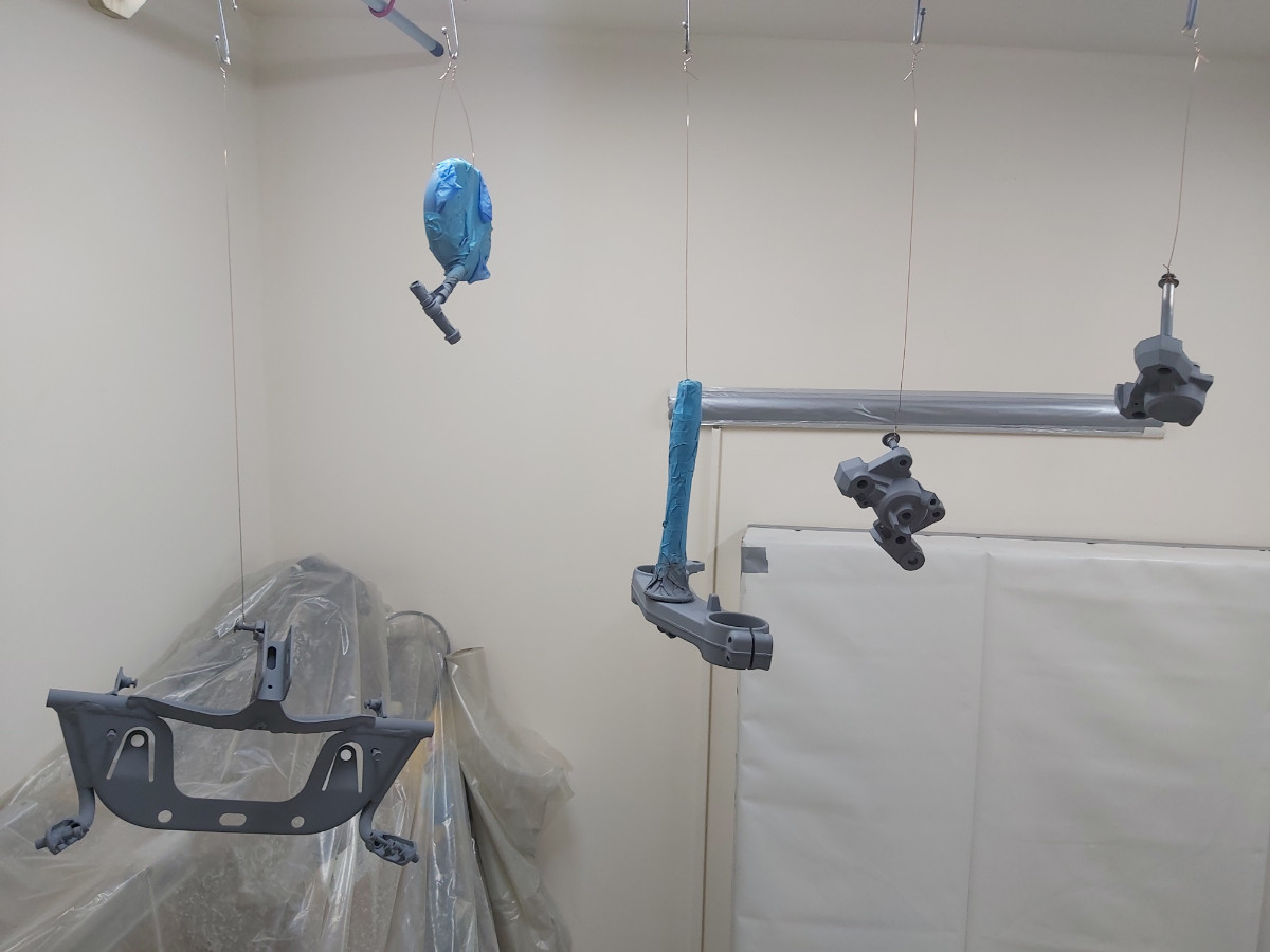

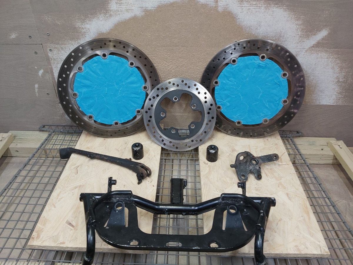

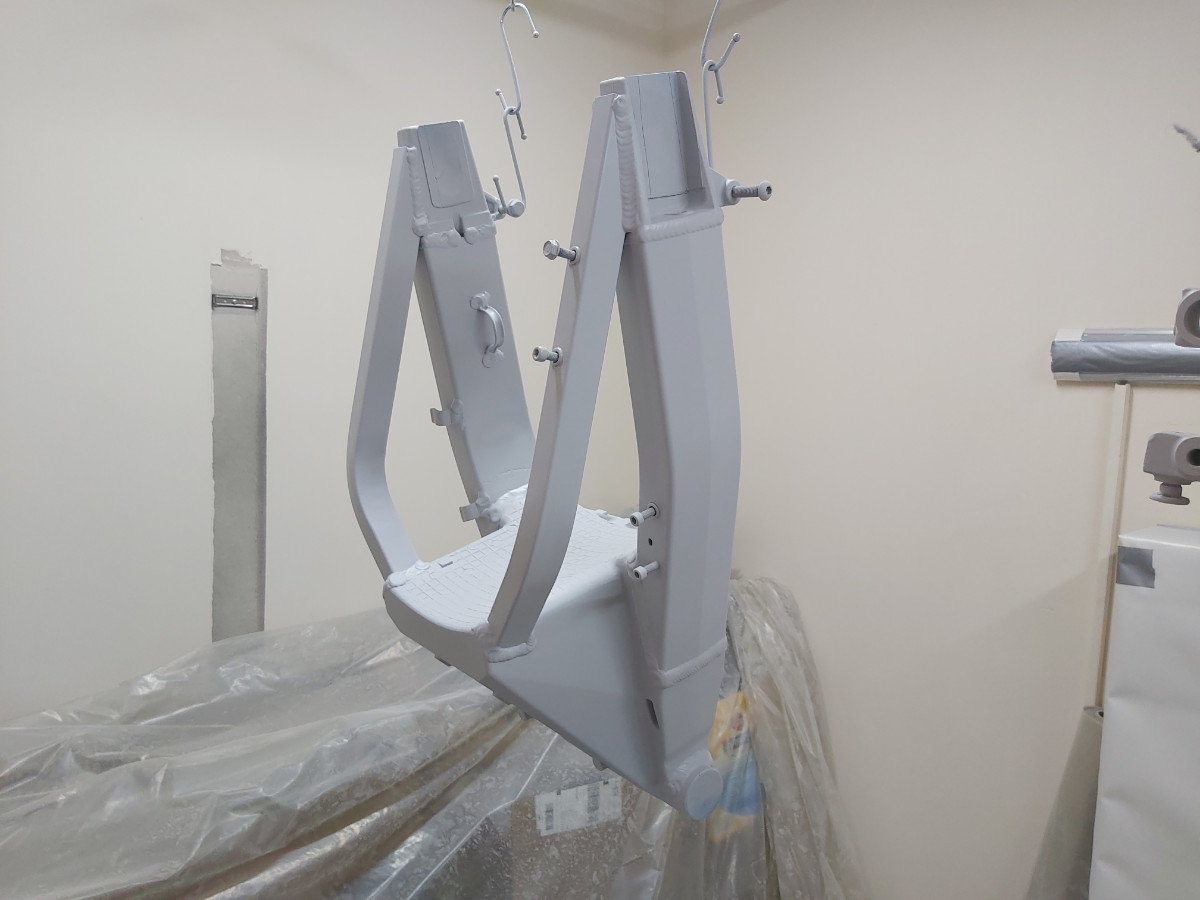

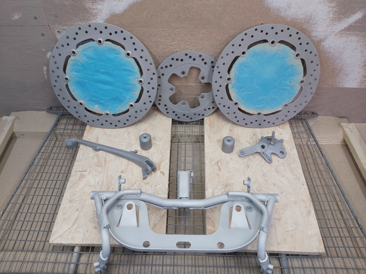

I'm getting there slowly, But im getting there.
Every parts will be as good as new or better when there finished.
Just the finishing coats left to do on them.
Once the parts are finished, i can then carry on with and finish the main frame and swinging arm.
It will then just be a case of fitting all the parts to get my rolling chassis.
For the moment i will be using the spare set of wheels from my other Hayabusa.
I will hopefuly be looking for a 99/00 Hayabusa parts bike from October.
primer 1.jpg (390.26 KiB) Viewed 3355 times
Primer 2.jpg (148.27 KiB) Viewed 3355 times
Primer 3.jpg (159.19 KiB) Viewed 3355 times

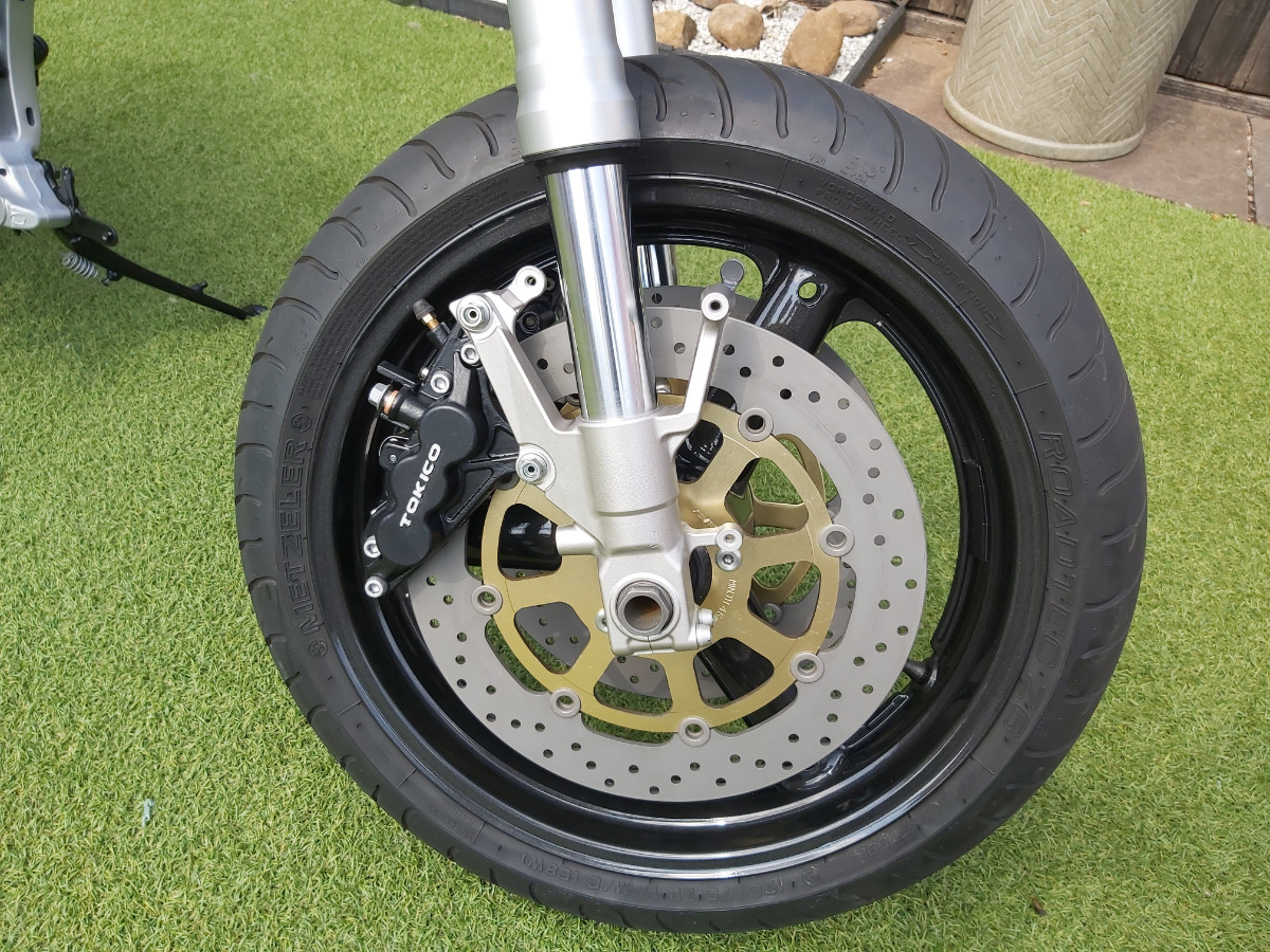

Posts: 1122
Has liked: 154 times

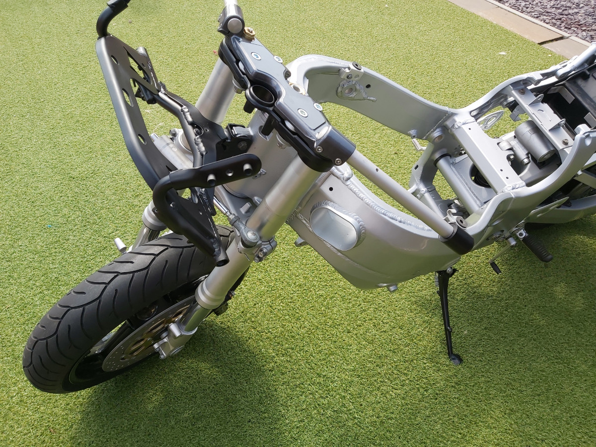

Well this were im up to. i just need to find a donor bike now.
