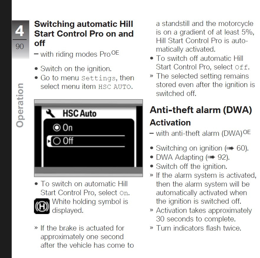

Re: Can you turn off the hill start control?
From Page 90 of my manual, but don't forget you can't access settings on the move.
- Hill Control - 1.jpg (210.74 KiB) Viewed 769 times

Forgive my ignorance, but this is my first BMW.
HSC and HSC Pro the same thing? When I read the manual I had the impression that they were two different systems and I had the former.
That page also mentions 'Riding Modes Pro' and I haven't the faintest idea what that is or whether my bike has it.

Don't quote me on this but I think the difference between Std HSC and HSC Pro is that Pro engages automatically on a slope whereas as Std has to be set manually by squeezing the brake lever. If you're finding HSC is a pain because it's coming on automatically then you've got Pro.

Just ventured into the garage and into the menu settings, and found I had the HSC Pro, so I could turn it off.
