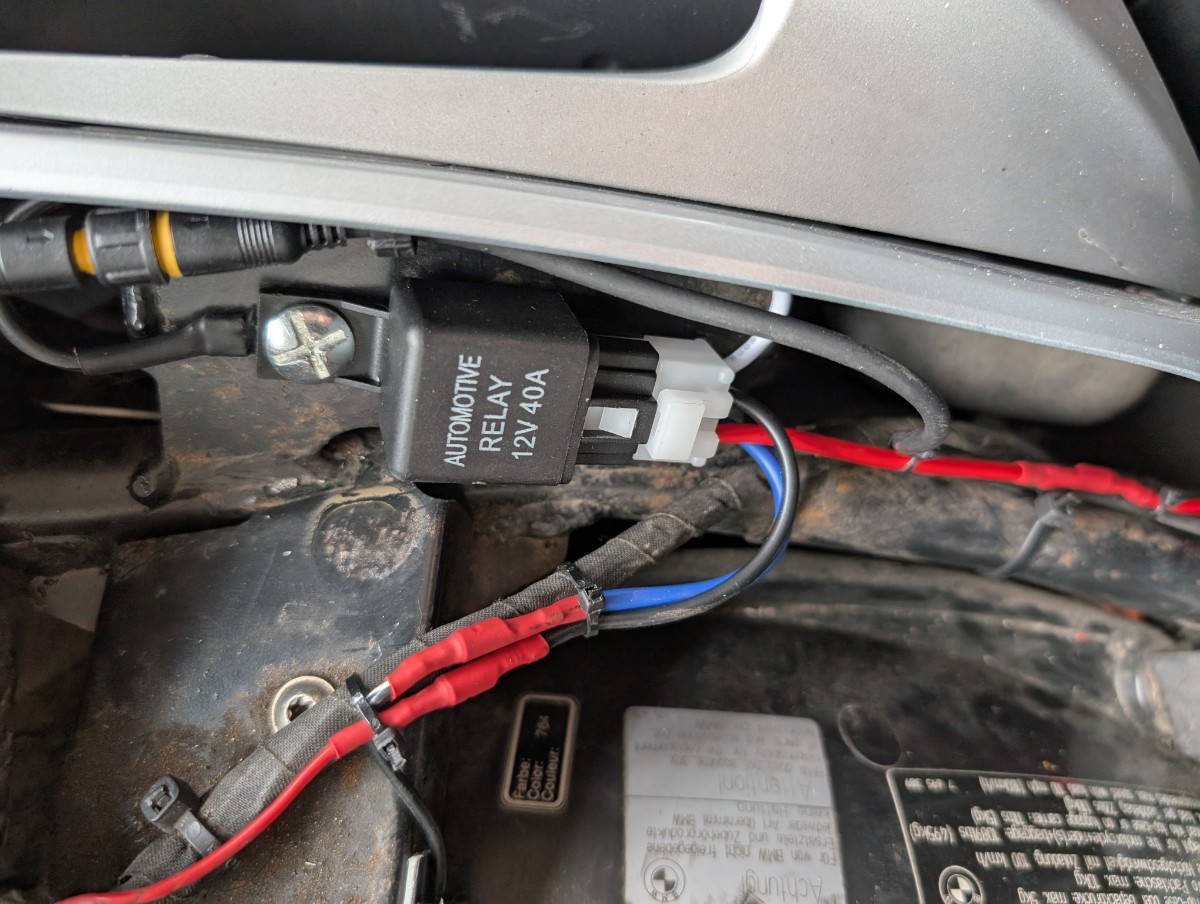

Thanks Stu. So theoretically if I use the accessory circuit to throw a relay and run the display via the relay we should be good?
I've timed it with the Aoocchi in and out of the circuit. 55 seconds to off with no load. 19 minutes with the gadget in line.
Re: Aoocchi C6 Pro delay off
Yes I believe that would work
It's all about lowering the draw on the auxiliary circuit

Agree relay is the way to go for an inexpensive solution, On my previous RT (2016) I used the Aux socket as the switch feed until I invested in a ezCan

All done.
£6 for two off Amazon.
Works a treat.
