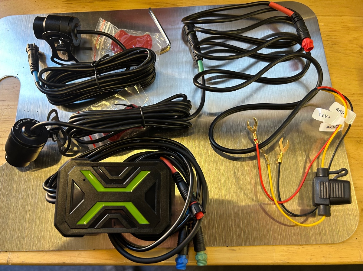

Have attached pictures.
First image is the installation instructions that came with the DVR.
Second image is the wires from the DVR. Yellow to battery positive, black to battery negative and red to switched live (picked up from the additional lead plugged into the back of the accessory socket. The lead I purchased connected to the rear accessory socket and has two wires extending from this to a BMW plug so I removed the plug at the tail end and have connected the live wire out of the two (ground and live) to the red wire on the DVR. You don't need the earth connection on this wire because it's taken care of with the battery connection.

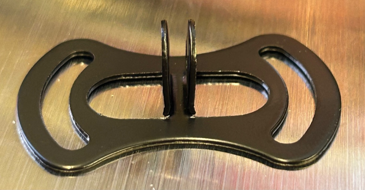

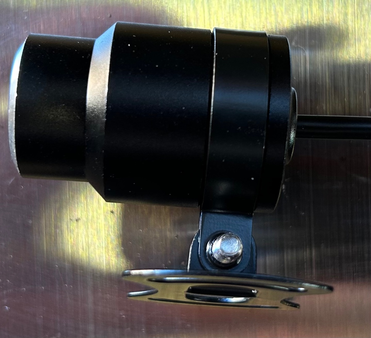

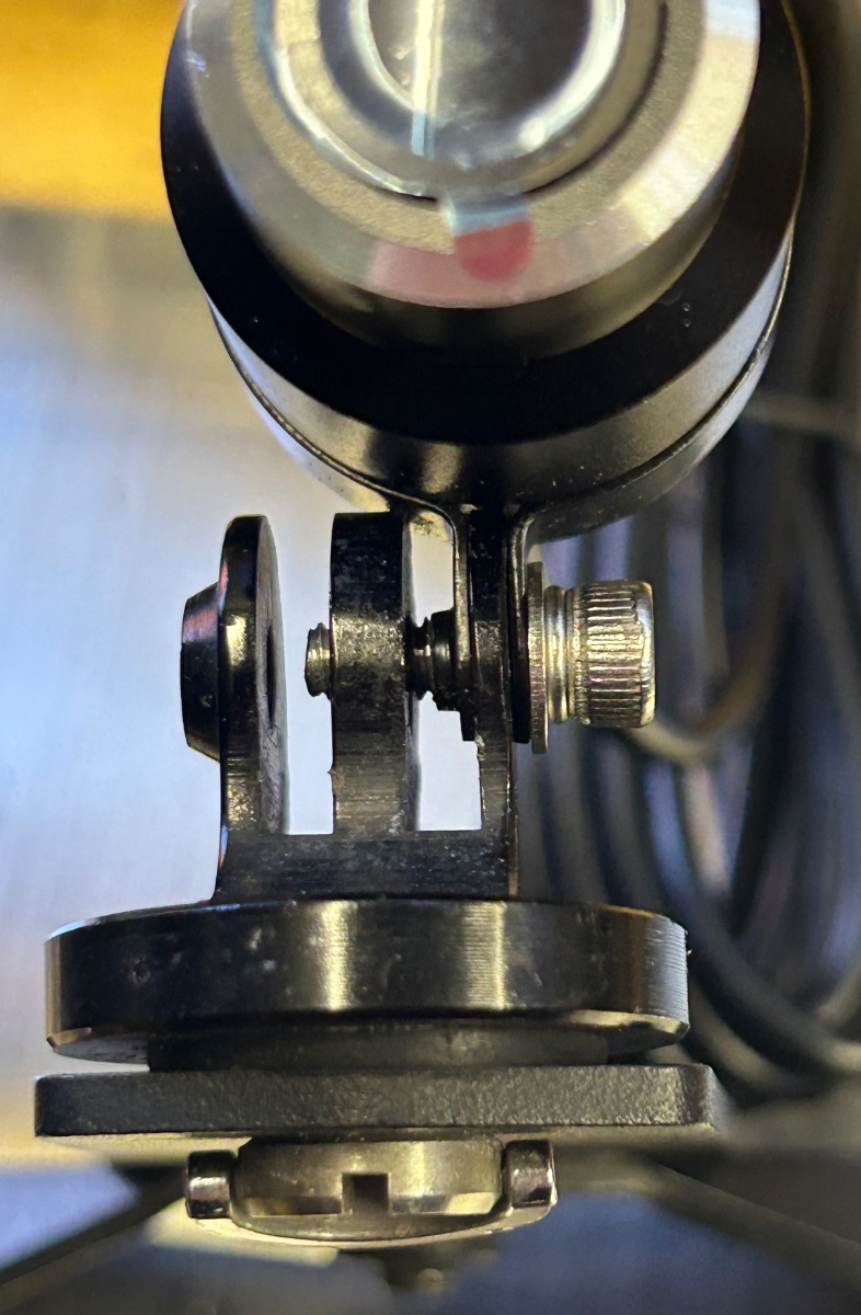

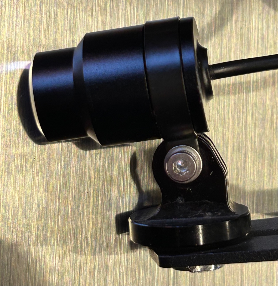

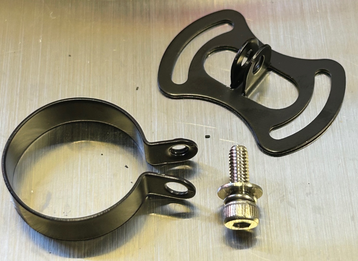

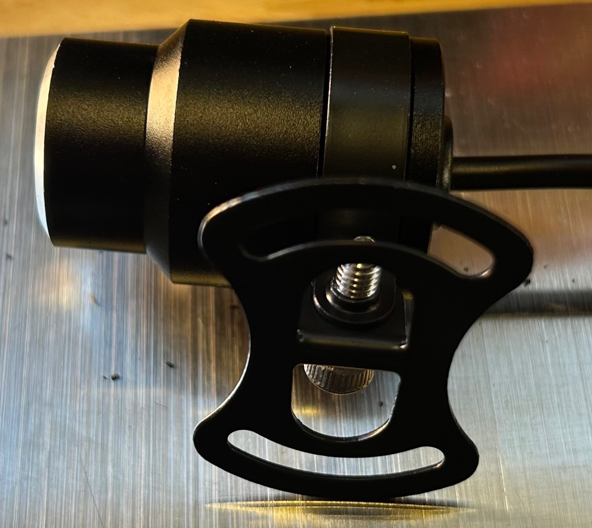

Just some pics for information. The cameras and mounting brackets are different from those shown on the web page. I’ve managed to attach one to a GoPro mount for the front, will work on the back one later.
