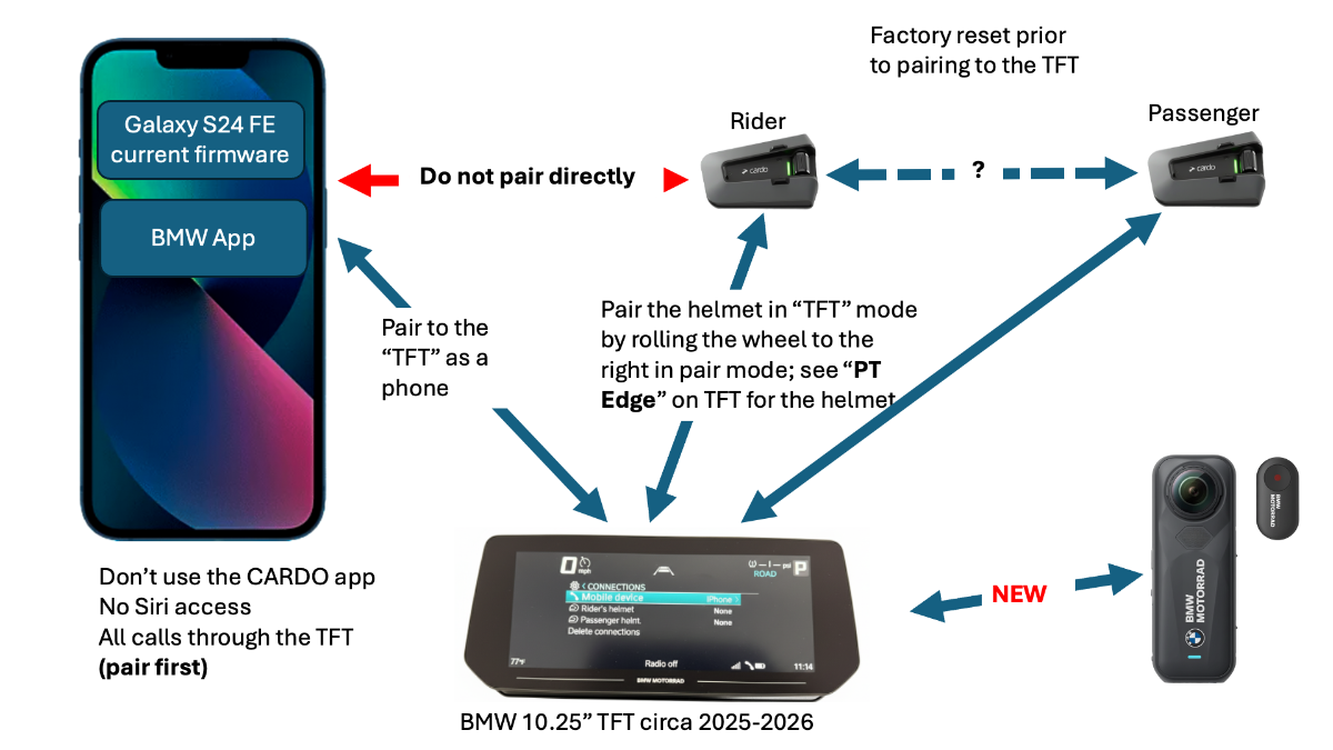

Here's a diagram of my comm hardware:
Me and Wife.png (411 KiB) Viewed 1580 times
I'm seeking suggestions regarding:
  • How to configure the connections so we have intercom
    Mesh ability to other riders using Cardo
    Should the passenger Edge by sync'ed to the TFT in "TFT mode" or "Phone mode?
Thank you!
Cheers, Jim
Re: Cardo Edge connections to TFT
The cardo mesh has nothing to do with the bike and phone and is totally separate
No matter how you connect to the bike and phone the mesh will still work normally
I have never heard of TFT mode for connecting to the headset! You have phone or GPS
I would try both and see how it is although I suspect phone will work for you
