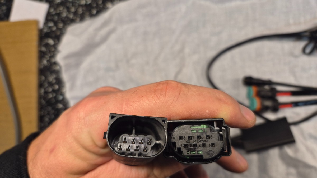

Instead of clipping in to the Nav prep mount this plugs in to the back of the instrument cluster
it improves the control on a mobile device

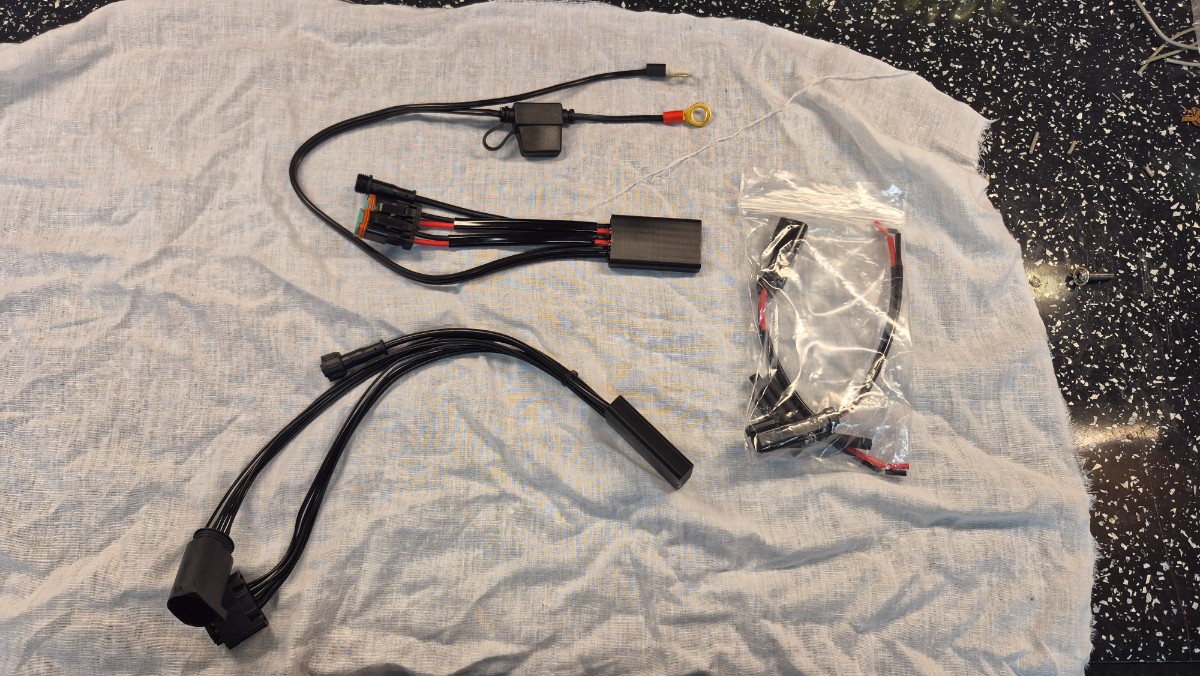

The main part is the one in the lower half of the photo
It plugs in to the instrument cluster by removing the main wiring to the cluster and replacing it with the corresponding plug and the wiring for the cluster plugs directly in to the other side of the wiring loom

There is also an accessory controller too which is pictured in the top half of this picture

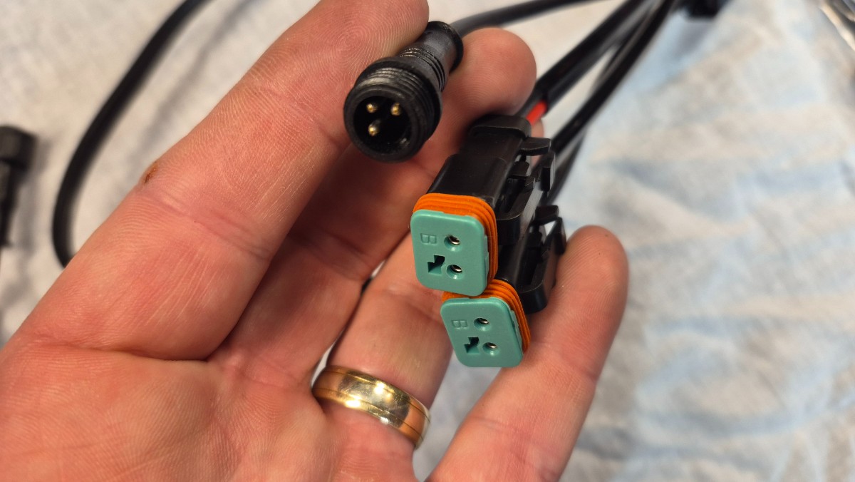

This allows you to control up to two accessories fitted to the bike ie spot lights which can easily be turned on with the WunderLINQ switch

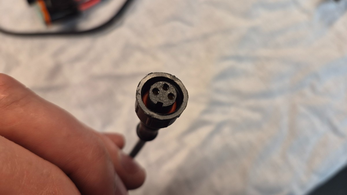

This connects up to the WunderLINQ switch via a round plug that screws together and comes with an extension lead so you can position it close to the battery
It also comes with two waterproof connecters to easily connect any accessories you wish to use
