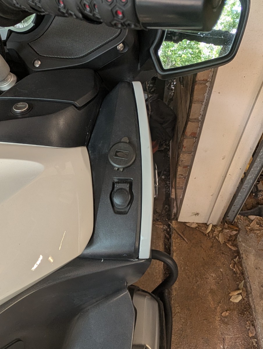

I just had the 2 plastic tabs on my right front side fairing pannel break. Other than buying a new pannel I am looking for a good secure fix for repairing the tabs. YouTube has several. Some don't look too strong. Anyone have a method that worked for you?

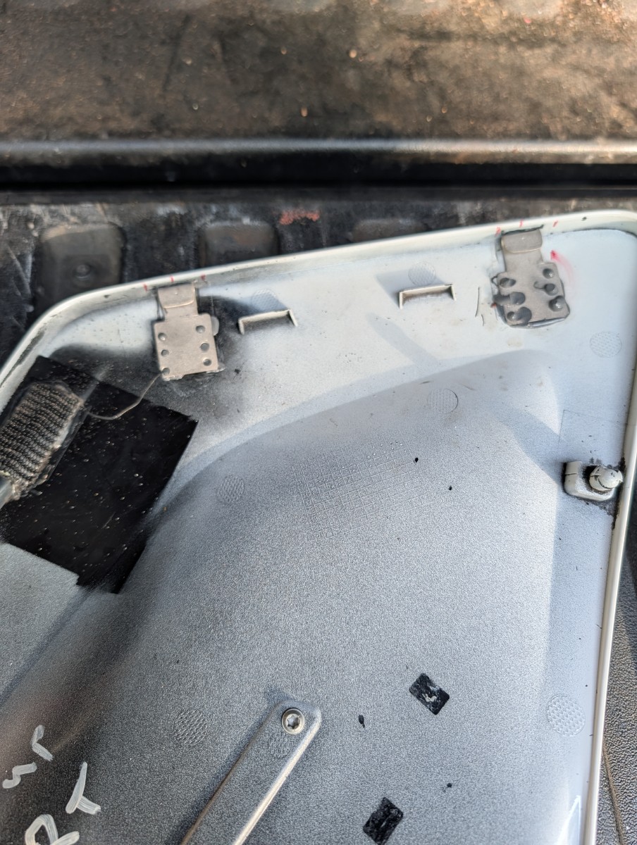

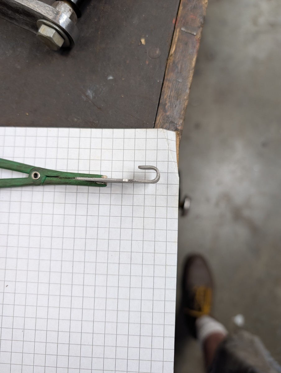

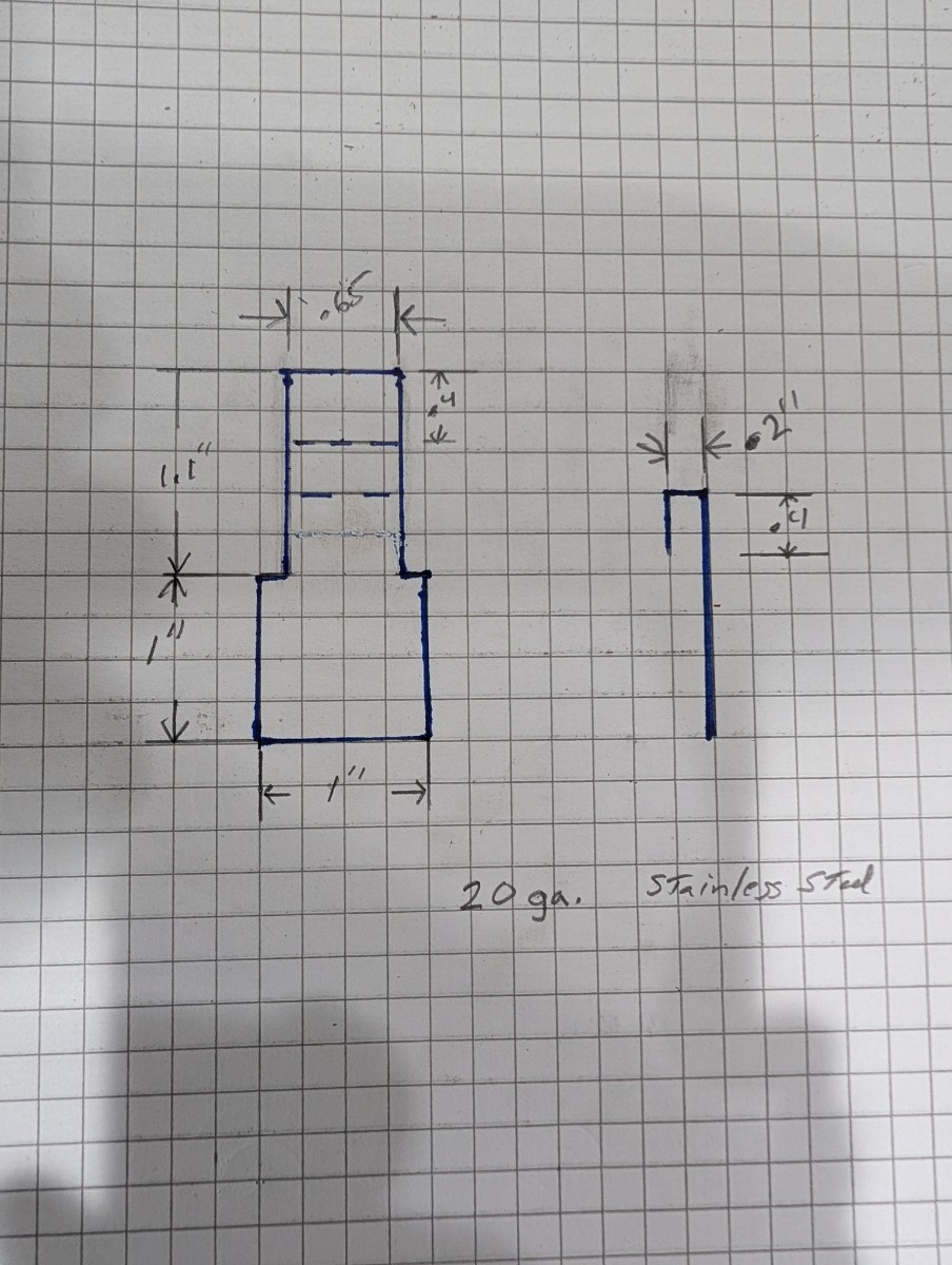

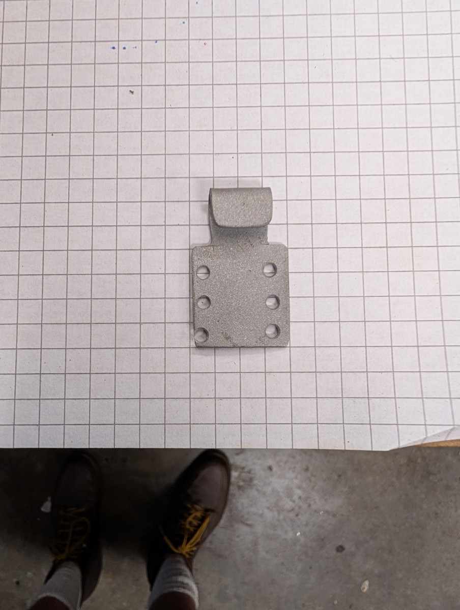

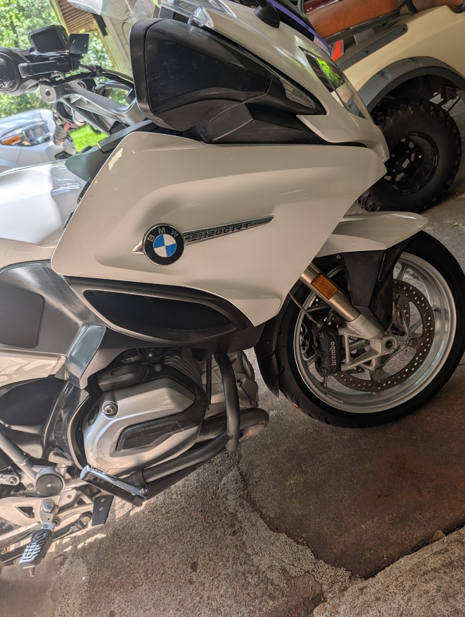

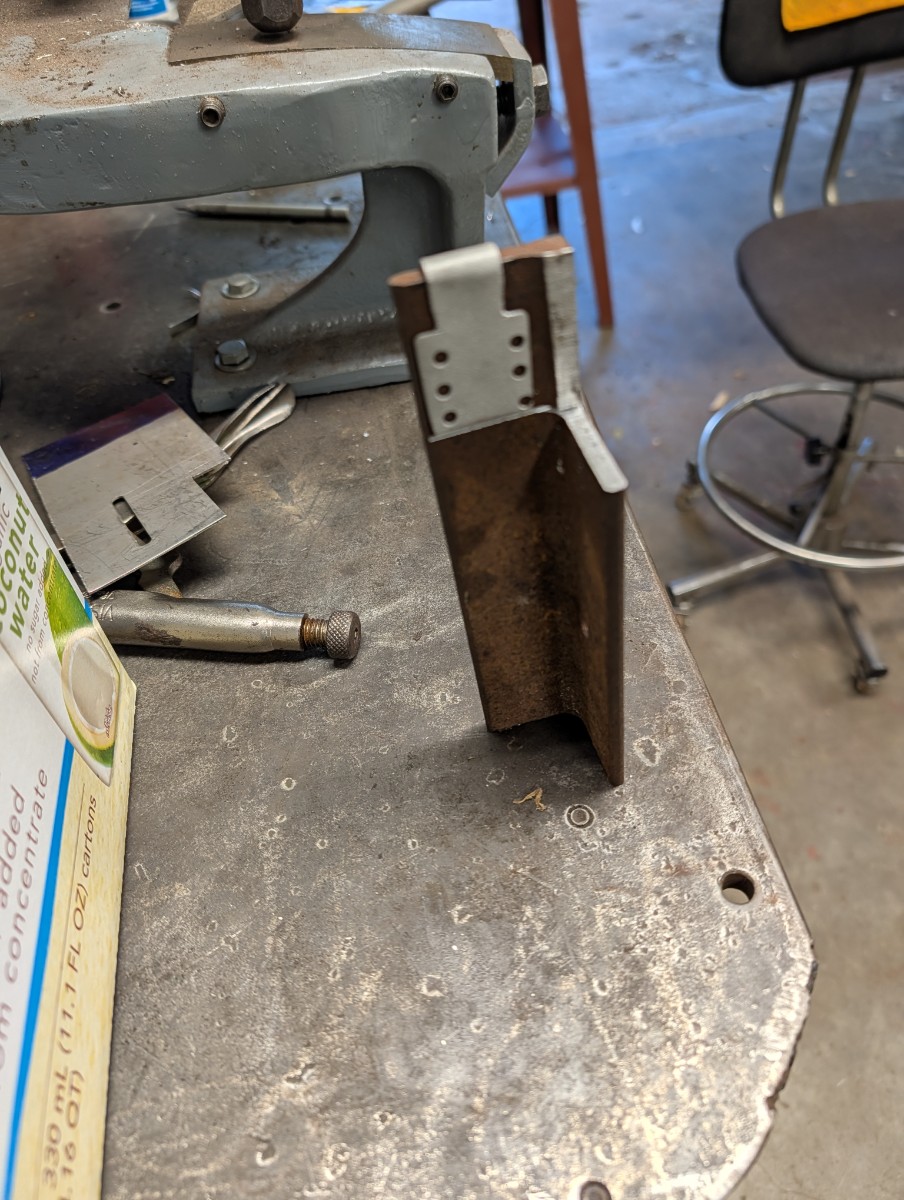

I fabricated a solution. I bent some 20 ga. stainless steel into a suitable shape and JB welded pieces to the pannel. They are strong and everything fits like stock. Here are some photos.
Sketch
Sketch
Top View
Top View
Side view
Side view
Glued in place
Glued in place
Installed- top
Installed- top
Pannel instaulled 1
Pannel instaulled 1
Bending Fixture
Bending Fixture
Re: Fairing Tab Repair?
Cracking job you've done there. God loves a bodger.

Nice work. That JB is good stuff, albeit it STINKS when you mix it.
