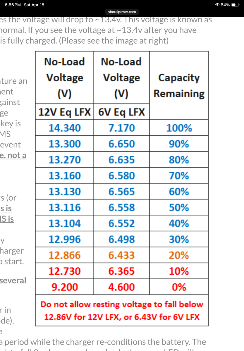

12.5 volts seems very low for a lithium ion battery. I would start with the battery. Here is Shorai’s charge vs voltage chart.
