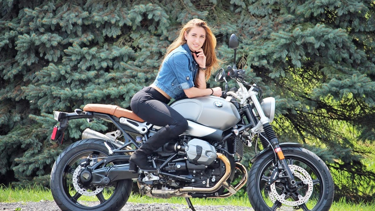

BMW R nine T Scrambler
The Bird might be a parallel twin, but the Bike is definitely a boxer (opposed) twin.

Like the bird! ^-^
But it would be possible to do the same thing with the boxer, right? That is, having the cylinders fire in such an order that the boxer twin sounds more like a V twin?

You mentioned a BMW R 9? Where is it? I don't see any bike
