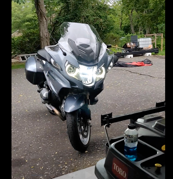

When i got my 2014 RT, it was preowned and i was the third owner... From what i've heard, first owner programmed with ESYS the new button and function... Basycally, when i pressed the fog light switch, my halo would go from 50% bright to 100%, but i had to manually turn the main Headlight after bike had the engine running by holding: Cancel turn signals for 5 seconds, then > Hold right turn signal for another 5 seconds.
This is how my button used to work, but after i took my bike to BMW dealership for a major service, they accidentally wiped that feature out when they updated the bike software... Dealership cant program this, only people who do coding with a software called ESYS...
