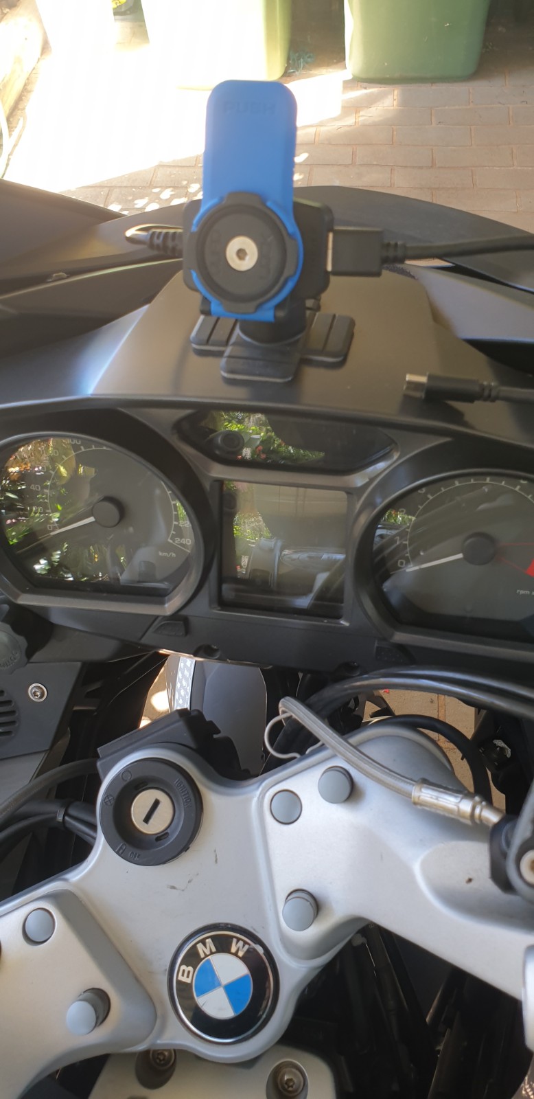

Install a quad lock and simply use Google Maps... Costs about AU$115 including new phone case, so about 60 quid I'd imagine (unsure of exchange rate there after recent Liz issues).

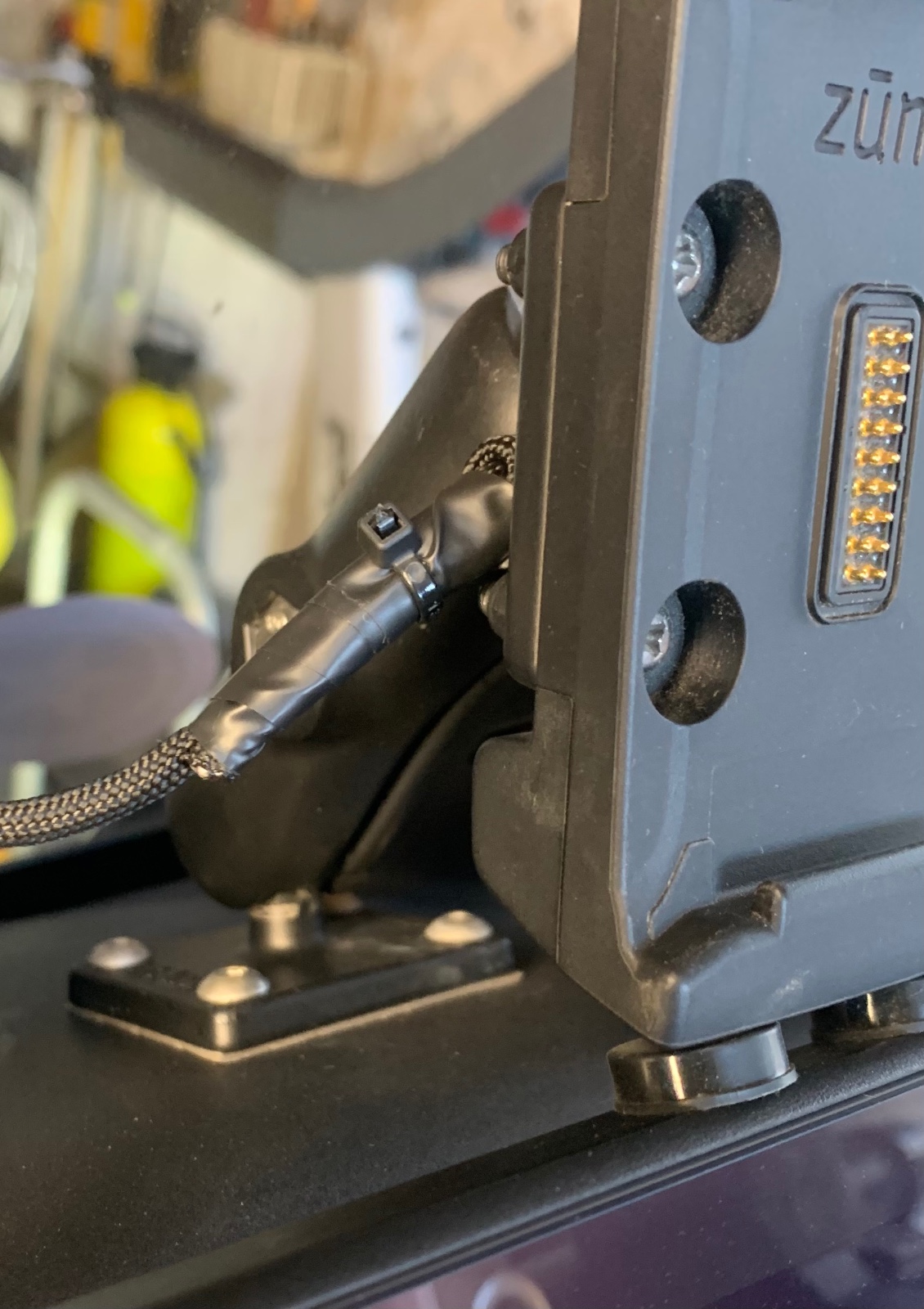

This is my solution to a GPS mount for my Zumo590.
Having totally sorted this, my phone and the bike started talking to one another fluently at last but I'll keep the solution in place anyway. The unit rests atop the AV pads on the top of the tft and puts the GPS in my eyeline beautifully. The (lockable) ram base is held ultra securely by 3M VHB adhesive tape and the bolt heads are dummies to hopefully deter any wee oik who wants a freebie off the bike - so no drilling and the tape never leaves a mark. I've used VHB for donkey's years and it's never let go even with a brick like camera on it at ridiculous speeds but I still use a tether just in case! The setup renders zero bounce/movement in the GPS and it doesn't seem to be stressing the tft either.

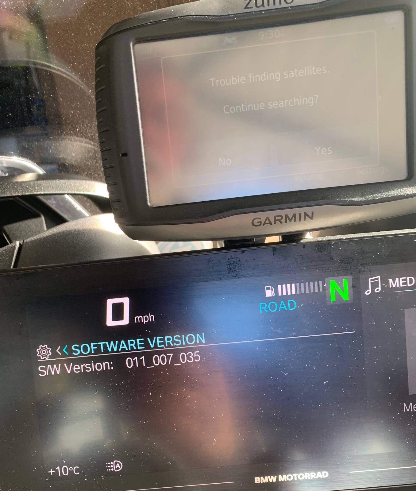

I have mounted a zumo xt above the tft, same as your 590. I get interference from the tft which results in loss of GPS signal. Is this a problem with the 590? It seems the loss of signal is a common problem and I'm looking for a way to minimise it.
Gary

You might have touched on something there!
It takes ages for the unit to acquire signals when it's mounted on the bike and yet when I slip it off for a second it suddenly gets the signal no problem.
While I'm riding it often loses the signals for them to return a couple of minutes later.
I'm wondering where any interference might be coming from and how I can stop it. Don't really want to put one of these on the tft!
Don't really want to move the unit as that would take it out of my eyeline.
If you think of a solution would you let me know please?

Re: 2021 Nav system alternate.
There is a company in the states that makes an RF shield which would fit the sat nav mount above the tft. However, despite two emails I've not had a reply asking if they ship over here. Still looking for a solution, but in the meantime I have a ram mount on the handlebar assembly replacing the bmw logo. Not as good as above the tft but acceptable as it's only used as a back up.
Could it be FMS accessories, search for BMW Navigator GPS RFI Shield.
Then you need to go careful on how you shield I otherwise key may well not be picked upExcellence wrote: Thu Nov 24, 2022 3:40 pm Yes I have keyless. I'm going to search for that shielding firm.
You will need something to stop RFID I believe
Something like this might be worth a punt for testing purposes
https://www.ebay.co.uk/itm/264603462216 ... media=COPY
