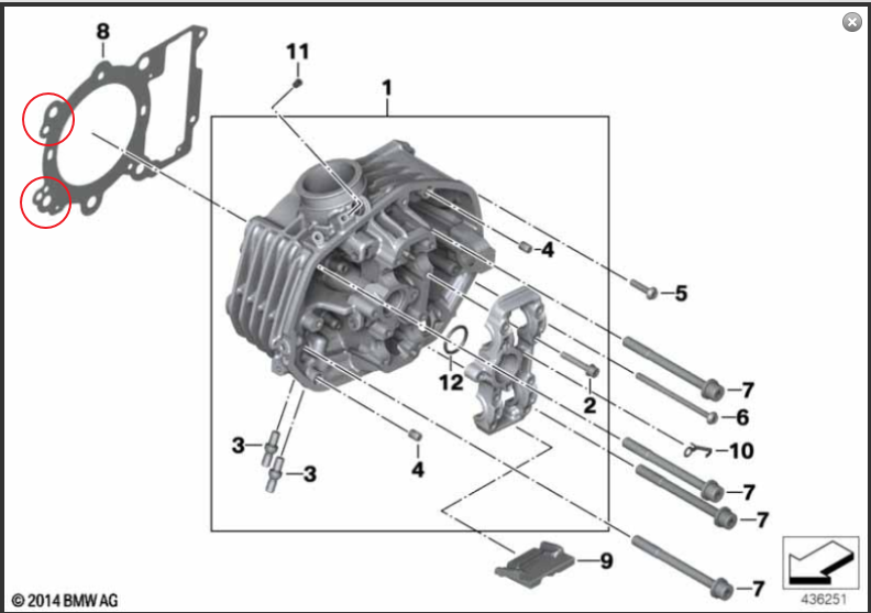

The two parts circled are different so it can only go one way

That's the answer!!    Thanks so much guys!!!!!!!!!!!!!!!
