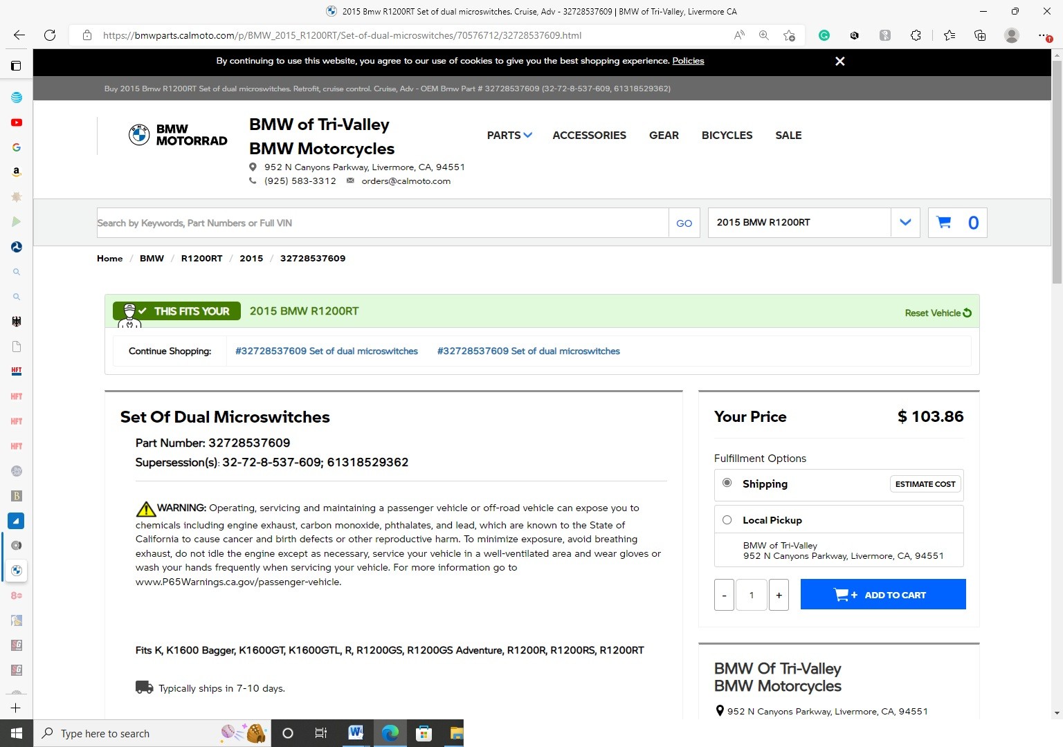

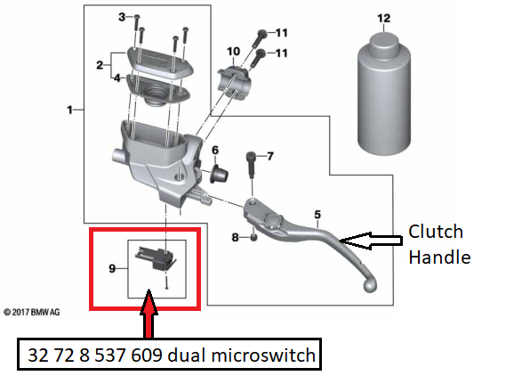

The BMW part number for the 'dual microswitch' is: 32 72 8 537 609 and BMW charges $103.86 for this dual microswitch which is used in 67 BMW motorcycle models/years. This dual microswitch controls both the engine starting sequence along with cruise control functionality.
In researching this symptom, I discovered this is due to the 'dual microswitch' failing that is located in the clutch lever area on the left handlebar.

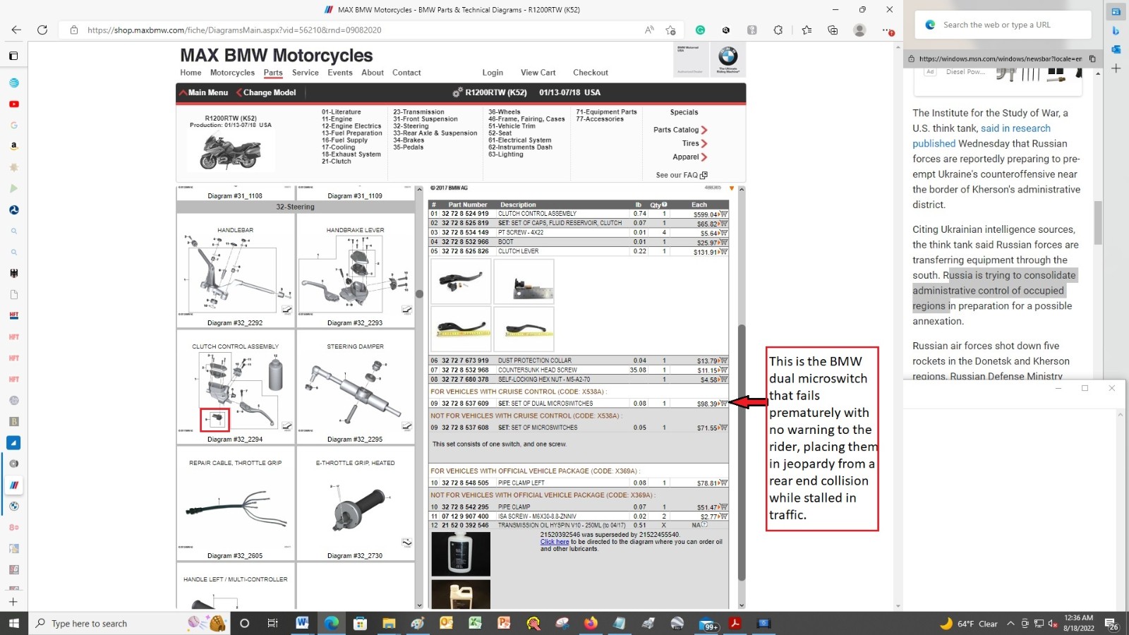

I also found others who have experienced this same problem around the same mileage on their RT's. This seems to be a systemic problem that BMW should address with a factory recall as it presents a very serious safety issue when an RT should stall in traffic,,,, which happened to me and almost resulted in a rear-end collision from an SUV distracted driver. I filed an NTSB Complaint 11479890, filed on 08/18/2022 as premature failure of this part may result in a serious collision risk to the RT rider.

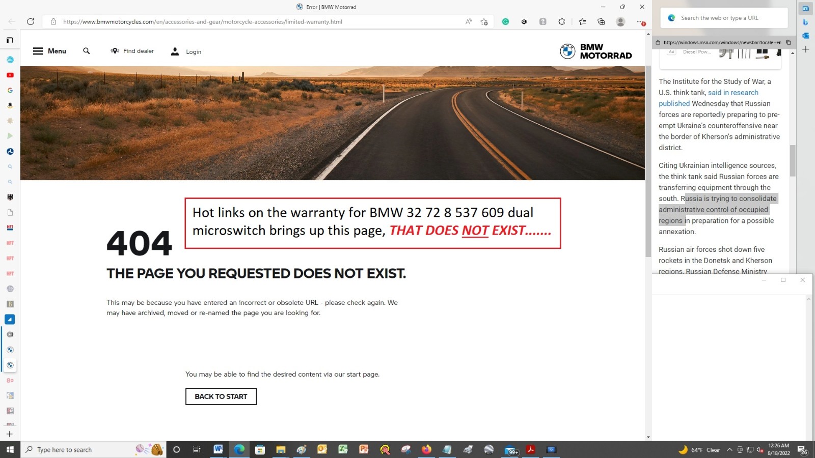

BMW hot link to the warranty is a dead link
blank warranty page 32 72 8 537 609 microswitch_17Aug'22.jpg (236.65 KiB) Viewed 822 times

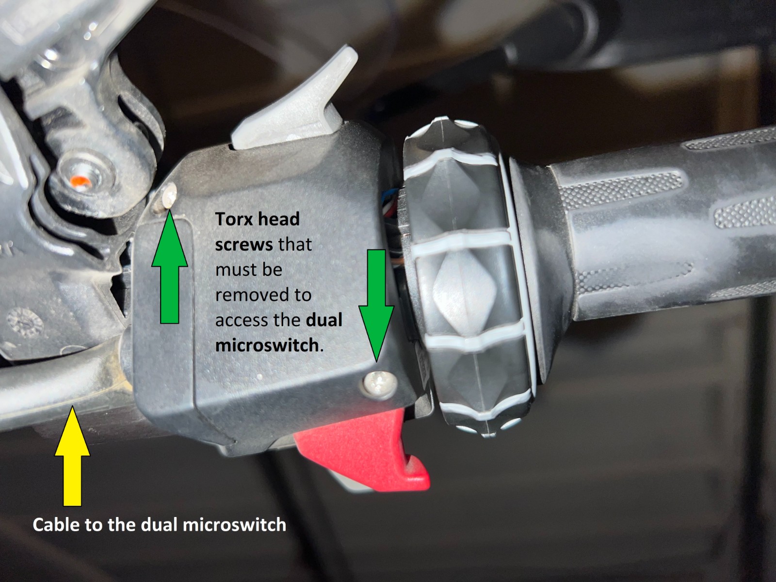

Clutch switch torx screw heads_19Oct'22
Clutch switch torx screw heads_19Oct'22-3.JPG (331.81 KiB) Viewed 826 times
BMW dealer price for dual microswithch_17Aug'22
Cal Moto - 32 72 8 537 609 microswitch_17Aug'22.jpg (240.09 KiB) Viewed 826 times
BMW image of microswitch assembly
MAX BMW Motorcycles - 32 72 8 537 609 microswitch assembly.png (80.84 KiB) Viewed 826 times
MAX BMW Motorcycles - 32 72 8 537 609 microswitch assembly parts list.jpg (256.17 KiB) Viewed 826 times
