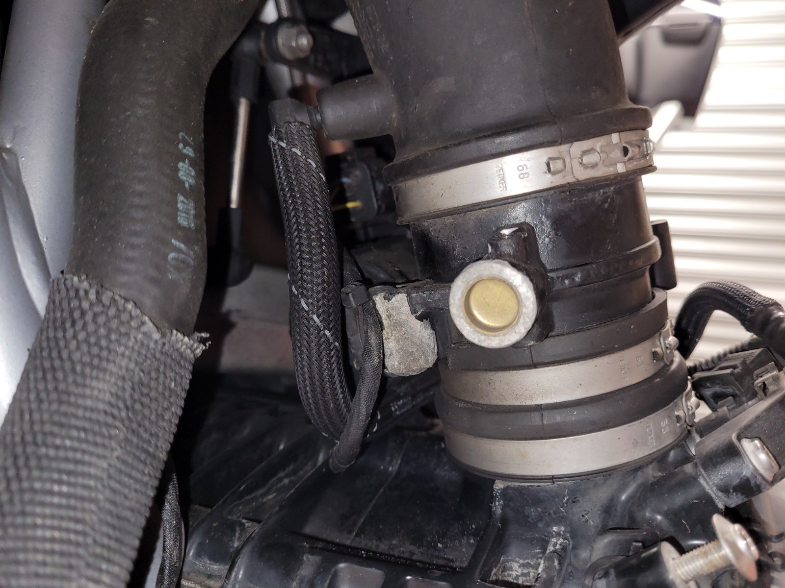

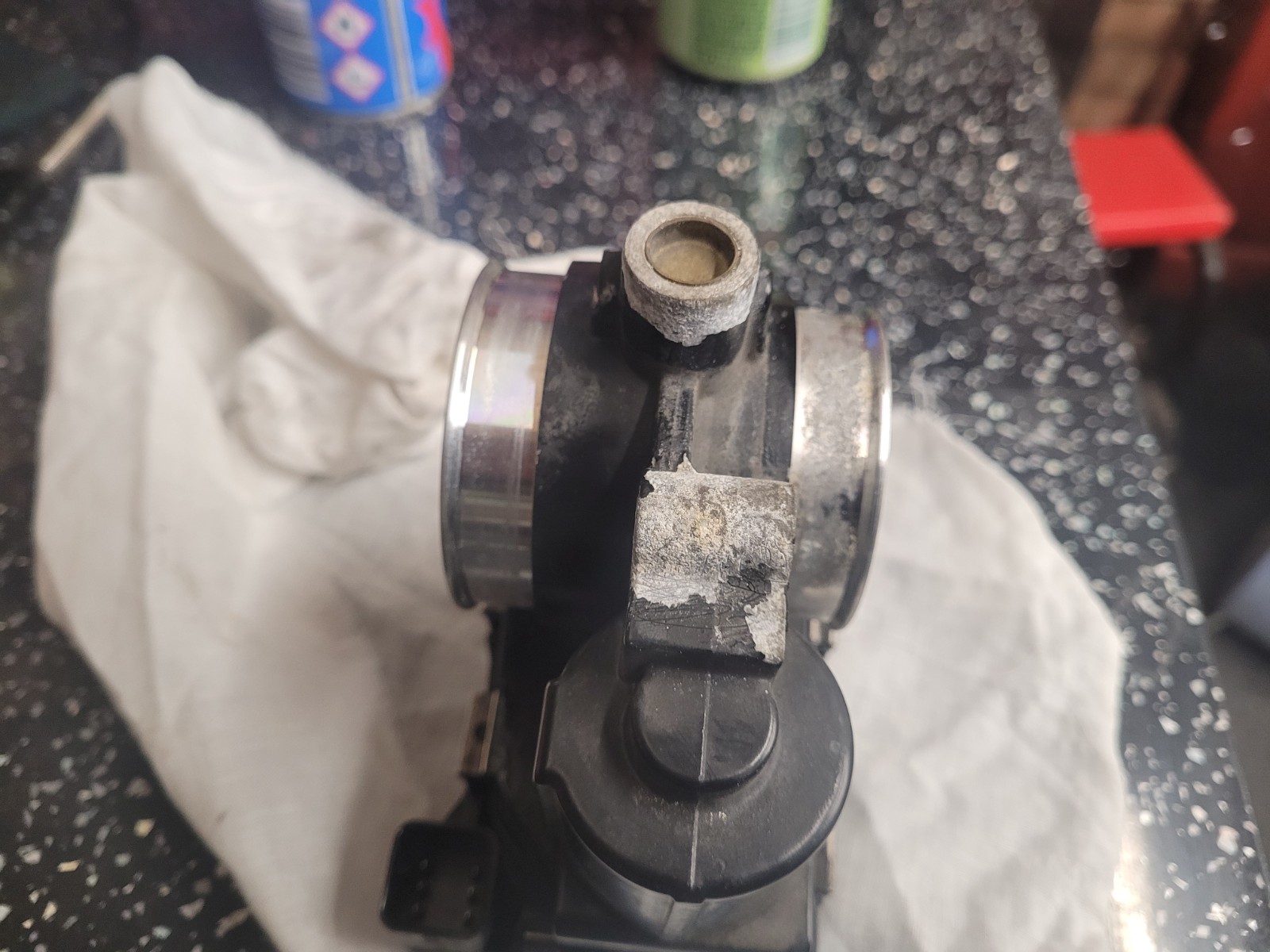

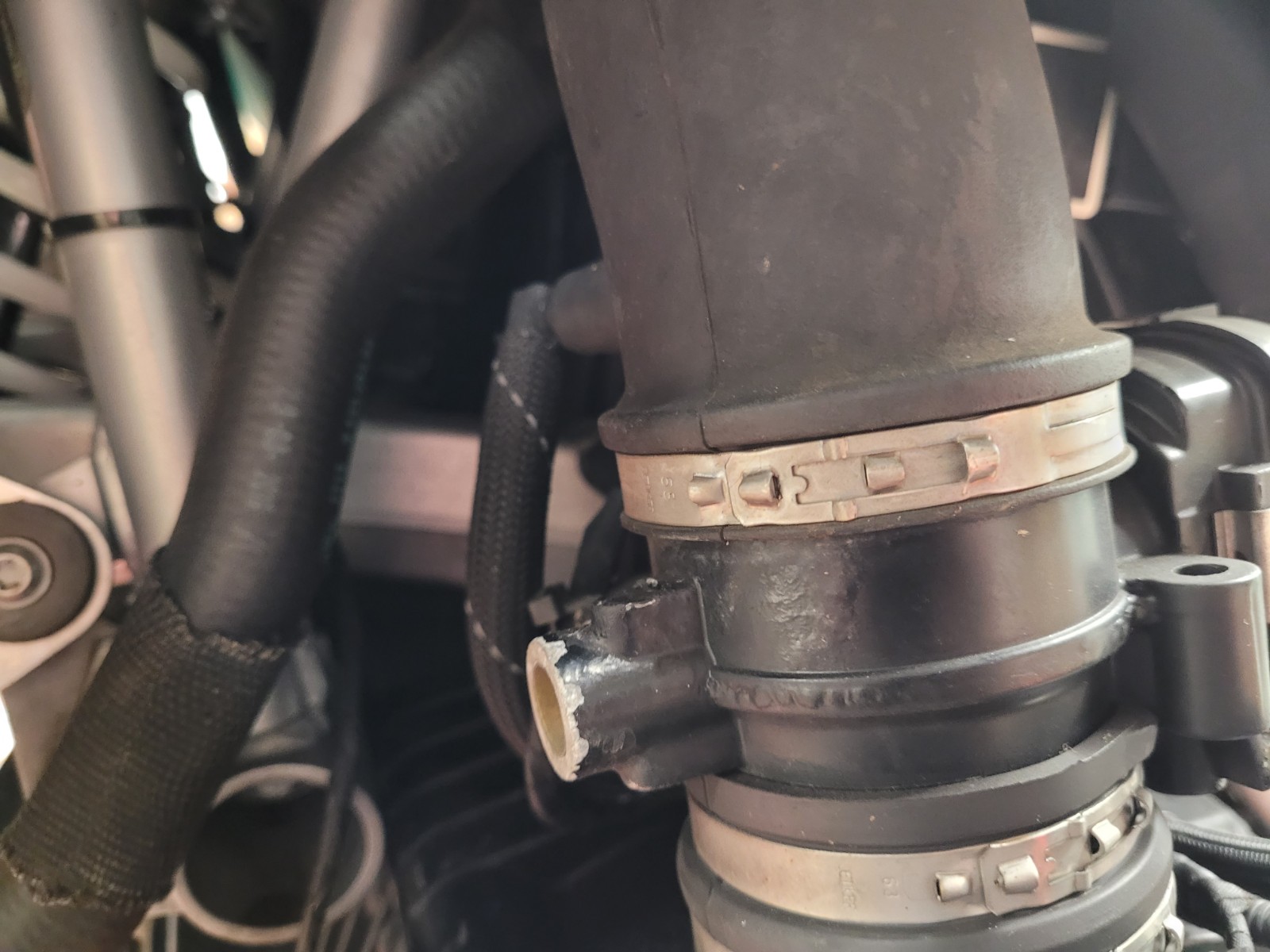

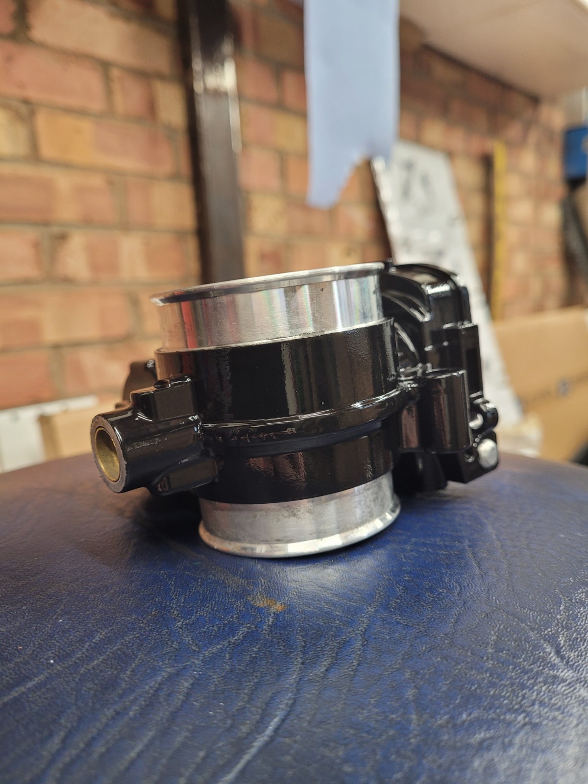

While the bike was on the ramp I noticed that the left throttle body was pretty badly corroded in a couple of places
And to be Honest looking at it I think someone has had a go at it before

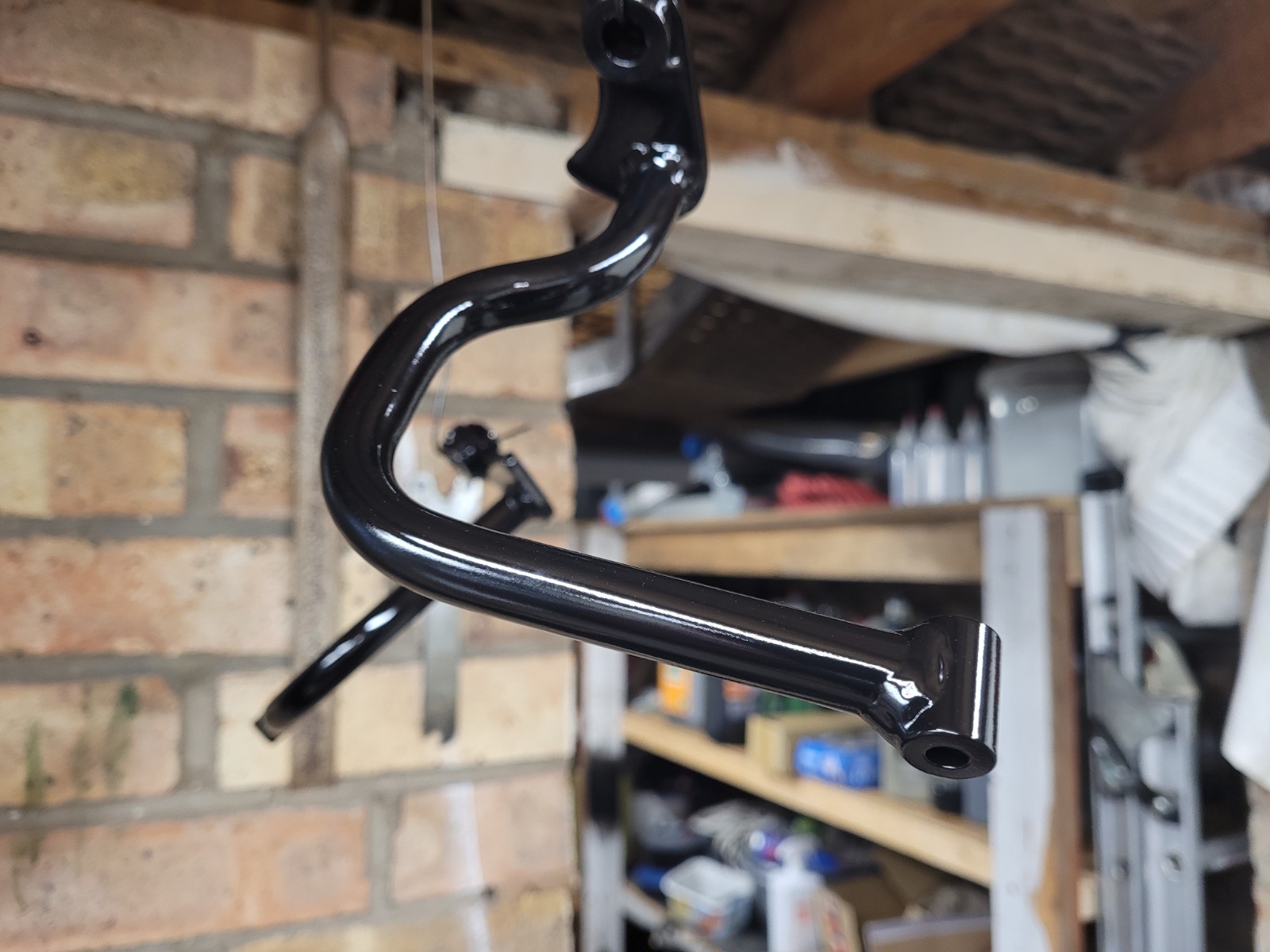

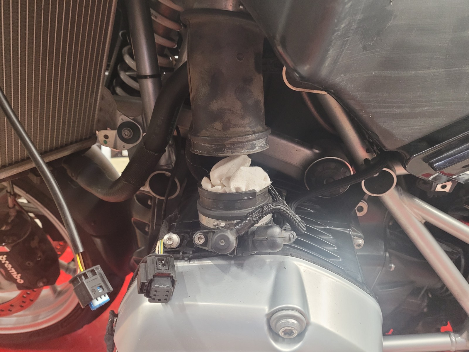

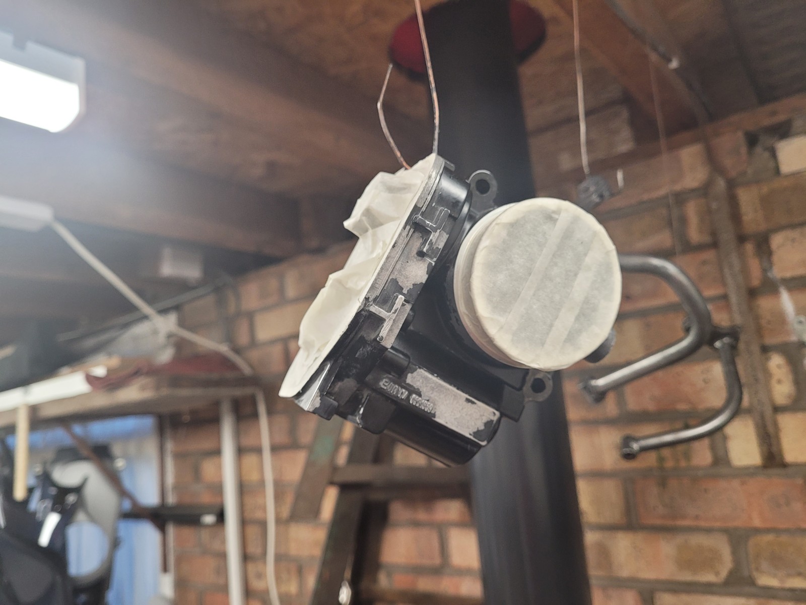

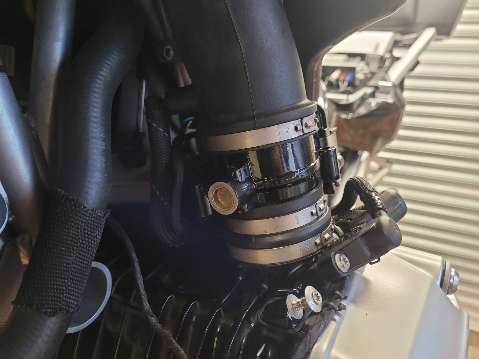

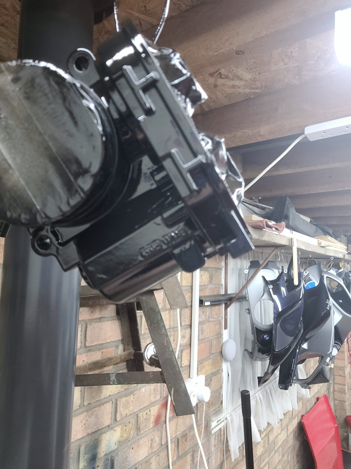

I took the plunge and removed it and removed all the lose flaking paint gave it a sand to rough it up masked it up and gave it 4 coats of black hammarite smooth
And to be honest I am pretty impressed with the result! the paint is a very good match to the original

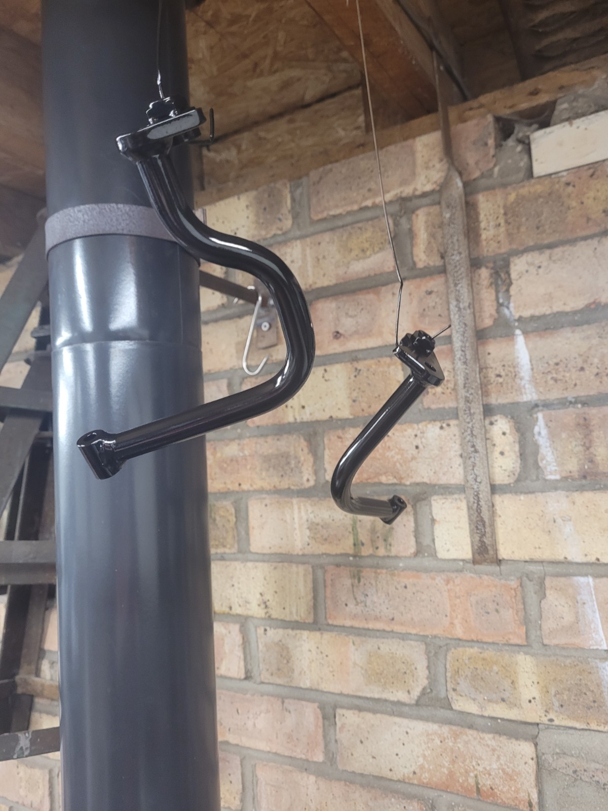

While I was at it I also stripped the spot light brackets as they was showing signs of rust showing through
I was also pleased with the outcome of those too
