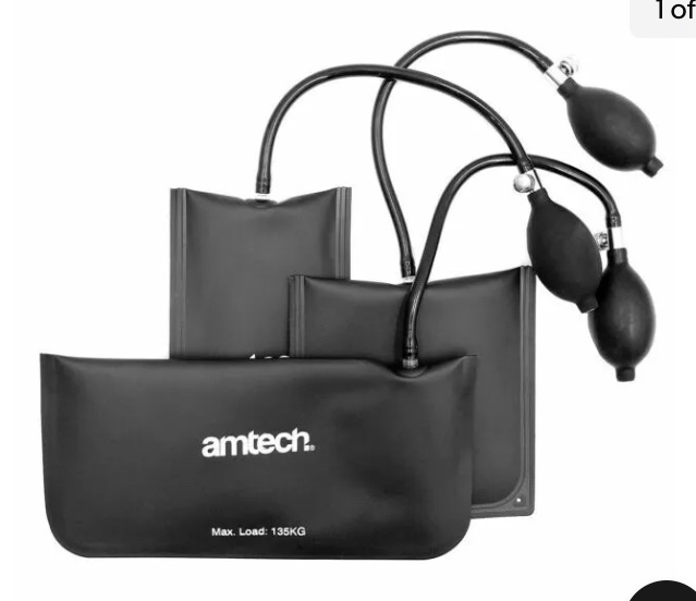

Just a development. I bought these airbag jacks. I've used them and they work really well. About £13 for the three and using the two smallest ones under the front wheel and with both inflation bulbs in one hand only, the back wheel was pushing into the ground after only about ten pumps. They seem tough little monkeys and stow away in the panniers nicely. They'll make it so much easier getting the bike up onto the sump supports so I can take the wheel off if I need to on a ride.
