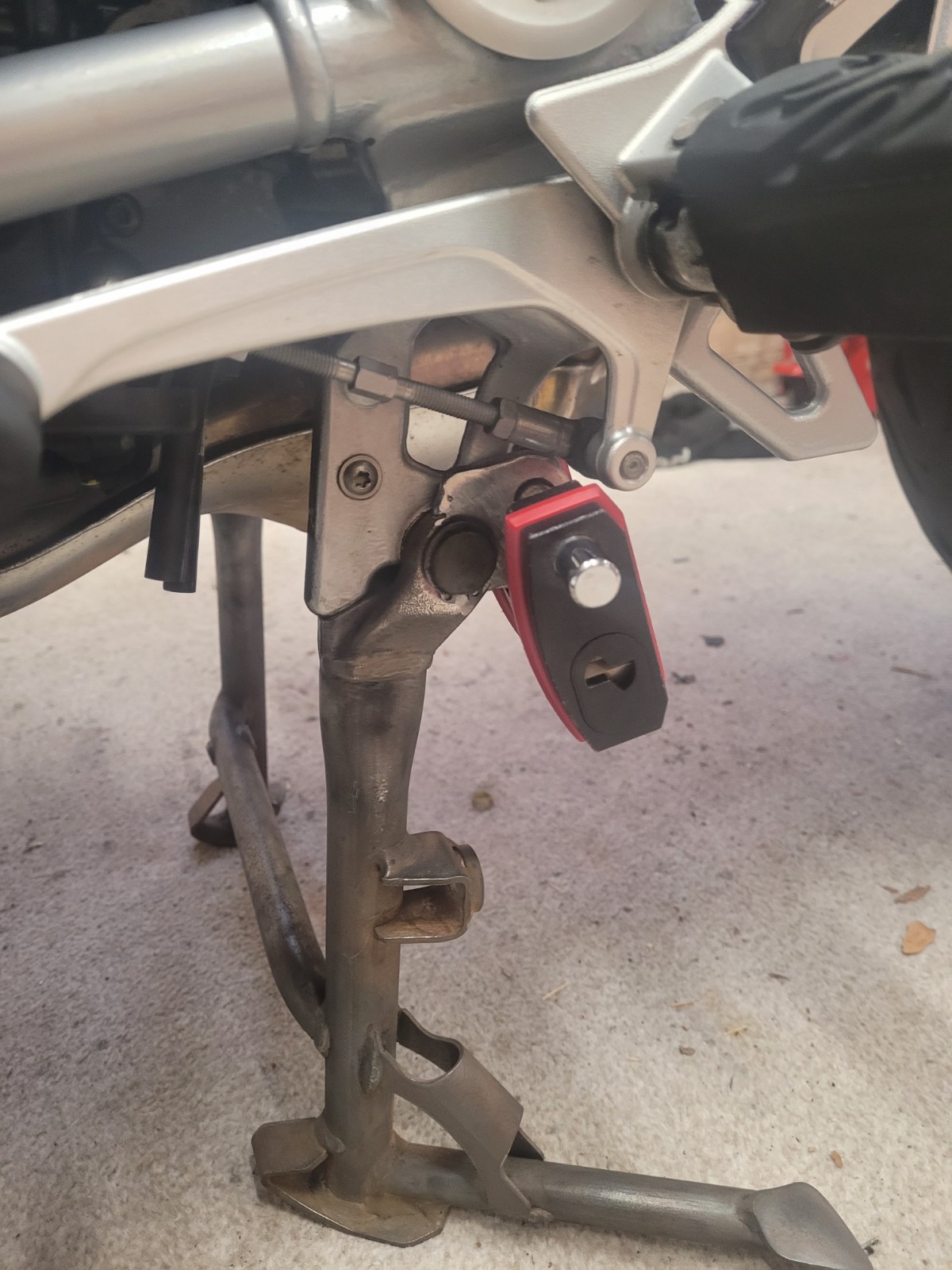

Saw these advertised for sale for the R1200GS
Its a modification to the centre stand in exchange for a lot of money :shock:
It allows you to insert a lock through it so you can't take the bike off the centre stand which I thought was a good idea to stop any opportunist thieves while out touring etc

That's different but I reckon if they give the padlock a goodenuff slap with a hammer it would snap off at the join.Has it been tested in anyway.
Re: Centre stand security
burridge01 wrote: Wed Feb 22, 2023 8:04 pm That's different but I reckon if they give the padlock a goodenuff slap with a hammer it would snap off at the join.Has it been tested in anyway.

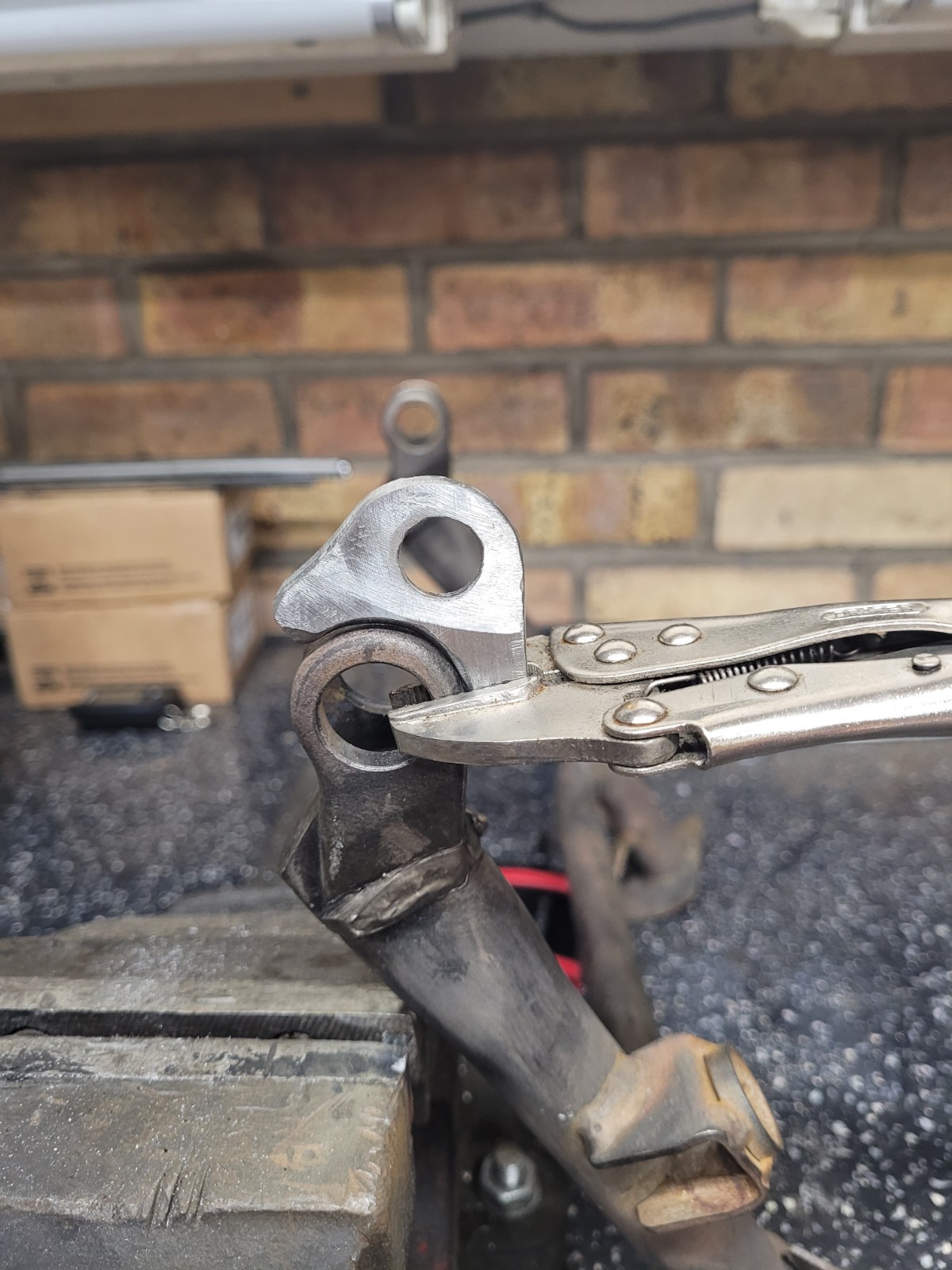

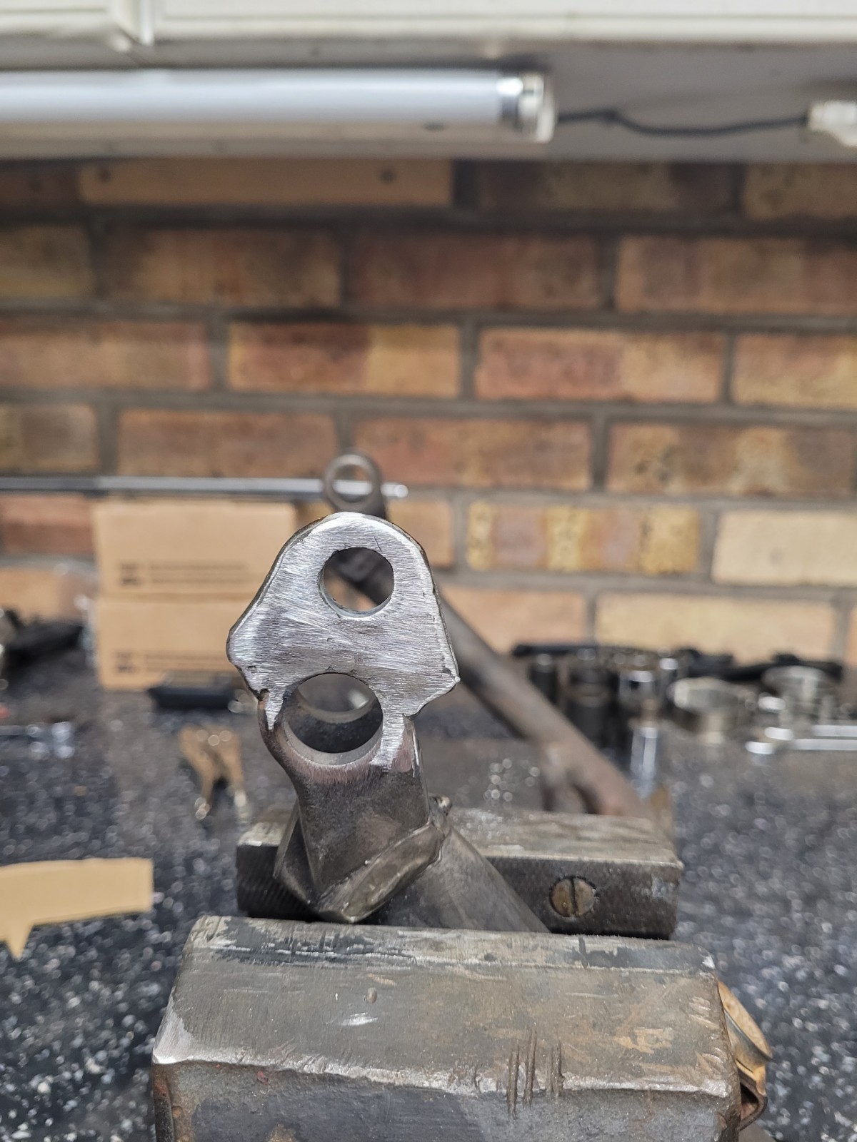

When I tacked it on I had to hammer it straight as it was slightly out of alignment and that was a job in itself!

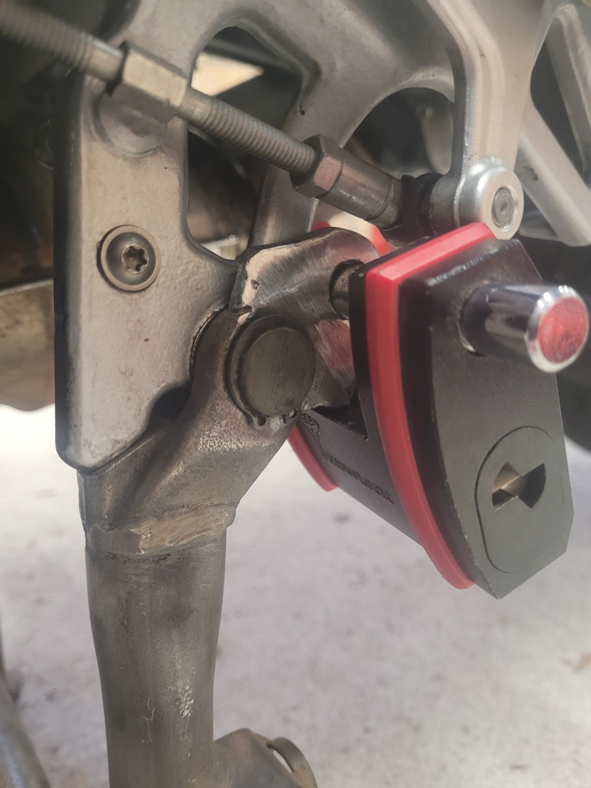

Now its fully welded I really can't see it moving anywhere at all

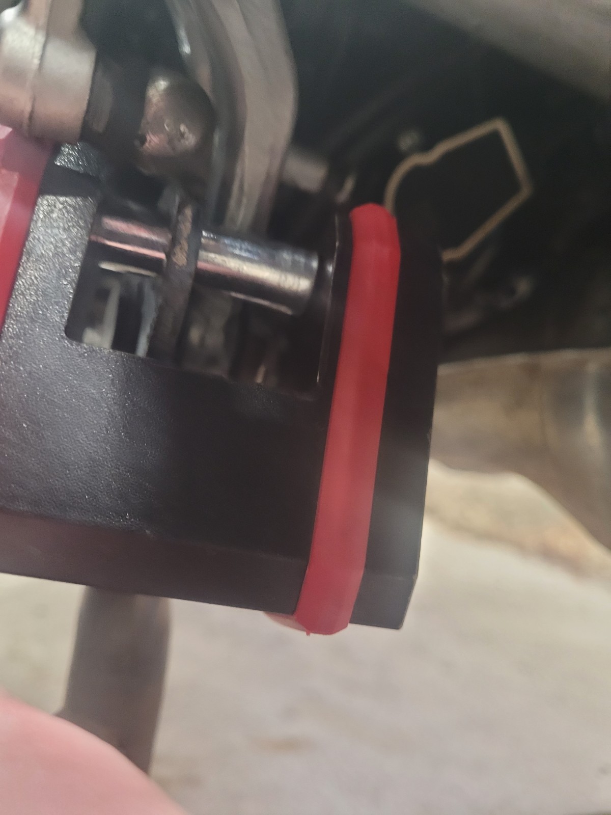

And the lock is impossible to bolt crop and it won't break with a hammer either
Remember its to stop the opportunist thief not someone who would be fully equipped

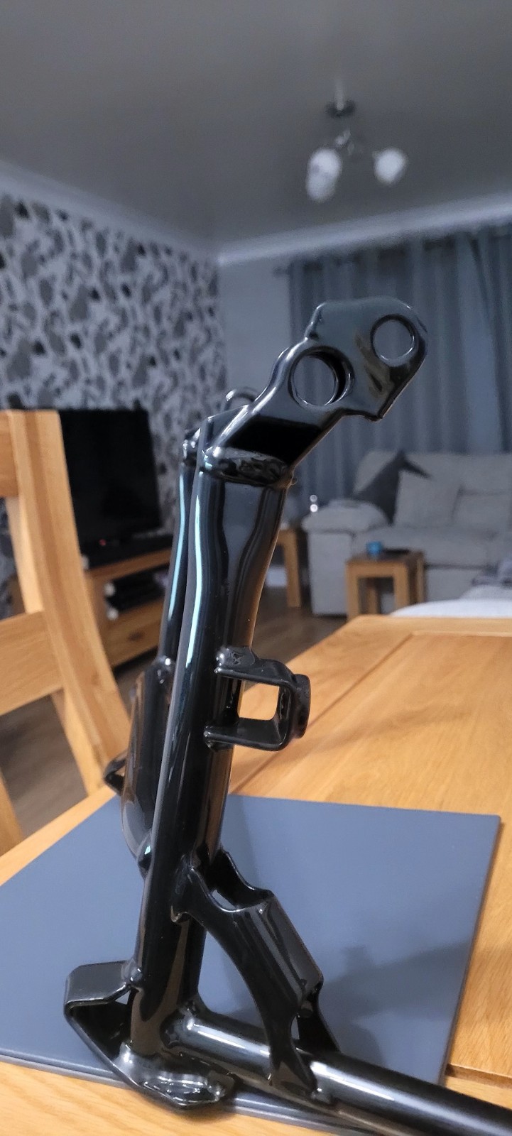

Fresh from the powder coaters 8-)

Just need to refit the springs without damaging the powder coating.
David. wrote: Fri Feb 24, 2023 8:15 pm Just need to refit the springs without damaging the powder coating.
Easy!
:lol:
I still need to make something to stretch the springs to make life easy but its still going to damage it slightly once its fitted and the pressure is on the spring holder
