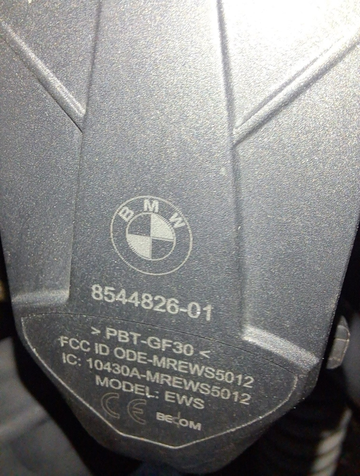

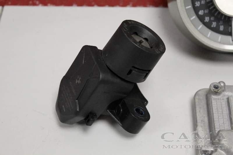

I was about to start drilling the bolts (security) that holds the ignition key switch to the upper tree...
By the way... my 2014 RT doesn't have the keyless ride, mine is the traditional key with alarm... so, does the antena ring still in the same place (behind the instrument cluster) or is mine integrated with the ignition switch? Basically mine doesnt have the keyless button, it has regular key instead and it has a lil module attached to the ignition... and i dont see the regular ring antenna like i see on previews RTs...
I'm so grateful this forum exist!

Re: Yellow Key displayed on instrument cluster - EWS - Bike Wont Crank
Ah!Tche_Gradiente wrote: Sun Feb 26, 2023 9:19 am You guys are amazing! i've been digging the whole internet for days and couldn't find anything related to the 2014 one only the old antenna ring from 2000 Rts. Thank you so much for the insight!
Good point about the keyless ride! that could change things and @David. could be right and that its in the ignition switch
Before you start drilling you could remove the cover above the clocks that houses the sat nav and you can see if you have the antenna ring on the back of the clocks

i will definitely check that tomorrow... i have the suspicious that mine is integrated with the ignition... Thanks again!
