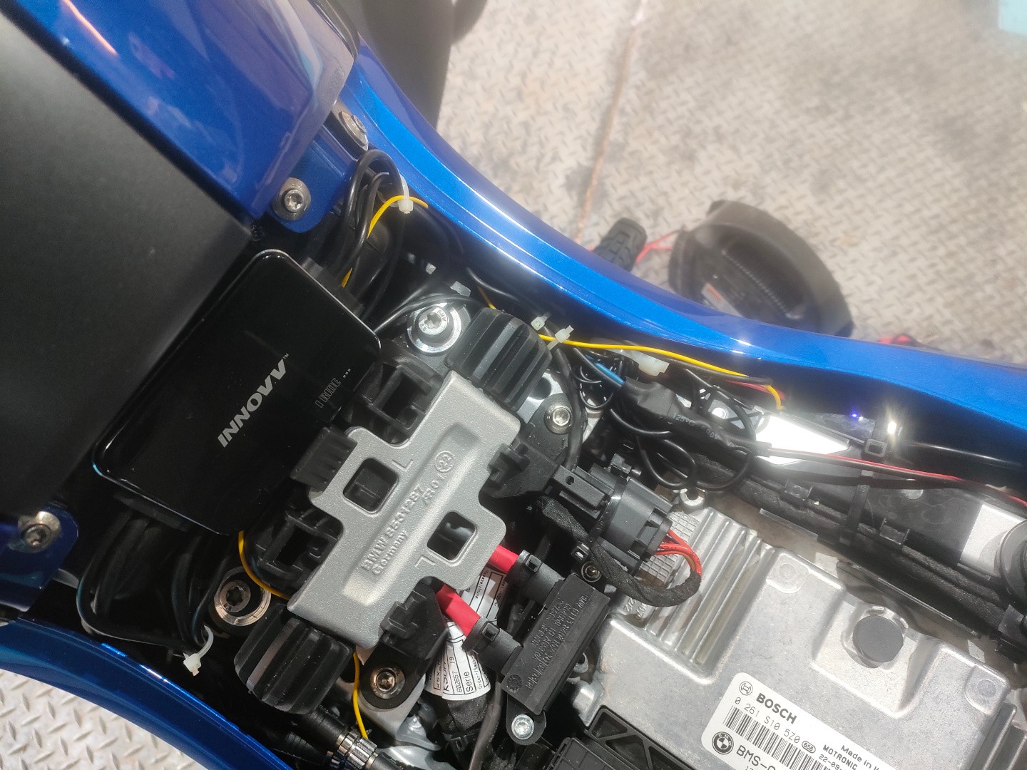

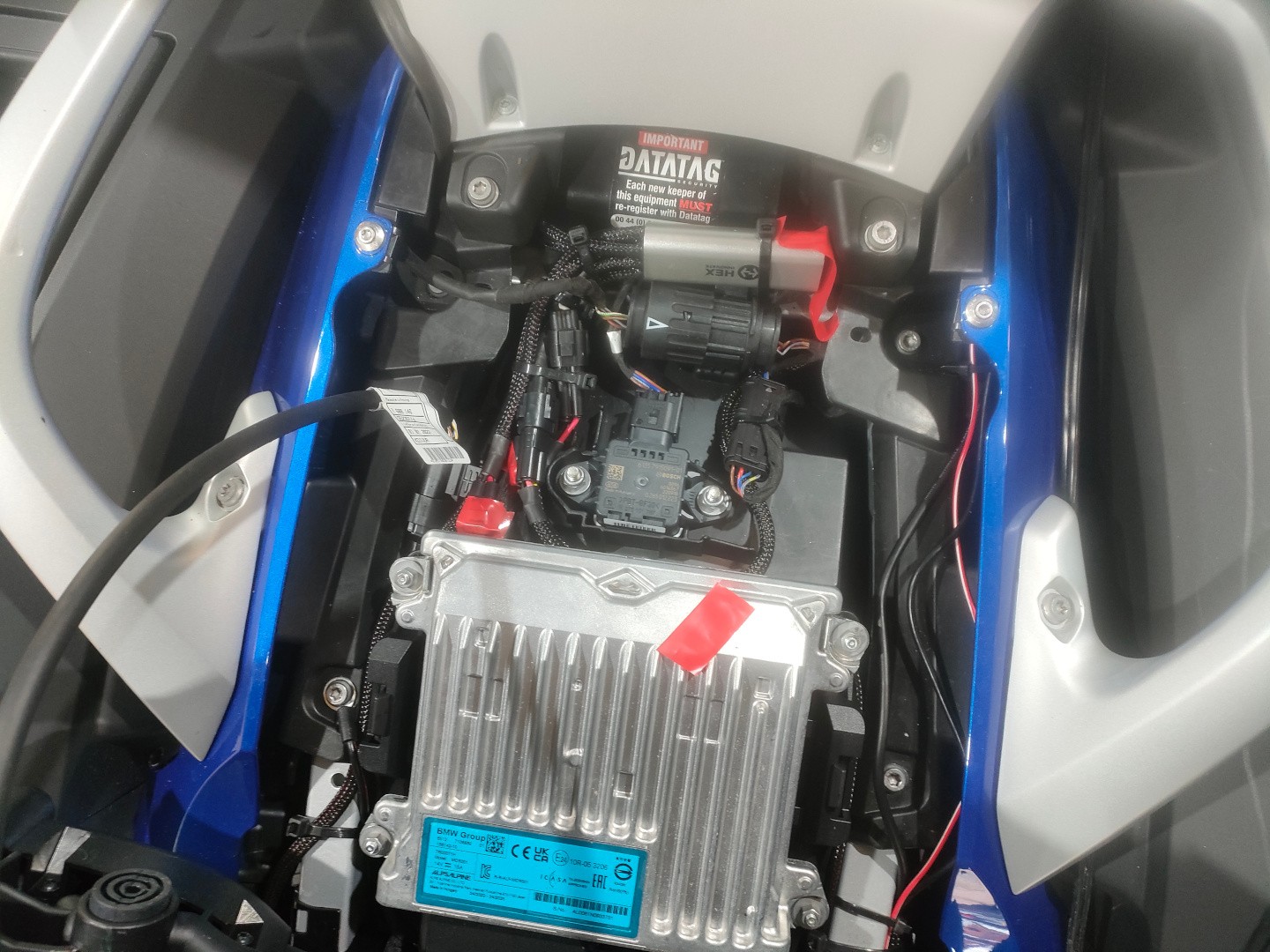

Thought I would share how I have fixed my Hexcan and Innovv Camera on my new 1250
The hexcan is under the tail of the pillion seat. the supplied positive and negative are just about long enough to reach the battery terminal on the right hand side of the bike and used the redundant TPM connector under the rack and advised by innovv to connect to the canbus
The Innovv I had wired up before getting the hexcan so the switched supply for that taps into the rear aux socket again the main power is from the battery terminals on the right of the bike. The VR unit is between the tank and the rider seat secured with 3M dual lock tape
innovv recorder.jpg (375.39 KiB) Viewed 4694 times

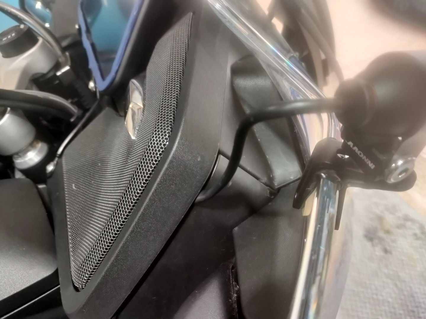

Front camera is secured on the right hand clear wind deflector ( UK so off side) using 2 x L pieces from the fittings kit to clamp to the plastic along with a DIY silicon stick in button cut in half just to add some stability and security
front camera.jpg (282.66 KiB) Viewed 4694 times

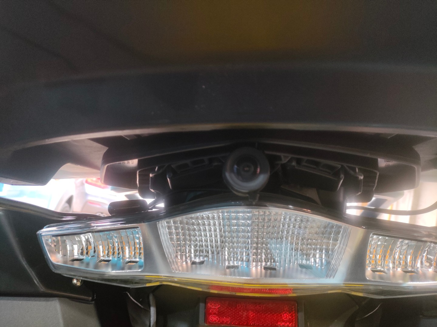

Rear camera again some dual lock and for extra safety zip ties under the rear of the rack.
rear camera.jpg (323.65 KiB) Viewed 4694 times

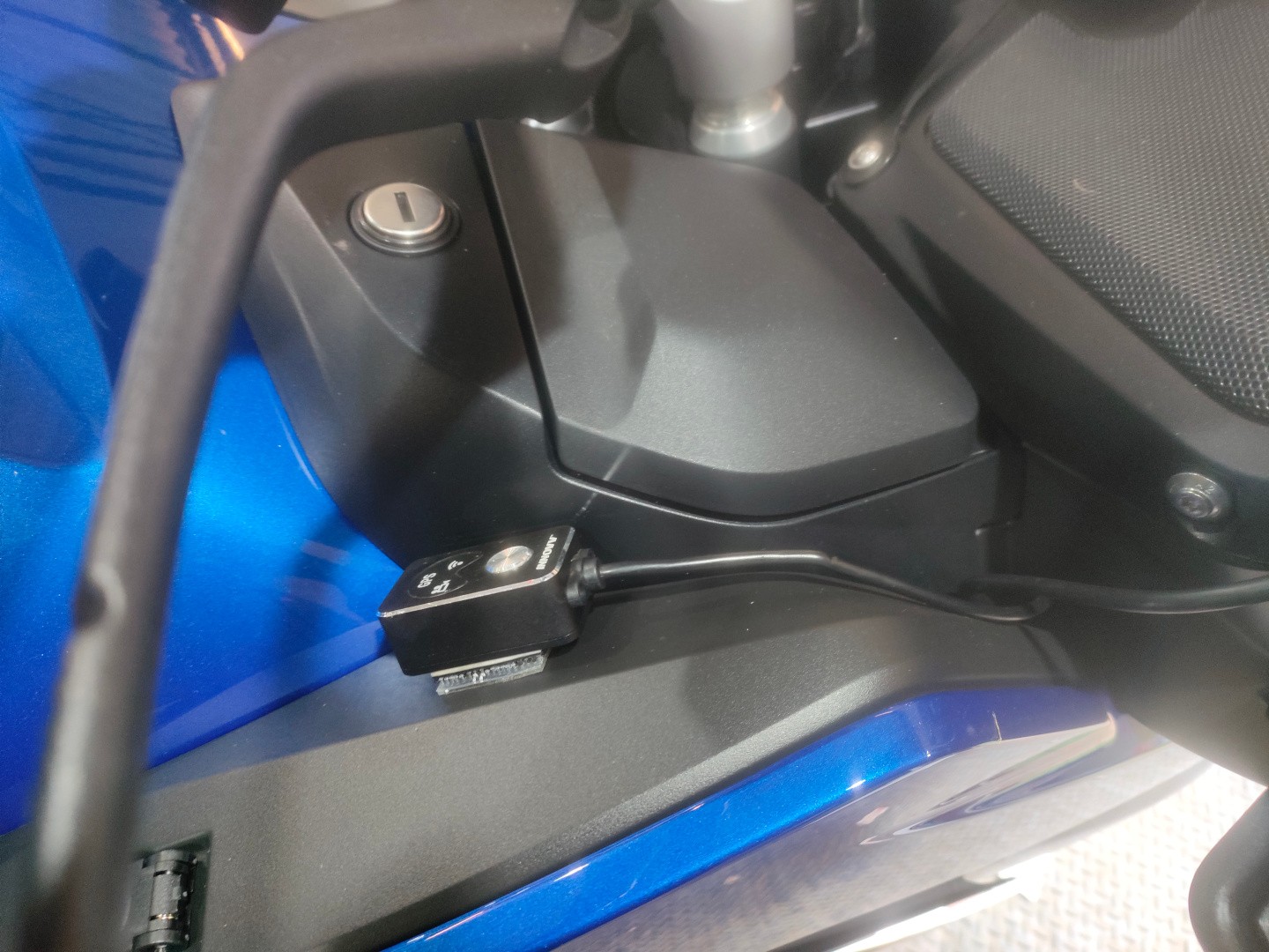

The remote is on the right hand infill panel again with dual lock

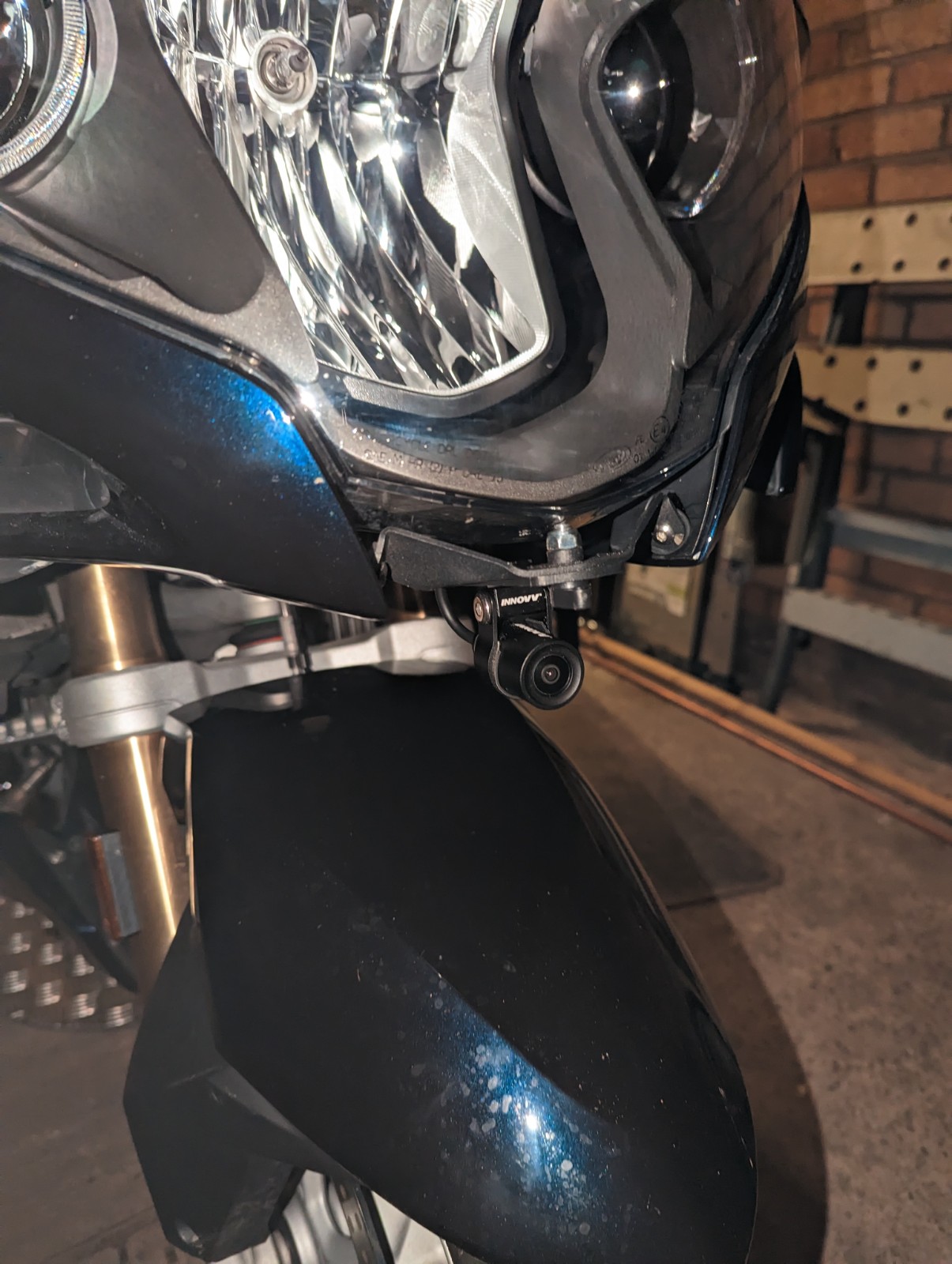

I have my front camera mounted under the headlight

I also have mine under the headlamp using the go pro bracket. Not sure if that fits 21 on bikes though.
