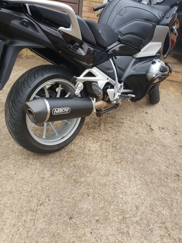

sakm wrote: Mon Feb 20, 2023 8:42 am I have a set and they are well worth the money :thumb:
Nice!, how did you find the fit ?.
Did you try polishing them to a mirror finish ?.
How do you find performance, no loss of power ?.
Thanks :)

They fit Pretty well little bit of jiggling to get them bang on though. Top tip dry fit them first and then put a small mark on the joins then take them off and put the gungum on
They are currently off in the process of being sanded and polished up
I couldn't tell a difference in performance to be honest with you or loss in power. I also had/have a straight through exhaust but I have removed that as its just too loud! Wife complains on longer rides and it makes you twist the throttle a lot :lol:
I will be putting them back on when polished up with the stock can then taking the bike for a remap at some point this year anyway

Thanks :lol: , I wonder if you could as you say dry fit them, mark all the joints then have those joints welded up so it’s in effect a one piece unit as per the original ?.
I’ve been looking for a cheap end can which actually looks nice just for some fun but there’s very little out there. :?

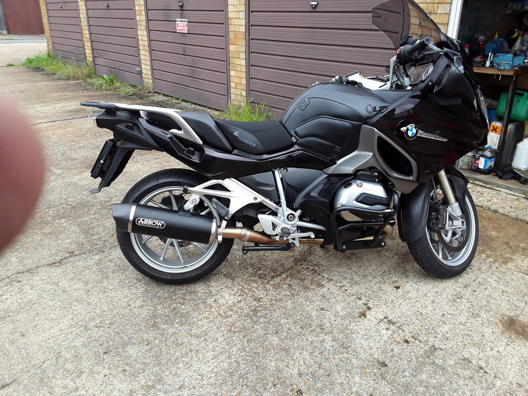

I don't see why you couldn't have it welded up but you would need to make sure its absolutely spot on!
I got a Beowulf for mine

sakm wrote: Mon Feb 20, 2023 10:39 pm I don't see why you couldn't have it welded up but you would need to make sure its absolutely spot on!
Looks good!, were you able to use the oem link pipe cover plate with the Beowulf ?.

Panman40 wrote: Tue Feb 21, 2023 6:43 am Looks good!, were you able to use the oem link pipe cover plate with the Beowulf ?.
No it comes with its own
But you can use it on the black widow pipes with stock exhaust

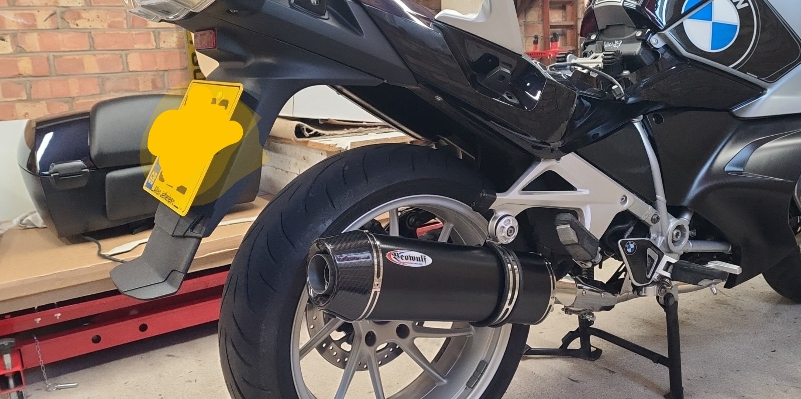

I’m still looking for a cheap can, I. Ishtar buy a stainless delkevics right oval and have a local guy who builds custom bikes knock up a link pipe…
