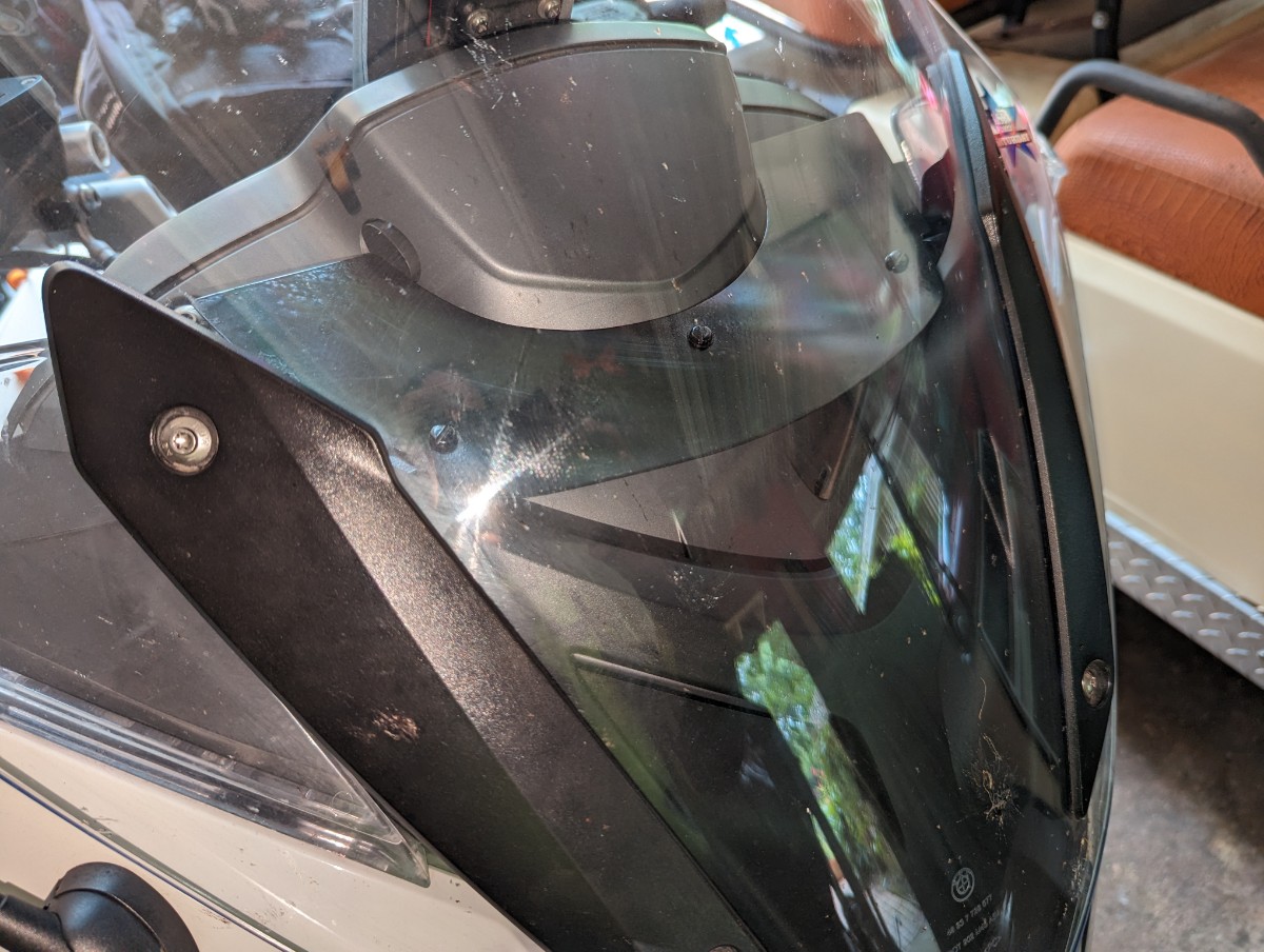

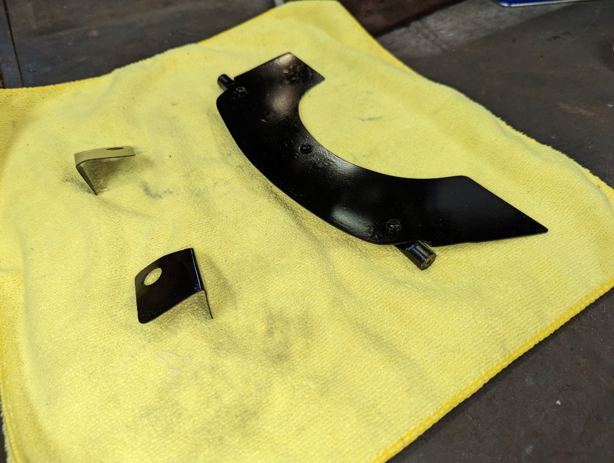

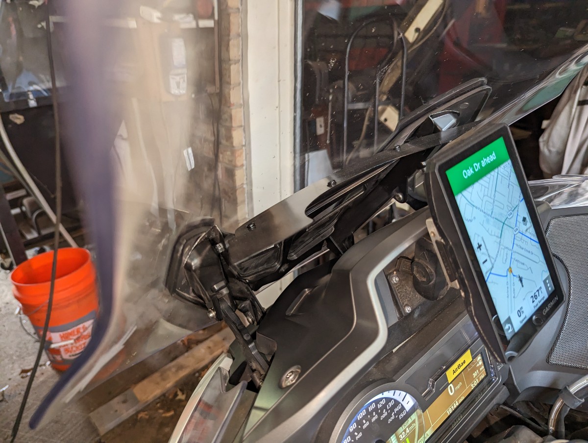

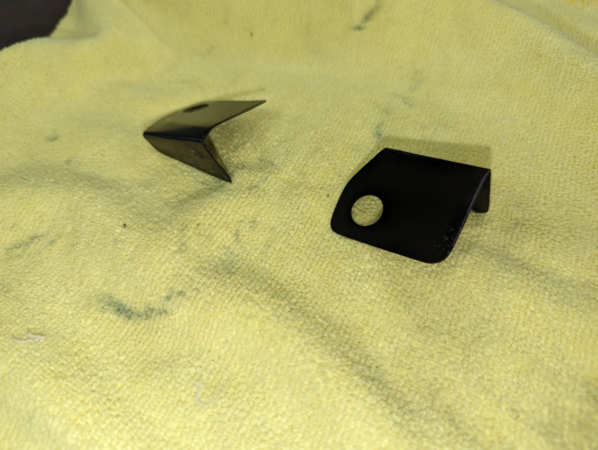

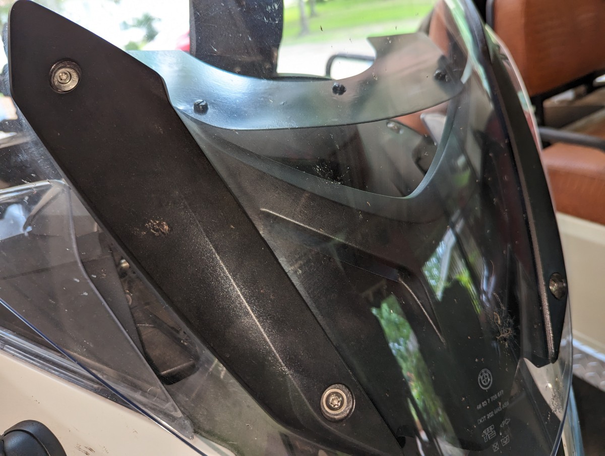

The RT has a great fairing and windshield system that keeps the wind off the rider. In Texas in the summer it's a big negative. After taking a closer look at the system I came up with a modification that puts a little more air on the rider. It is just a bit of sheet metal that directs the air to my chest, rather than sending it over my head. As you raise the windshield the vent opens up. My ride is significantly cooler now 😁
