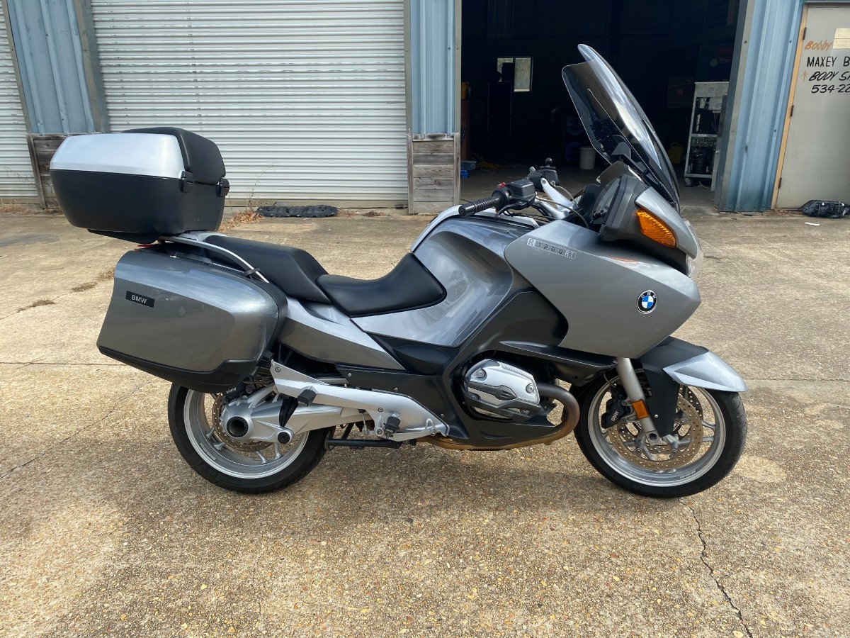

I introduced myself on the newbie page a while back and I can now officially say that I am a new owner of a 2005 R1200RT. It was in just as good a shape as I was expecting it to be in when I saw it. After a 4.5hr drive to get it I would've been awfully disappointed if it wasn't. It had new plugs, oil/filter, fuel pump/filter and metal disconnects done before I got it. I am going to change the FD oil, transmission fluid, and it looks like I have a fork seals leaking a little so I'll take care of those to. I have done a lot of homework and research but I keep finding conflicting answers so I'm going to ask the dreaded newbie questions.
1.) Side panniers - How much effort should it take to lift the handle to open them? They pop up pretty easy with key button but the handle seems pretty stiff lifting it up. Normal? Is there was way to service them at all and maybe lube something?
2.) Transmission oil - 75w90 or 75w140? I live in Northern Arkansas.
3.) FD oil - 75w90 correct? I keep reading about 75w140 in FD but a lot of people seem against it. Side note: Has anyone ever tried to retrofit a drain plug on it? Or is that even possible?
I think that's all for now. Thanks in advance.
