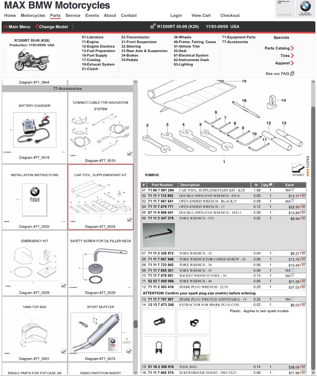

Most BMW dealers can order you another key if you provide registration or title and ID. I think the plastic backup key is about $85 and a real key is around $120.
That looks pretty similar to the tools I got with my ‘05 when I picked it up a couple of months ago. Judging by the second wrench from the right, you probably have an optional/aftermarket oil filler cap, a five point security torx (the plastic wrench at the far right is for the OE filler cap). Beyond that and some torx bits, I can’t think of anything special.
Here’s a breakdown of the supplemental kit from https://shop.maxbmw.com/fiche/DiagramsM ... d=09082020
